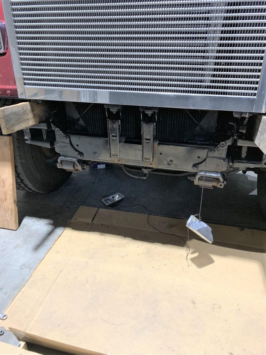

To convert system is replacing the condenser coil in the grill, expansion valve, pump, high pressure switch, dryer and higher pressure lines. Use the same evaporator coil and everything else. I had the Grilldenser used in the 88 Superliners and switched to the 94-96 CL700, R134 condenser which fit perfectly under the air to air engine intercooler, smaller and works better. I used the original Grilldenser the first time with R134 pump and other parts, it worked but not well and seized up the pump after a year. This time I installed the new condenser coil, used the A/C this past week and could not keep it on high fan for long, it is cold! If you need part number I have the invoices, let me know. Whole thing with parts and R134 charge was around $1100. The name of the place is APPAK not appax. Phone: 602-254-1116. Great customer service. -

I just went through the A/C in a 1988 RW and converted the R-12 system to R-134. APPEX in Phoenix was a big help with all the parts and had most in stock. You will have the old R-12 if not converted already. -

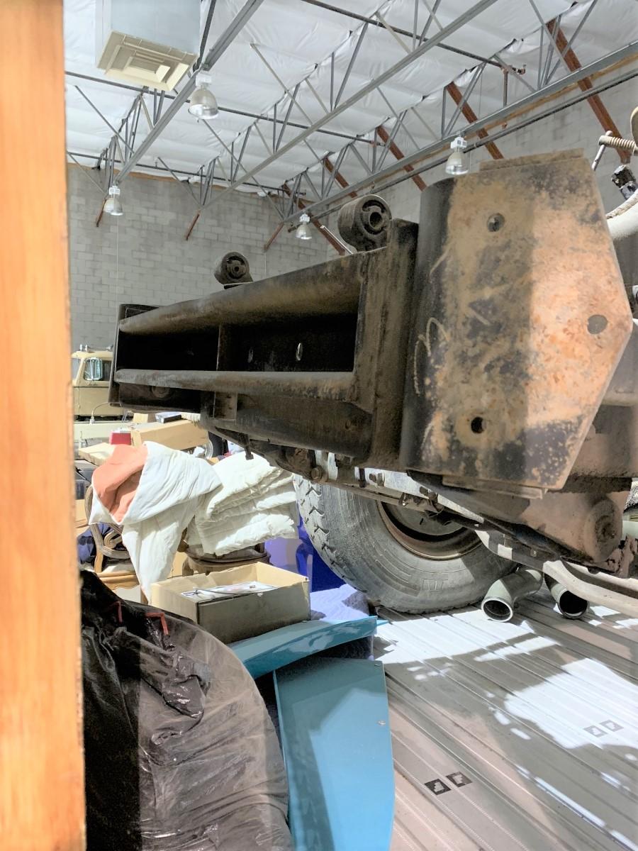

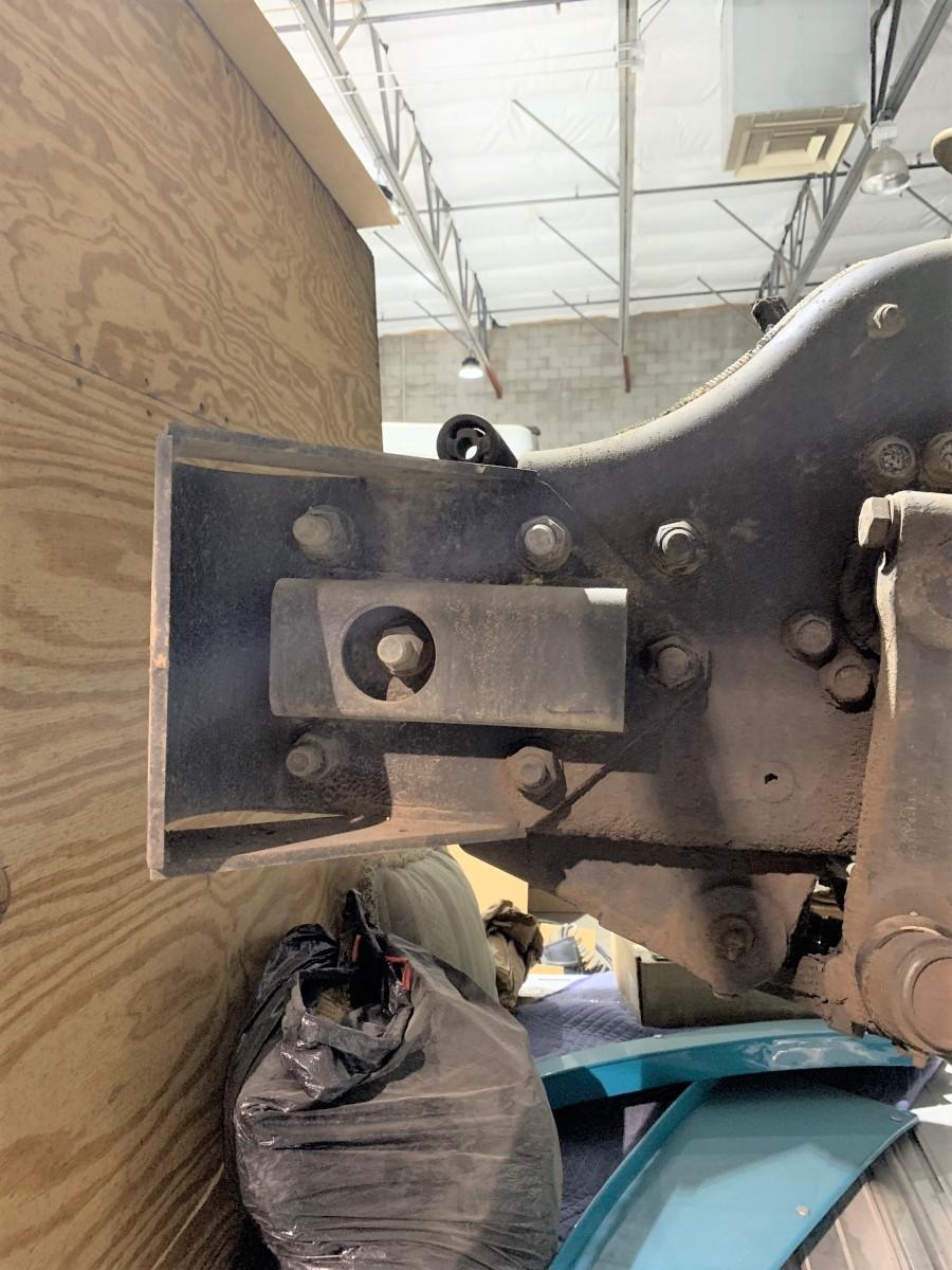

Sounds a little strange to be triple framed, 54K rear and have air ride. Definitely a special spec truck if it is. That heavy spec it will be geared low, maybe 60mph max.

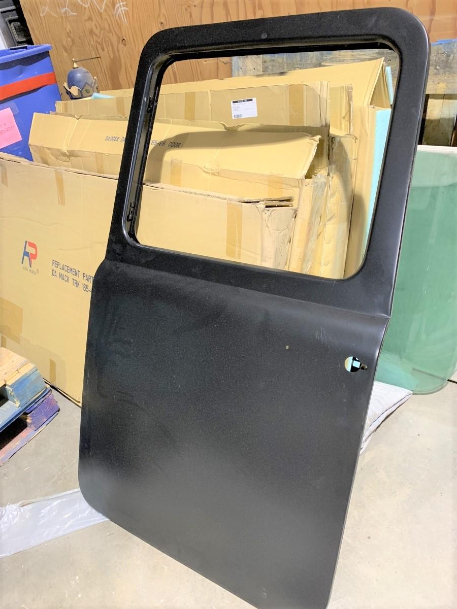

Hi, I have an R Model drivers door shell, new aftermarket same as from Jones supply and others when available. I have used these doors on my truck. This door is damaged, take a close look as it is dented about inline with the handle and right above belt line by handle. It was damaged in shipment to me. It would take an hour or two to get it right but usable as is, no rust just dented. Good for a work truck and has work truck price $150 plus shipping.
