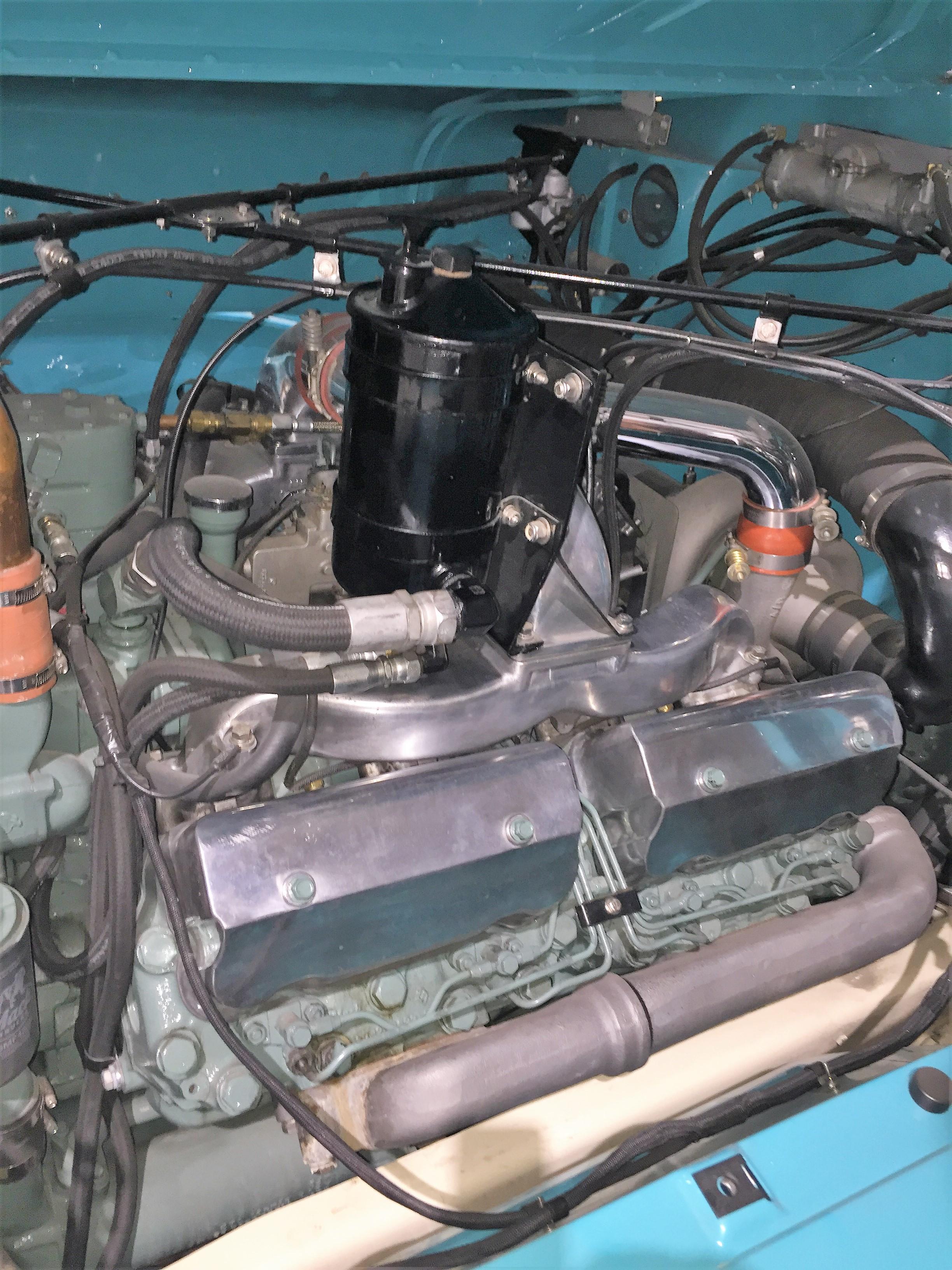

I know Kevin All and a little on the steering box. When I was looking, some 15 years ago, to do the power steering change over I traded Kevin for some parts and knowledge. The box mounts in the same location as the original, have to drill frame for different mounting bolts. I got a power steering box from him to work with a 6cyl. engine, I have a V8 and this convention will not work for a V8, just no room. Besides mounting the new box the lower end of the steering column shaft need to be cut and a universal joint keyed to the shaft. A short splined shaft mounts on the box and mates with universal joint. Supply and return hydraulic lines need to be run to a pump and reservoir. I still think I have the power steering box from Kevin if anyone is interested. $200 plus the shipping. I'll go look for it if someone is interested. PM me. -

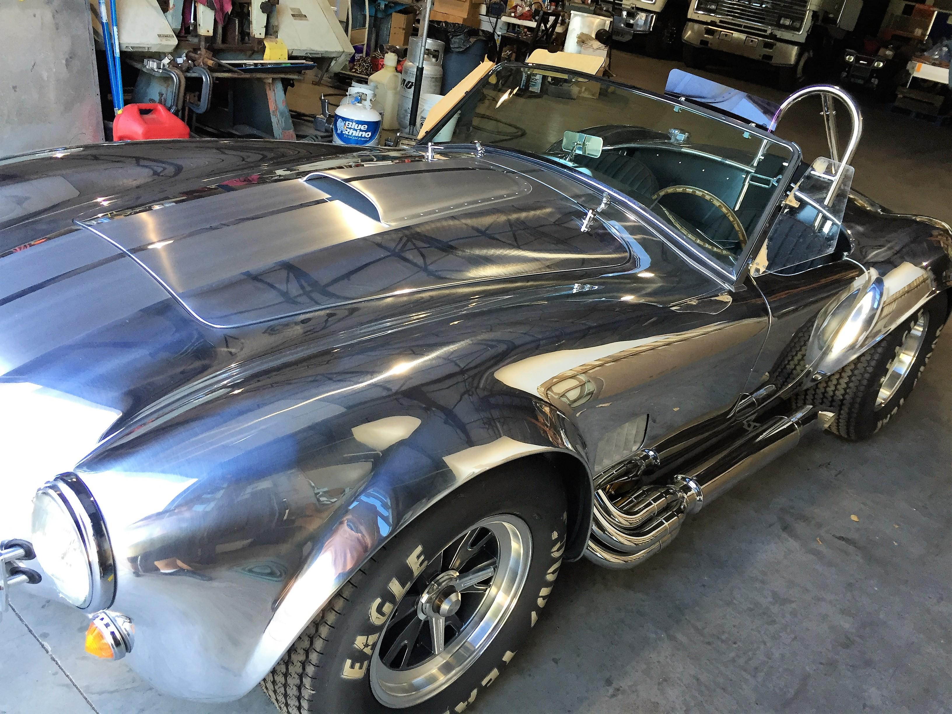

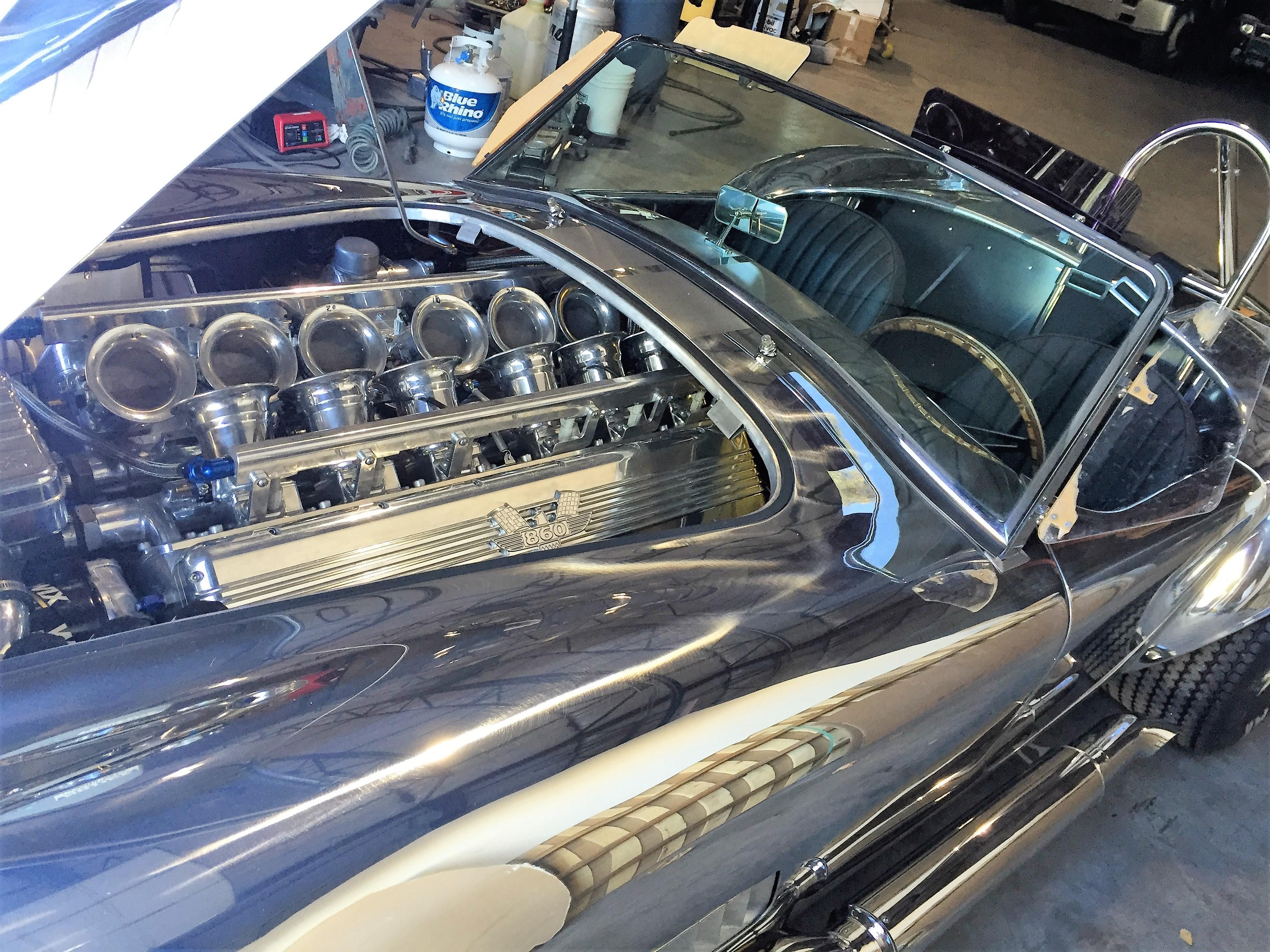

The Cobra body is polished aluminum with brushed strips. Same material as the original ones built in the 60's. Kirkham Motorsports in Utah has the bodies and frames roughed built in Poland. They then finish the rest here in the USA the customer has to supply the engine. Copper and Bronze bodies are options but way more money and 400lbs plus heavier. This car is a little over weight with that engine at 2600lbs. Fuel adds 270 more plus me. It ends up about 3lbs per HP for power to weight ratio.
No damp roads here but oil at intersections is a big issue. If it rains it is like ice starting and STOPPING. Yes, a Cobra can get out of hand in a split second, that is what makes them fun and a hand full in any configuration. Not for the faint of heart to be behind the wheel. Have had people (women) screaming from first gear on and getting out with a smile on their faces and shaking, no wet seat yet but said close! That was after having them strapped in with a racing harness. This all under 75MPH and in third gear of course.
RR has alway been Adequate in every way, maybe some day I'll drive one, maybe never own one. No.... HP Rated "Just About Enough" and detuned at that, down to about 1000HP at the crank. There are but VERY few places to crack it open due to street conditions, like the boys in blue, without drawing BIG attention. I got a CDL to worry about too. License Plate reads "Venomis" Misspelled but we only have 7 digits to work with in AZ. Funny but no one can USE that kind of HP in the car or truck that was 1000HP at crank or to the wheels. BUT it is nice to know that it is there if ever needed.... 👍

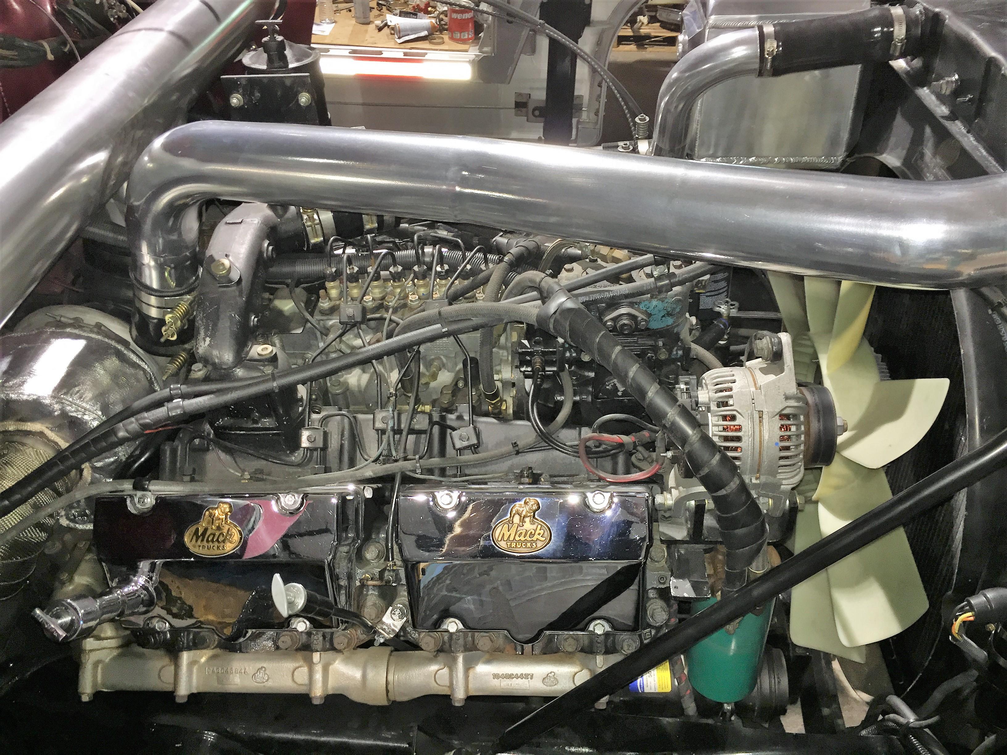

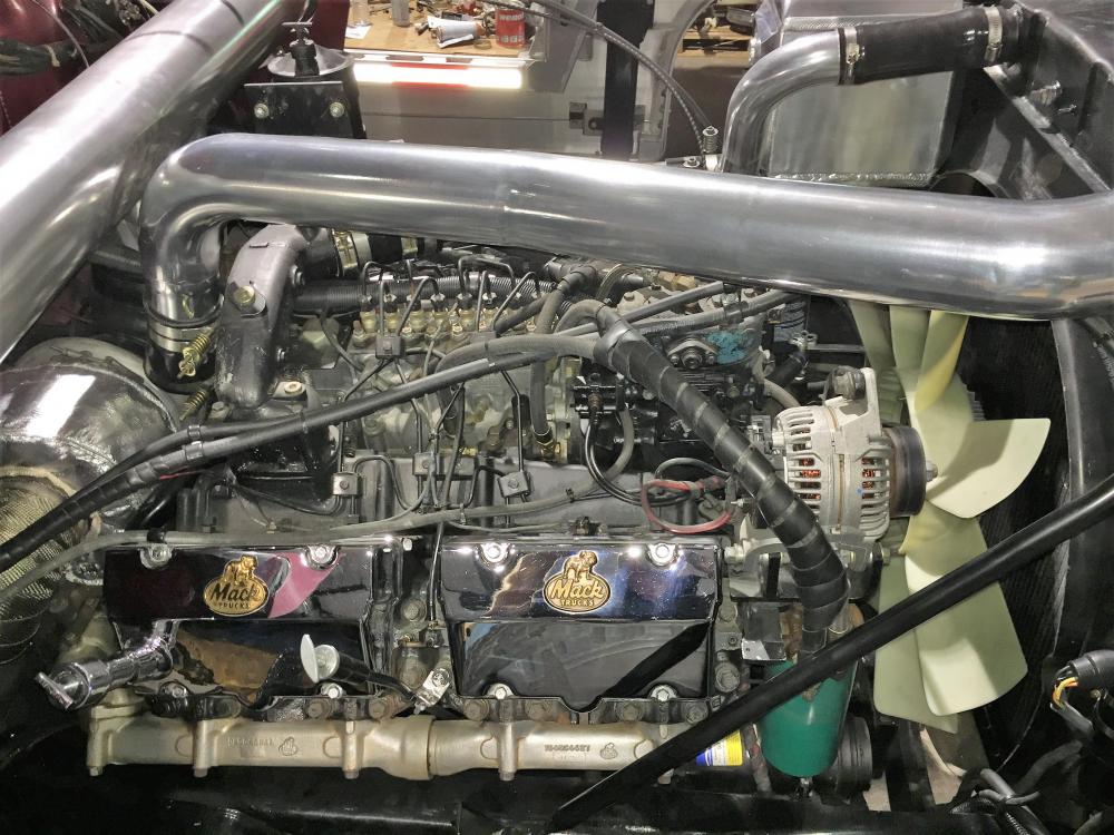

Not a stock 500. This was a sled puller from Wisconsin back about ten years ago known as Thunderdog. The modes were done by Steve Trevetz the V8 Mack Engineer and the inline pump and injector work was at Antrum Diesel. Was wheel Dyno'd in Wisconsin once all together. Dyno quit reading at 1158hp with more to go. Ya, 1200hp was an understatement. I have a smaller turbo, still makes 65psi but at lower RPM's, on it now as it just would not pull a trailer and always "under the turbo" at cruise speed. The silver box in the top right corner is an added Liquid to air inter-cooler, after the air to air, that really helps for short periods. Flows 1.25 gallons a second of ice water for about 15 seconds then ice is gone in a 20 gallon tank in back locker. It does need a huge clutch and Rockwell lockers to hook-up!! It is a 93-94 Black CL700 motor with the factory chrome valve covers.

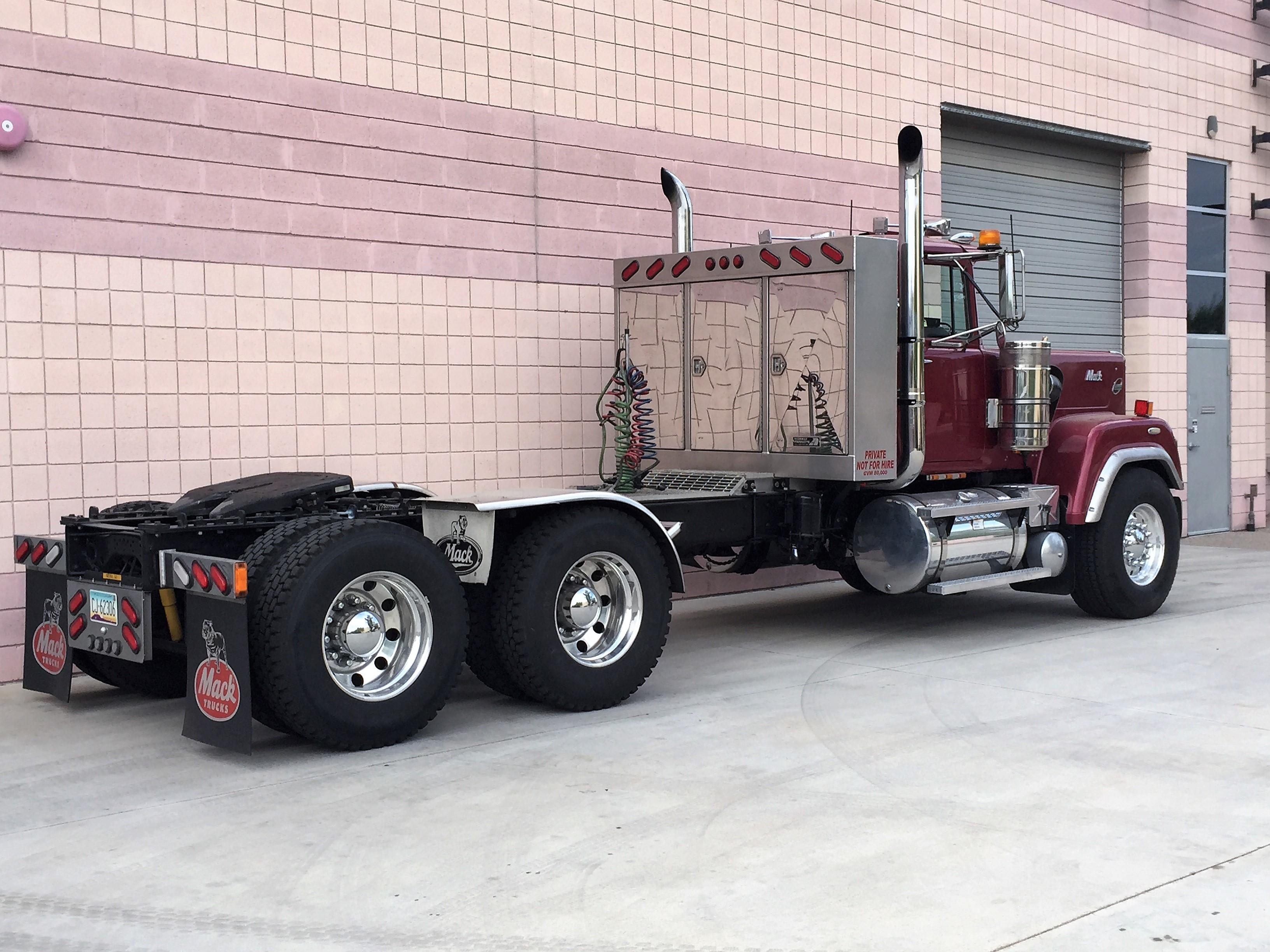

No custom bunk yet but still planned. The Superliner still has the custom aluminum and stainless locker on it. I got sidetracked for a few years, on my Cobra project. Think I need it more than a bunk, not ready to lay down a lot just yet. This is the Cobra, Yes that is an all aluminum 860 cu/in V-12 that was used in a boat. Stock 1150hp /1200ft/lbs and gets 3.5MPG just driving normal!! It is detuned to actually drive it on the street. Those tires are vintage correct but are no longer on it and 13" wide road race tires are used for traction.

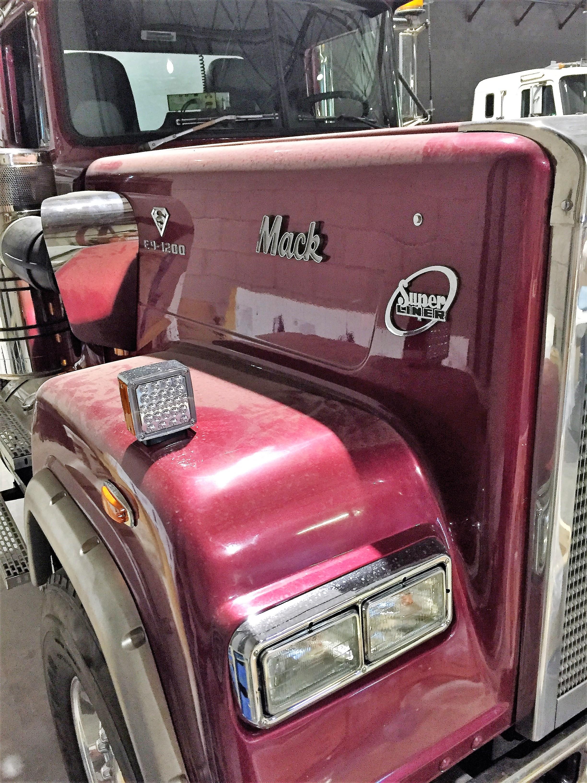

Dirty old hood just sitting around needing a cleaning bad. Waiting for temp to cool down in a month or so, to get out and blow a little smoke, about 110* today.

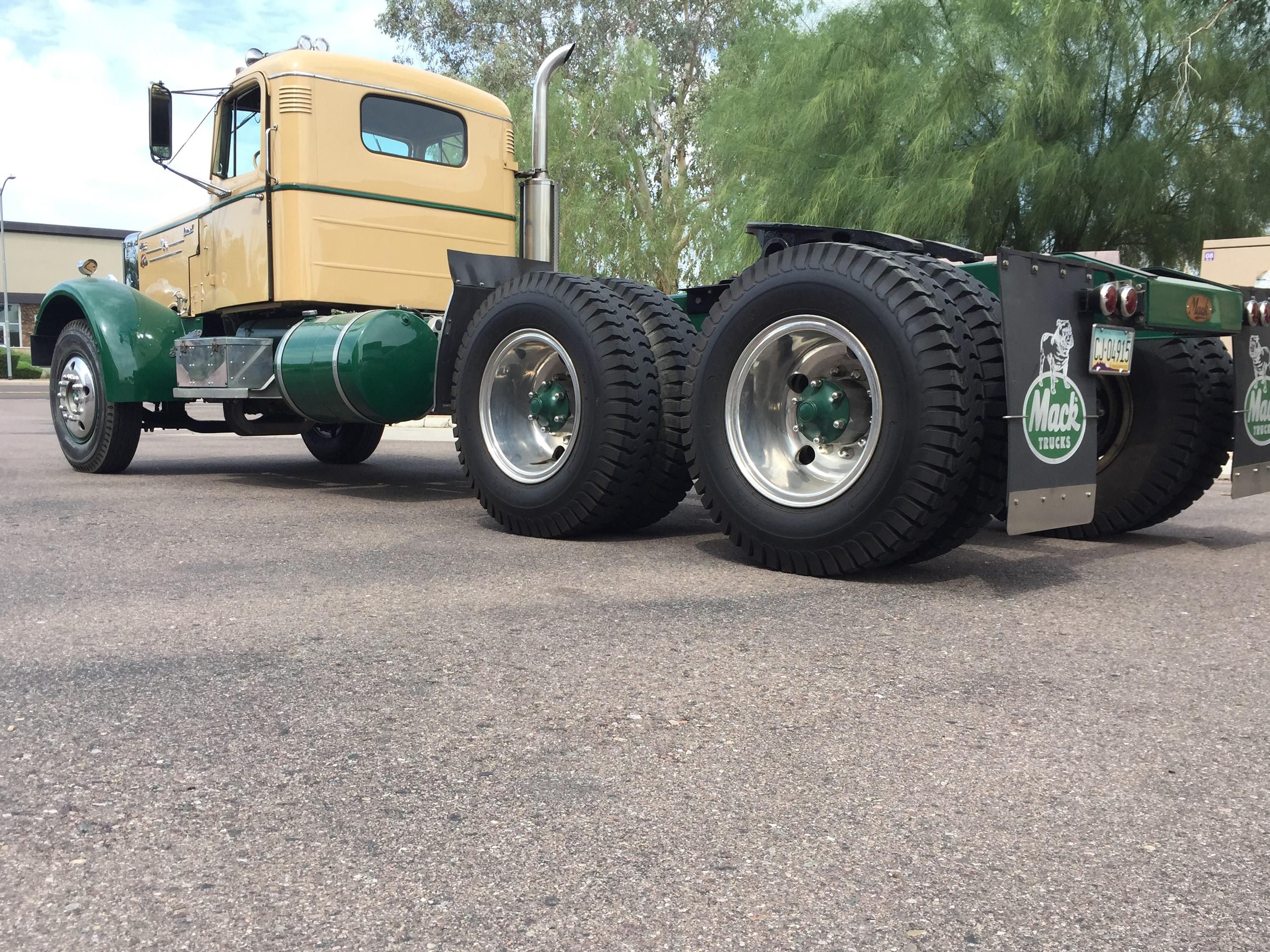

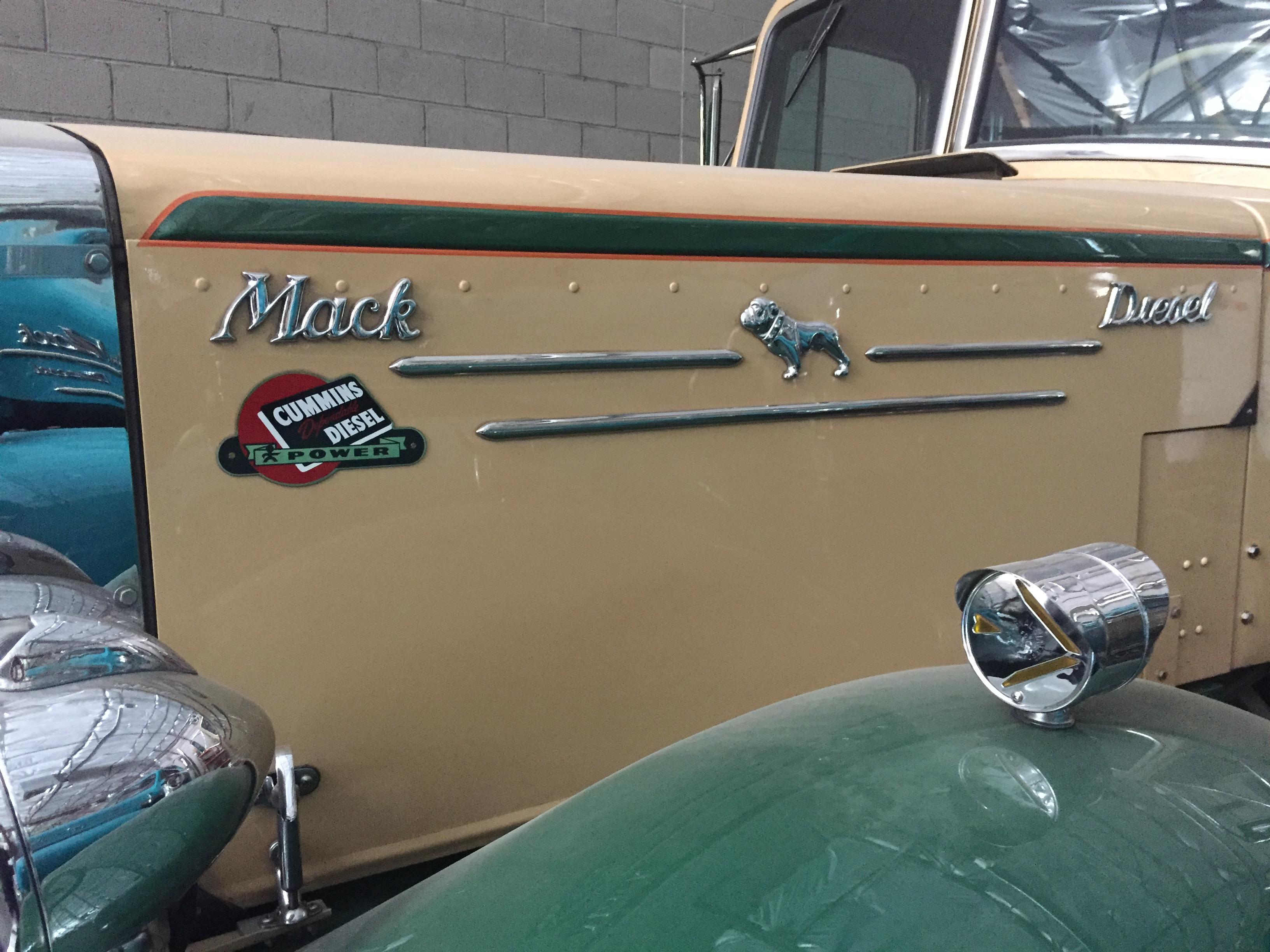

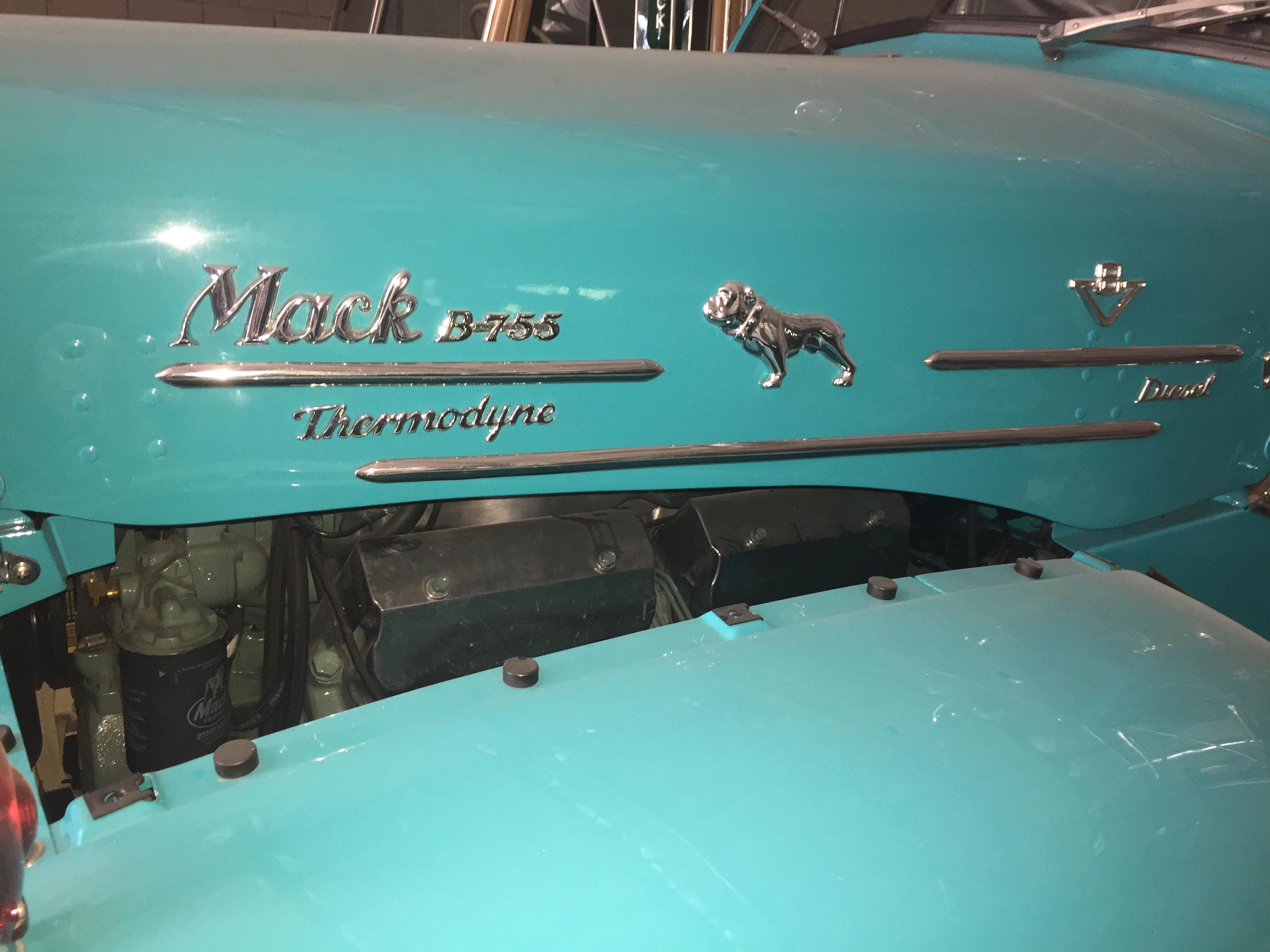

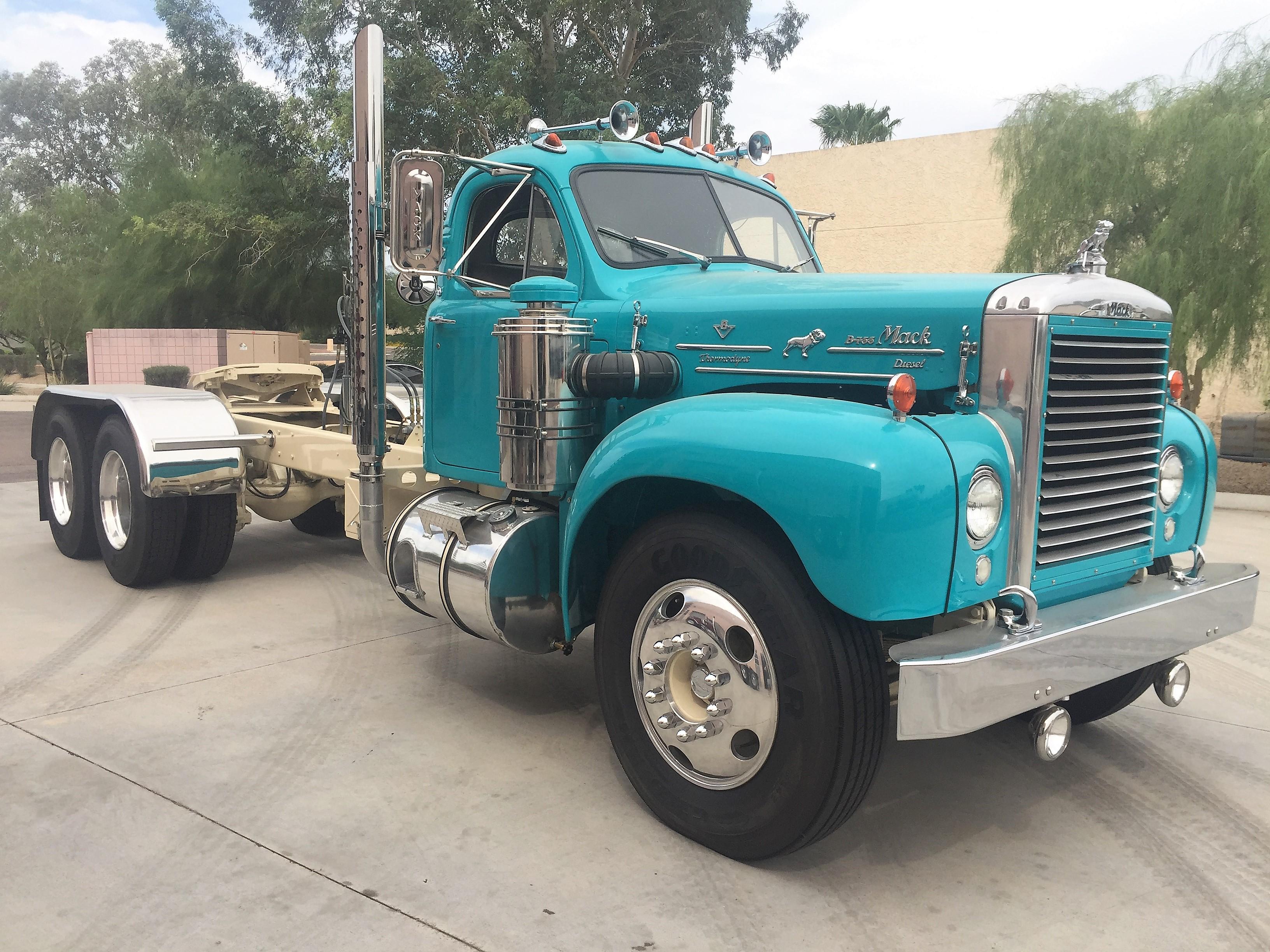

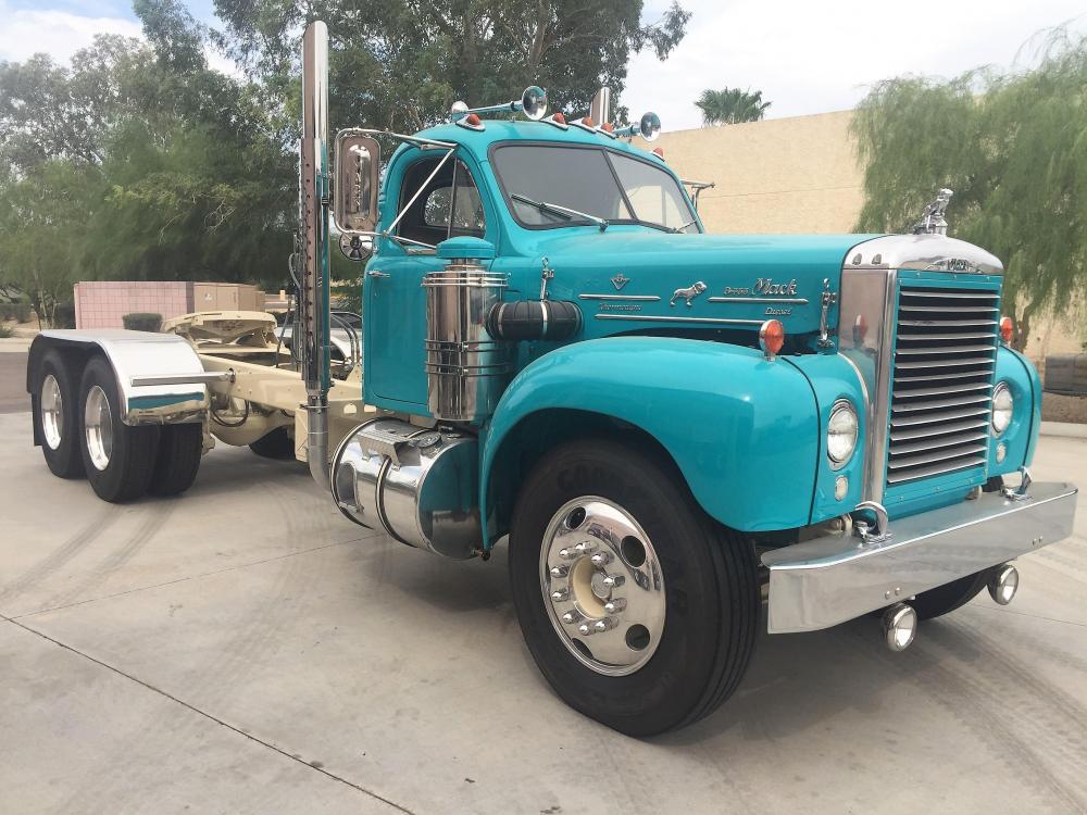

Yes, the B755 emblems as stated above are original. There are B models with 4 digit hood emblems, but very rare. The 3rd digit is an engine designation, turbo, engine manufacture,V8, gas, diesel, etc. The 4th digit in rare occasion is a 6 for a drive axel option, I think. Most models only have a 2 digit emblem but as with my B755 there are the 3 digit emblems. A list of all B model numbers can be found in the back of Mack Model B books by Thomas E. Warth. Thanks to All for liking the trucks, It took a lot of time, parts hunting, money and donor trucks to get them to better than new condition as seen here. 😀

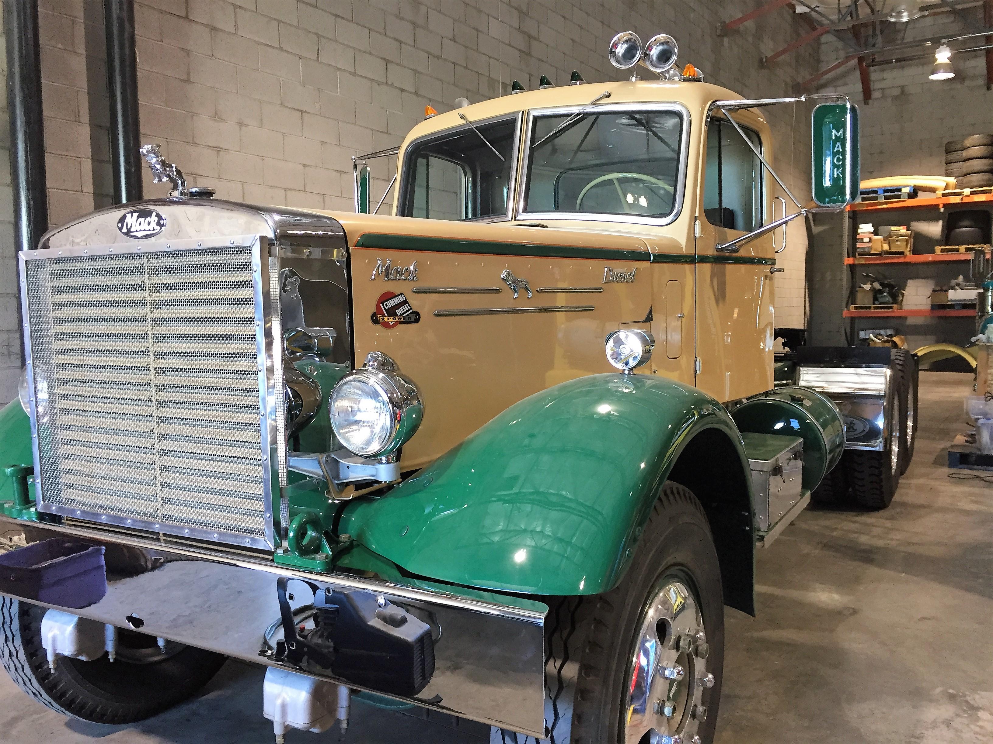

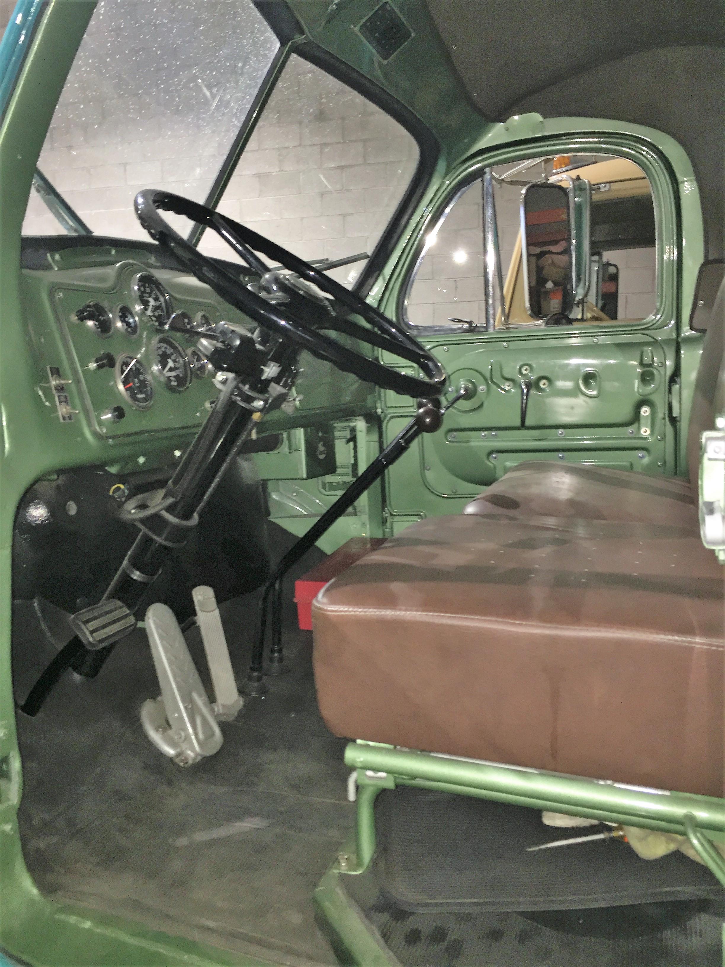

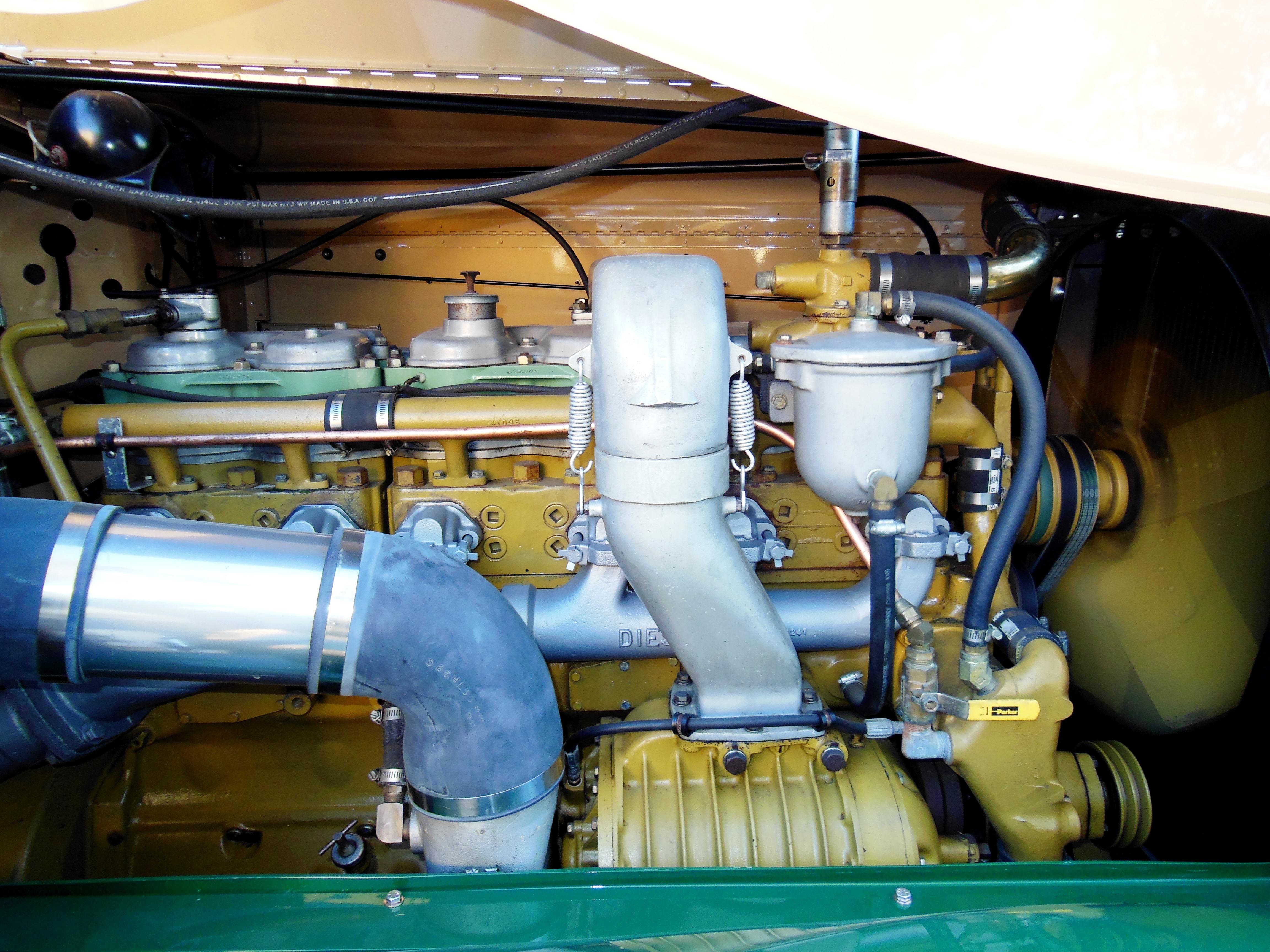

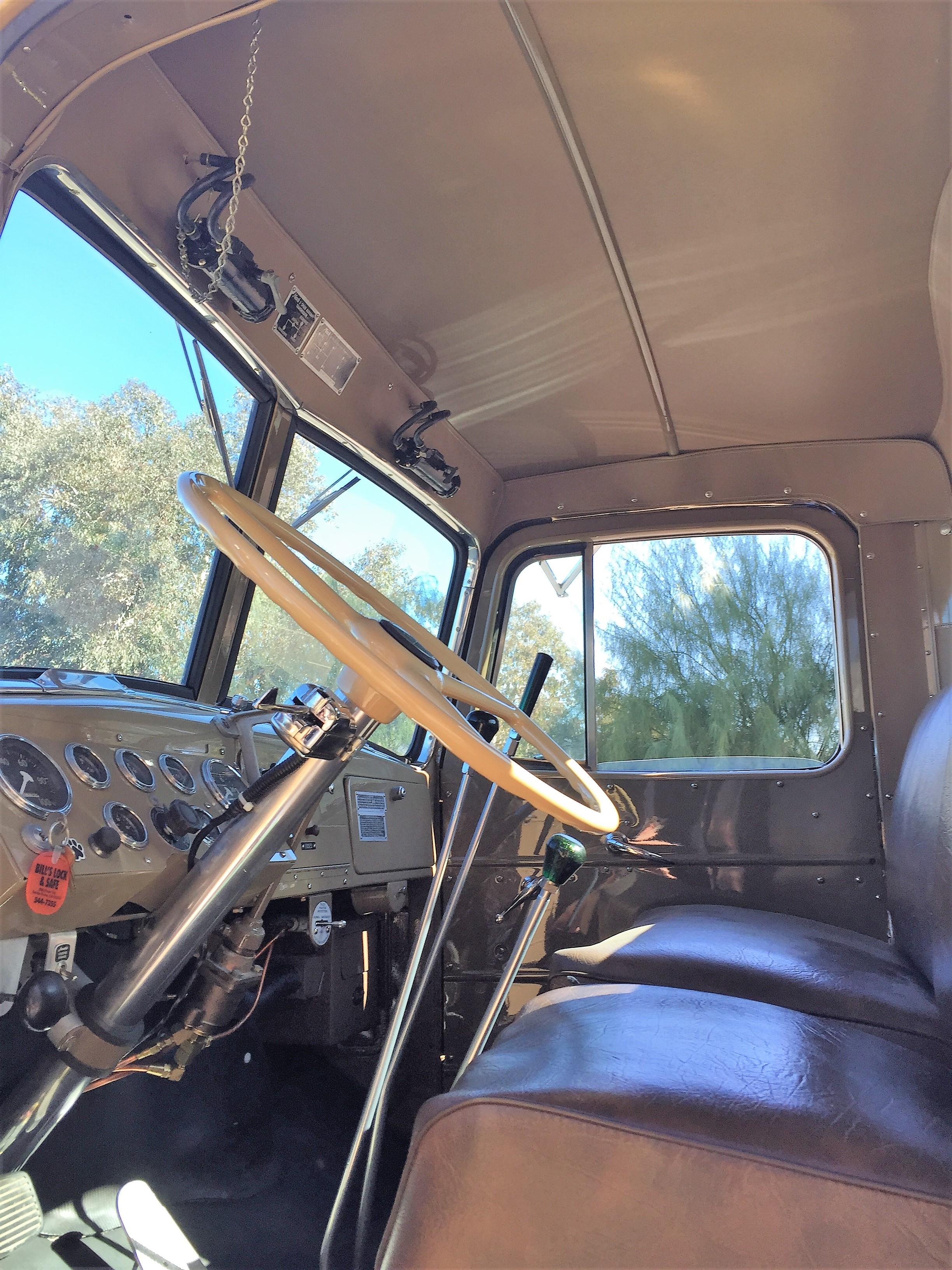

The engine in the LTL is the big brother to a 275 iron lung. A 320 with added piston cooling and tuned up PT pump out of a pan scraper, notice the auxiliary double groove pulley in front of the blower, not normal in a truck. Added the Jake on top in green. If noticed on the interior photo this truck is a 3 stick. Duplex into a 3 speed Brownie, no shortage of gears here. It will cruise at 2100rpm@65mph even with the optional high speed 5.77 ratio rears as spec for 1953. Tops out at 72mph. Yes it sounds like a 275 but after 1500 RPM's, great burpie idle too. A little smoother cam than a 275 but more power.

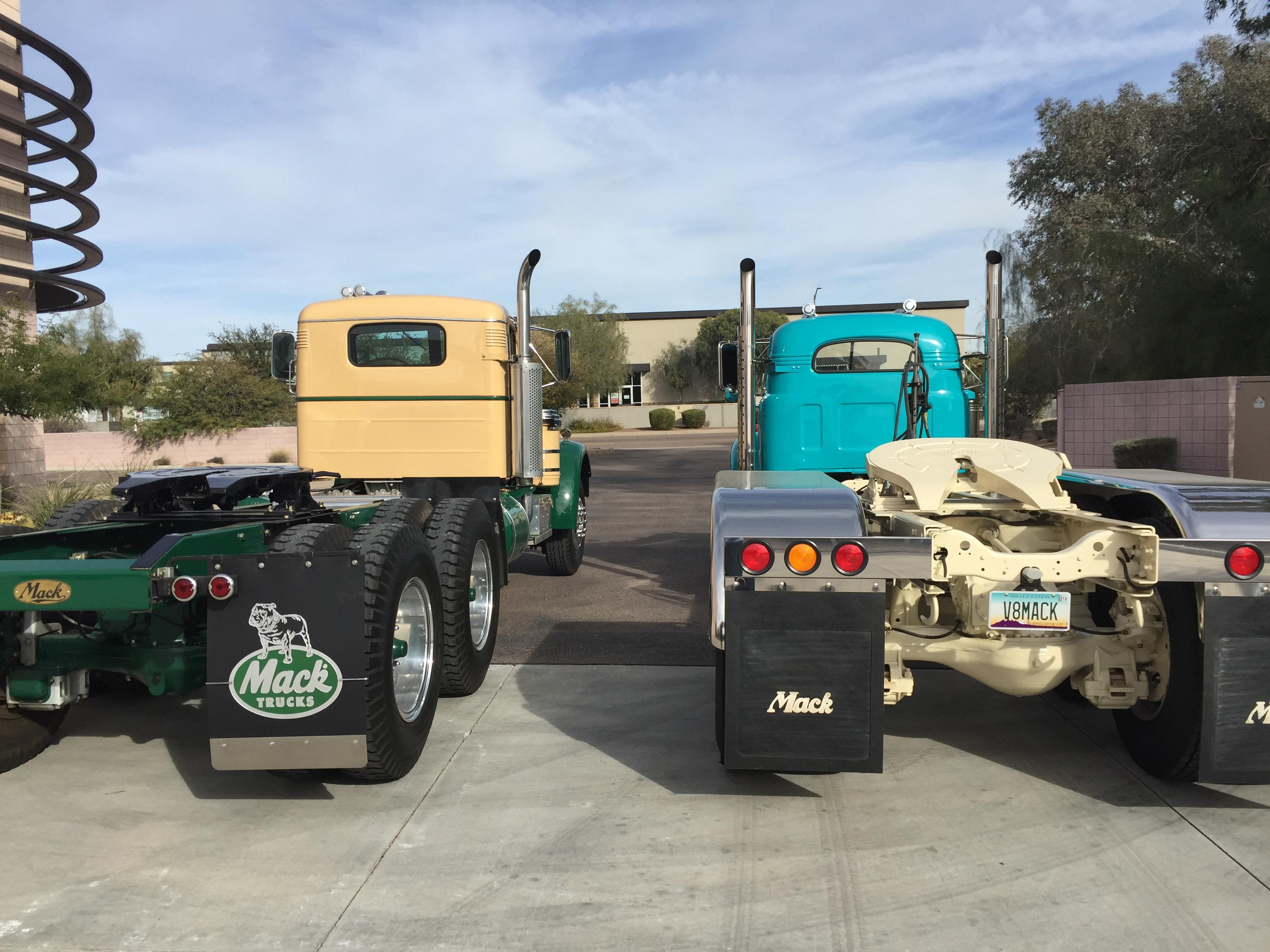

These hoods haven't been out in the daylight for a while. Just getting a thicker layer of dessert dust, maybe have them out this fall.
