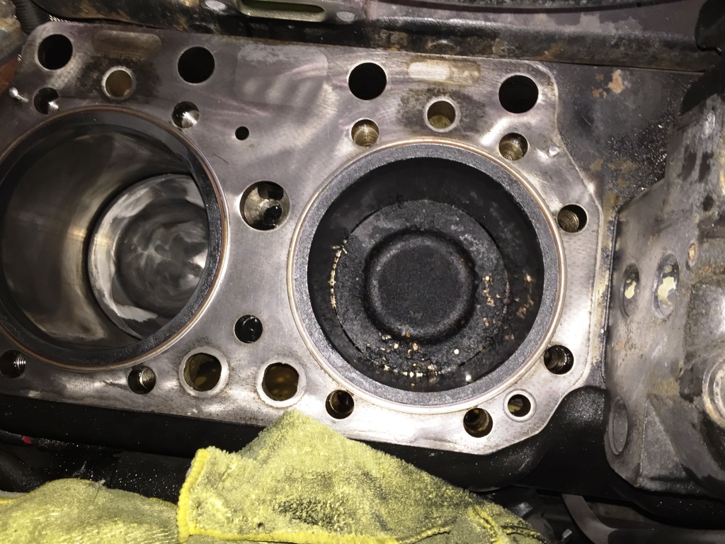

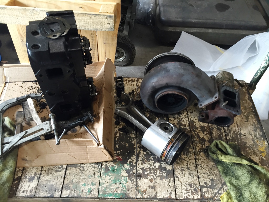

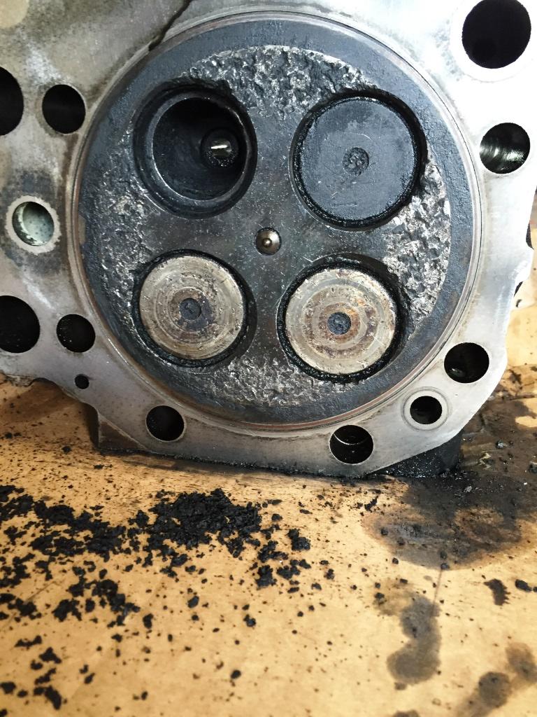

Got the engine taken down today. One of the exhaust seats came apart and chewed up the piston, liner, head and turbo. Think the head is actually repairable but piston, liner and turbo are toast. I was going to change out the turbo anyway after this trip, it was just too big to run on the road with a trailer. Have to cut her back on the Horse Power and be more drivable. Turbo did not really start working until 1900rpm. Got a Borg Warner S400-91 to install and should come in around 1400-1500rpm. Yep a lot of water under the tires at 55mph is not a good thing, slowed down to 40 after the Holly Crap moment!!! r
