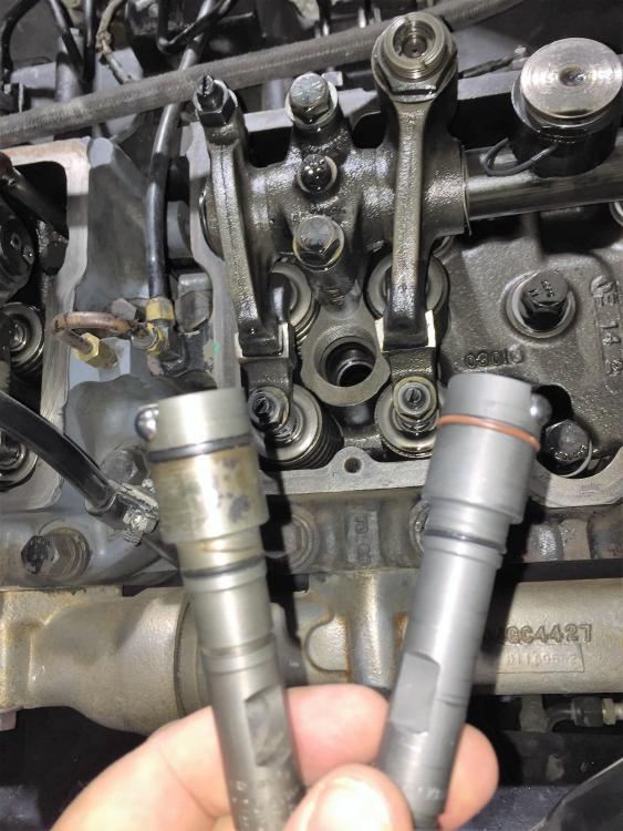

The nozzle is the tip portion of the injector body. All injectors have nozzles it does not matter how makes them. You can not just replace the nozzles on the injector body at your work bench. This must be done at a fuel injection shop to get the proper opening pressure and check for spray pattern with new or used parts. If you get the whole injector with nozzles to replace the ones in your engine that would be a lot of money that you do not need to spend. If you just want new nozzles then tell the shop replace then even if they are not bad. That may take time to get them ordered in. Southwest Injection in Phoenix is who I use and they had my injectors cleaned, pattern checked and opening pressure set, back to me the next day. It can't get any faster than that. If your shop takes a week you might tell then to put a RUSH on on it and pay a little more for the RUSH service. Columbus Diesel is a good shop, in Columbus Ohio that I would recommend, talk to Dan there.
The O-rings are the issue, replace them, it is an EZ fix, get the O-rings from a Bosch injection shop. Take the injectors to a Bosch injection shop and have them cleaned and have the opening pressure checked and brought back to factory spec. The opening pressure does change over time and a different shim under the injector spring is all it takes to get it right and setting it with the proper equipment. Let the pump shop tell you if the nozzles need replaced they will check the spray pattern when they are cleaned.

Yes on two O-rings and washer. Some injectors only have two O-ring grooves. I am just putting injectors back in from the pump shop. Newer ones have 2 groove from Turkey, Older ones have 3 grooves from Bosch. This engine was missing and had low RPM idle, one injector was bad out of the 8, it was the one with fuel on top of injector and under the cap... that should solve my issue. Newer injectors have military nozzles, but so did the old ones!! 👍 It's a big bad runnin Puppy.
Thanks for the information on the O-rings. It is more than likely the problem and the least expensive to fix. 👍
I have had fuel on top of the injectors when removing the caps but not enough to get by the treads or raise the oil level. The reason I did it was there was a miss in the engine. In my case it was a bad injector. I need to learn as well here. If the O-rings were bad the only way the fuel would get into the oil would be coming up through the hold down cap treads. The only way that would happen is if there was back pressure in the return lines. Is that correct? Just asking but 3-5 gallon of fuel is a lot to get past something, be it B&P's or O-rings. That is low pressure side of the system. To check the O-rings it would be EZ to put air pressure through the return line and check for bubbles at the caps after valve covers are removed with a little spray of soap.
