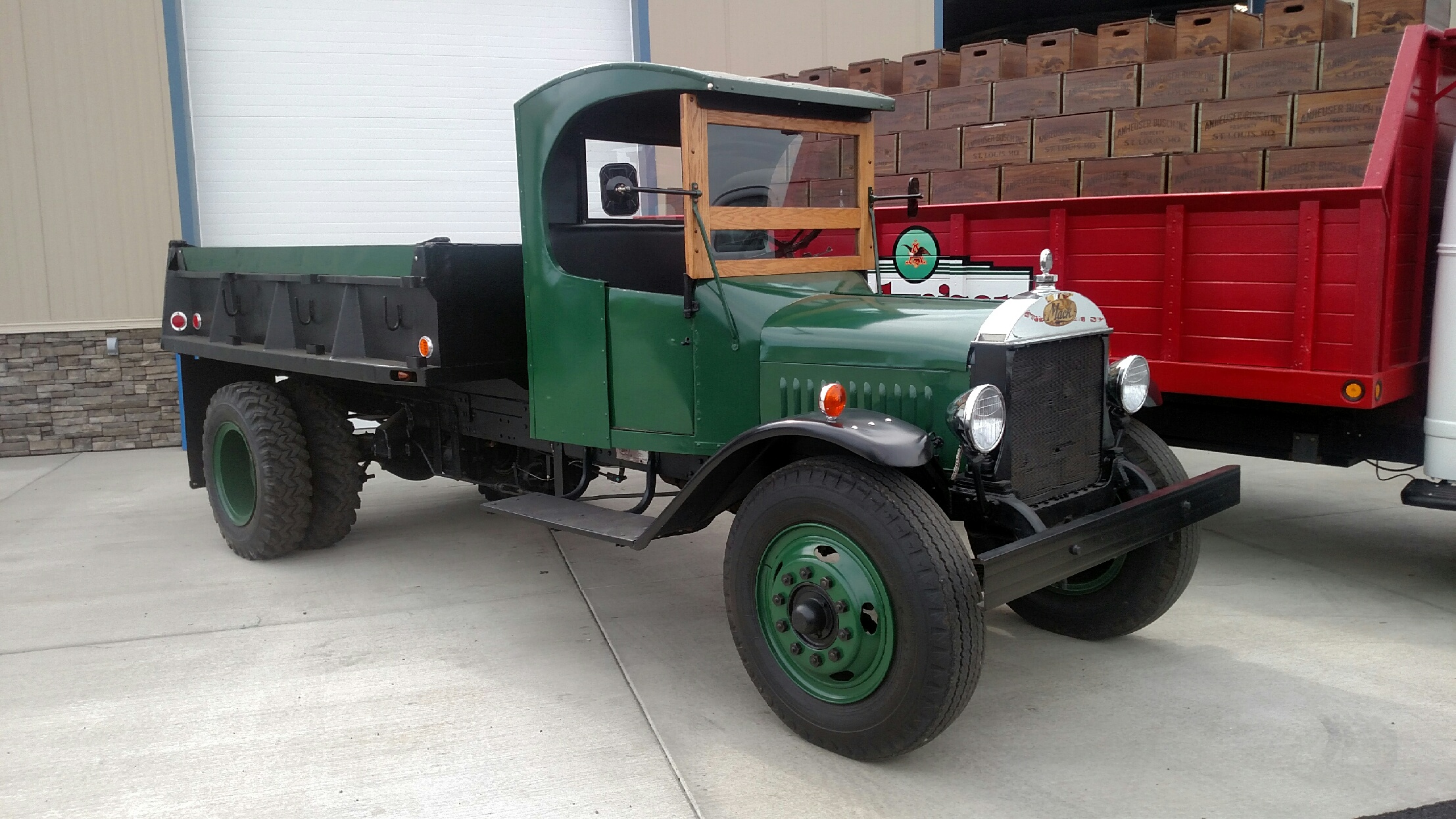

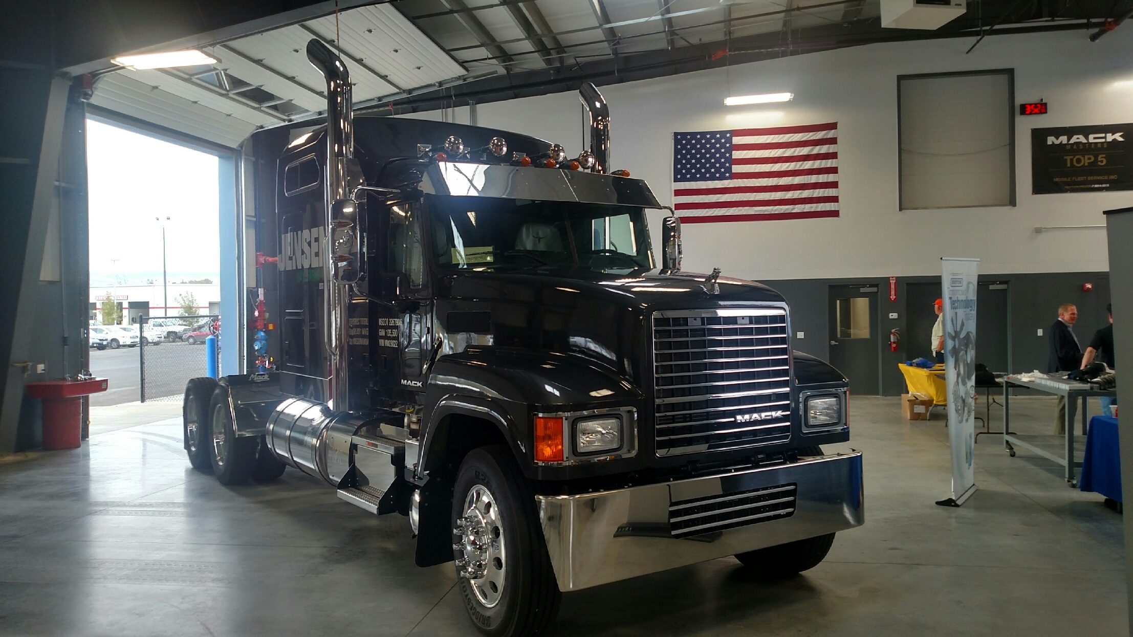

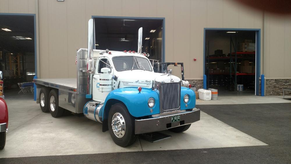

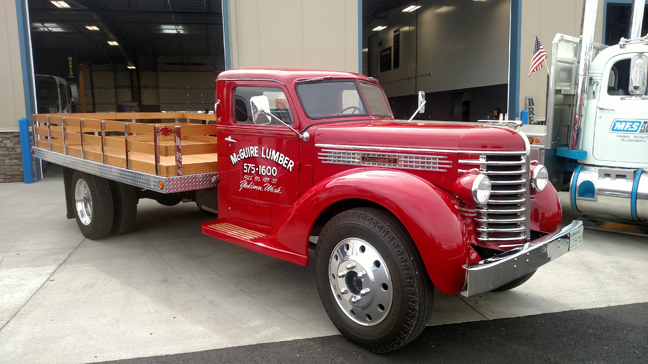

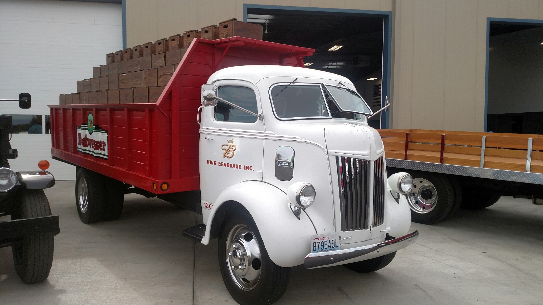

  19. Friday I stopped by Mobile Fleet Services open house here are a few pics a Mack AB. also a 1947 Ford and this diamond T, M.F.S. mascot is the B model, then some apple hauler snuck in also, as well as a few log trucks and a new Rawhide that made an overnight trip from Nevada to be with its new owner,

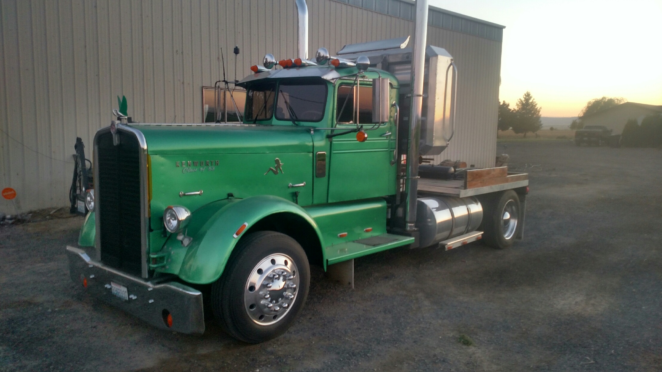

  20. Here's a picture of a trailer totter of Bill Harwood from Quincy Wa. its a 55 that he cut down from a tandem, was his spud hauling truck. He wasn't there when I stopped by so I didn't get all the details.
  21. v8 powered? or just twin stacked. Stock visor is a nice improvement ! don't get the whole stare at the backside of a drop visor thing, or maybe I'm too tall and the other drivers manage to look under them
