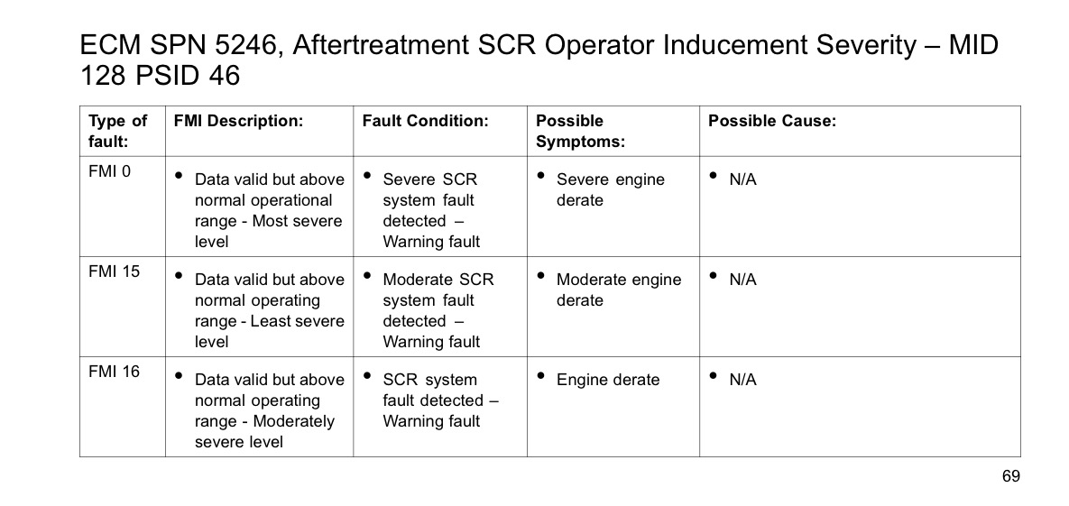

Its just telling you there's an electronic fault. If its flashing, it could be that its inactive when you try to get the blink code. But, as far as I know, it will still give you some kind of confirmation that there are no codes when the blink test is preformed. Someone with more knowledge than I will be along shortly....

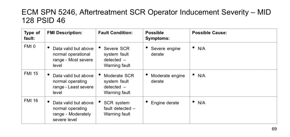

From an Emissions Fault book i have on my iPad. Sorry i cant help with the trouble shooting steps, thinking its might need to go to the dealer...

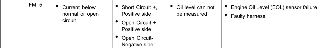

The pump could be getting weak....
Use the hand throttle to wind the motor up to 1200(ish)rpm and soak all the intake hose connections with soap and water mix. Best bet would be when it's doing a "passive regen" (?), not sure if the MP8 is the same, but my MP7 runs about 5 psi boost when this occurs....
