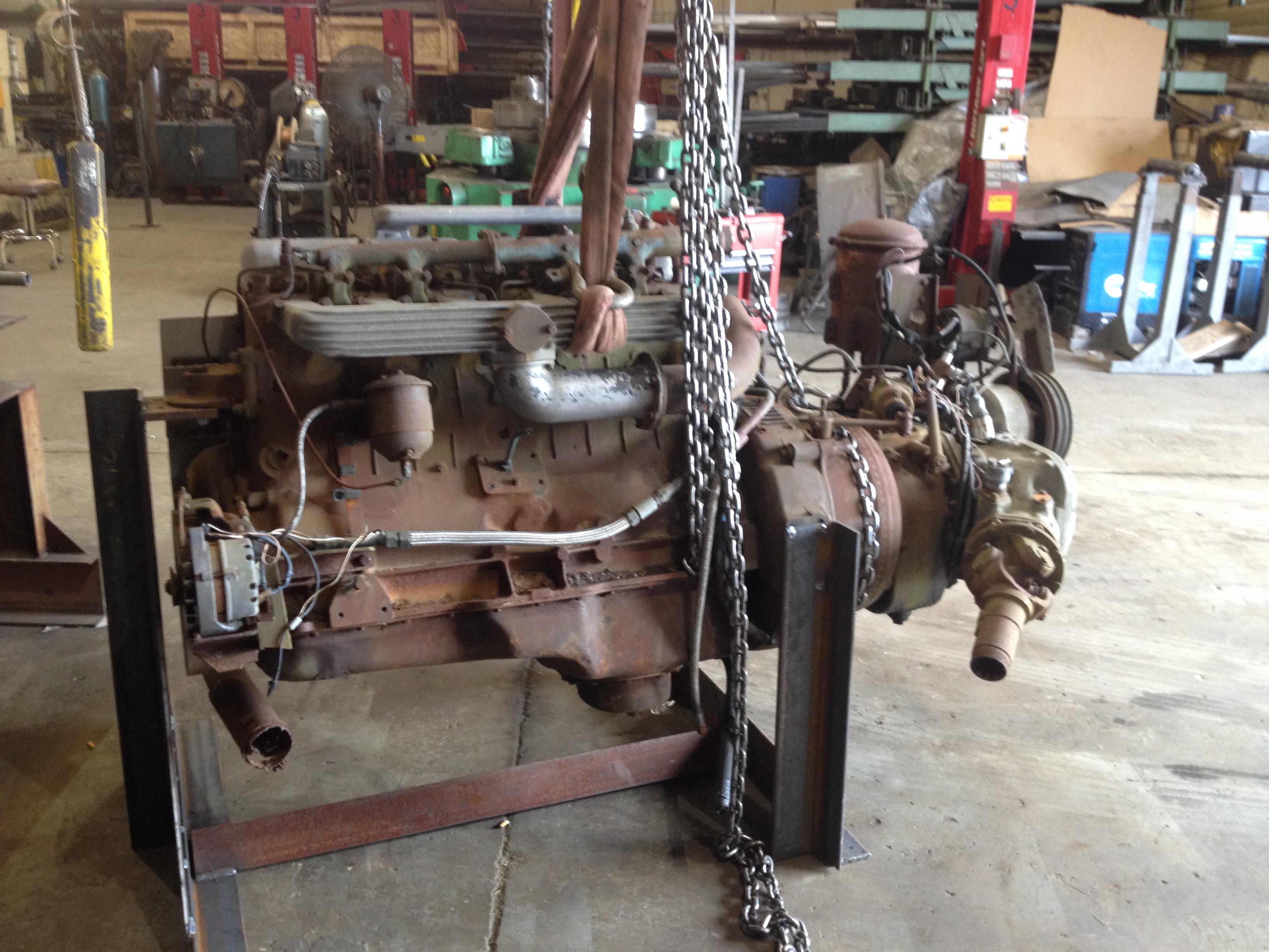

The engine has casting dates on it in several places. 1947 and 1951. Someone told me it was from a "C" series bus. Sorry I don't know more. I am attaching a picture I took of it last month here in my shop. It would like a new home. Carey caricoinc@verizon.net

I have a 673 engine with transmission out of a Mack bus I wish to find new home for. Ran when removed (about 16 years ago). Can bring to Macungie show. Best offer. Carey Leitch, caricoinc@verizon.net, 540.373.5983 days, 540.371.2301 evenings
