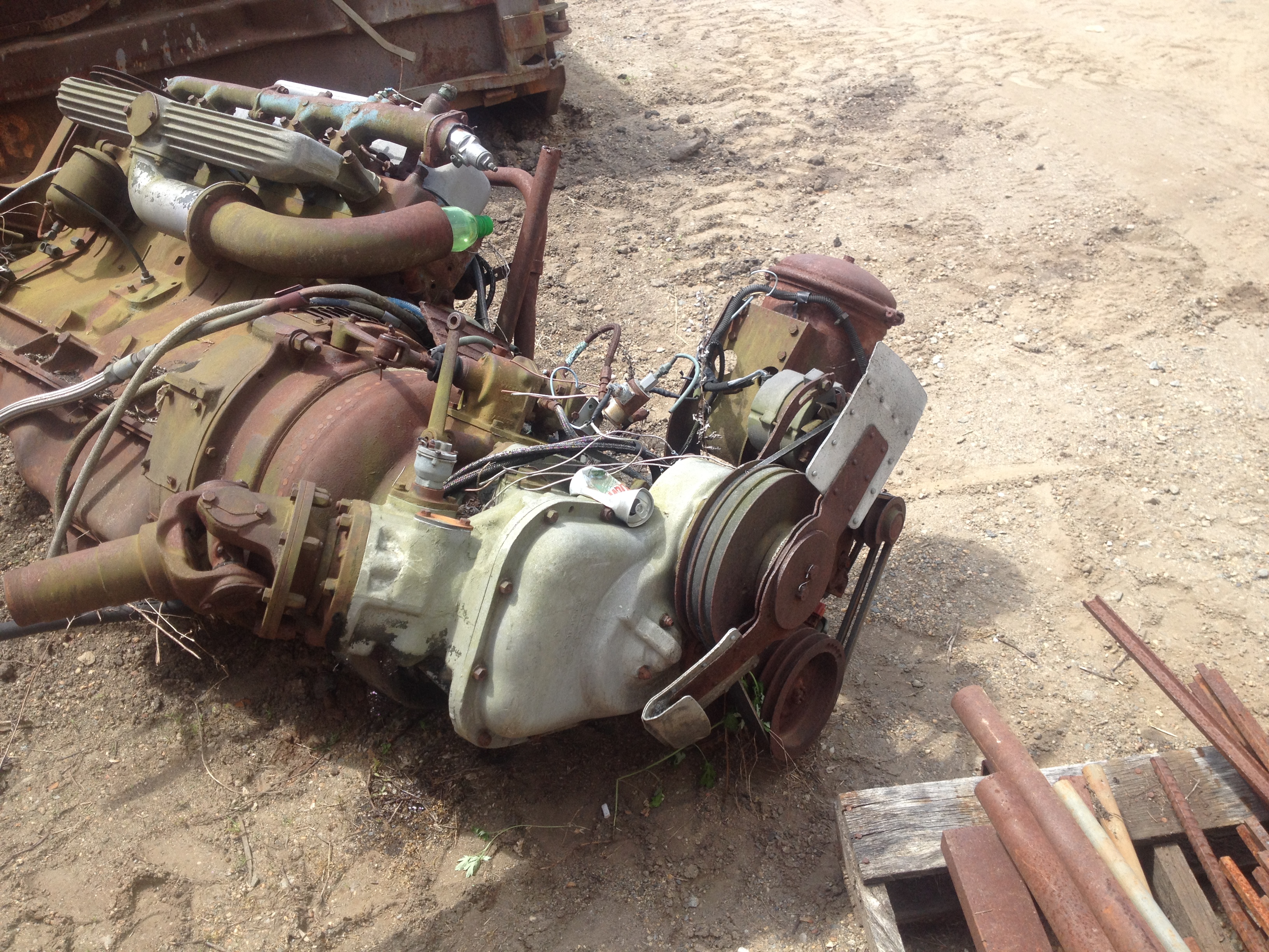

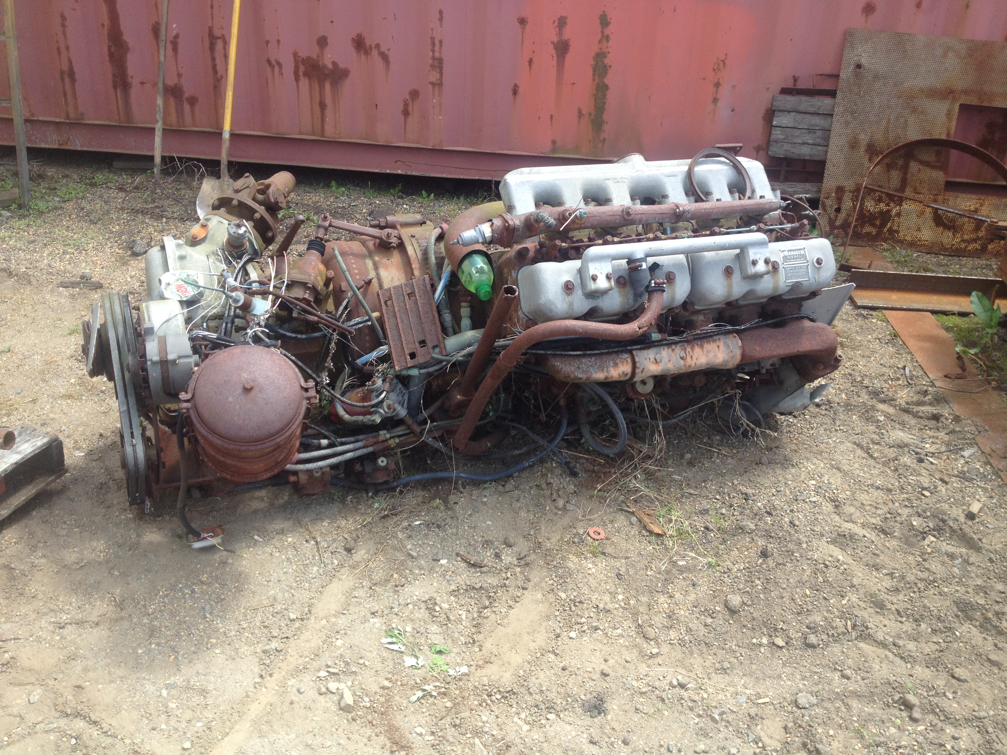

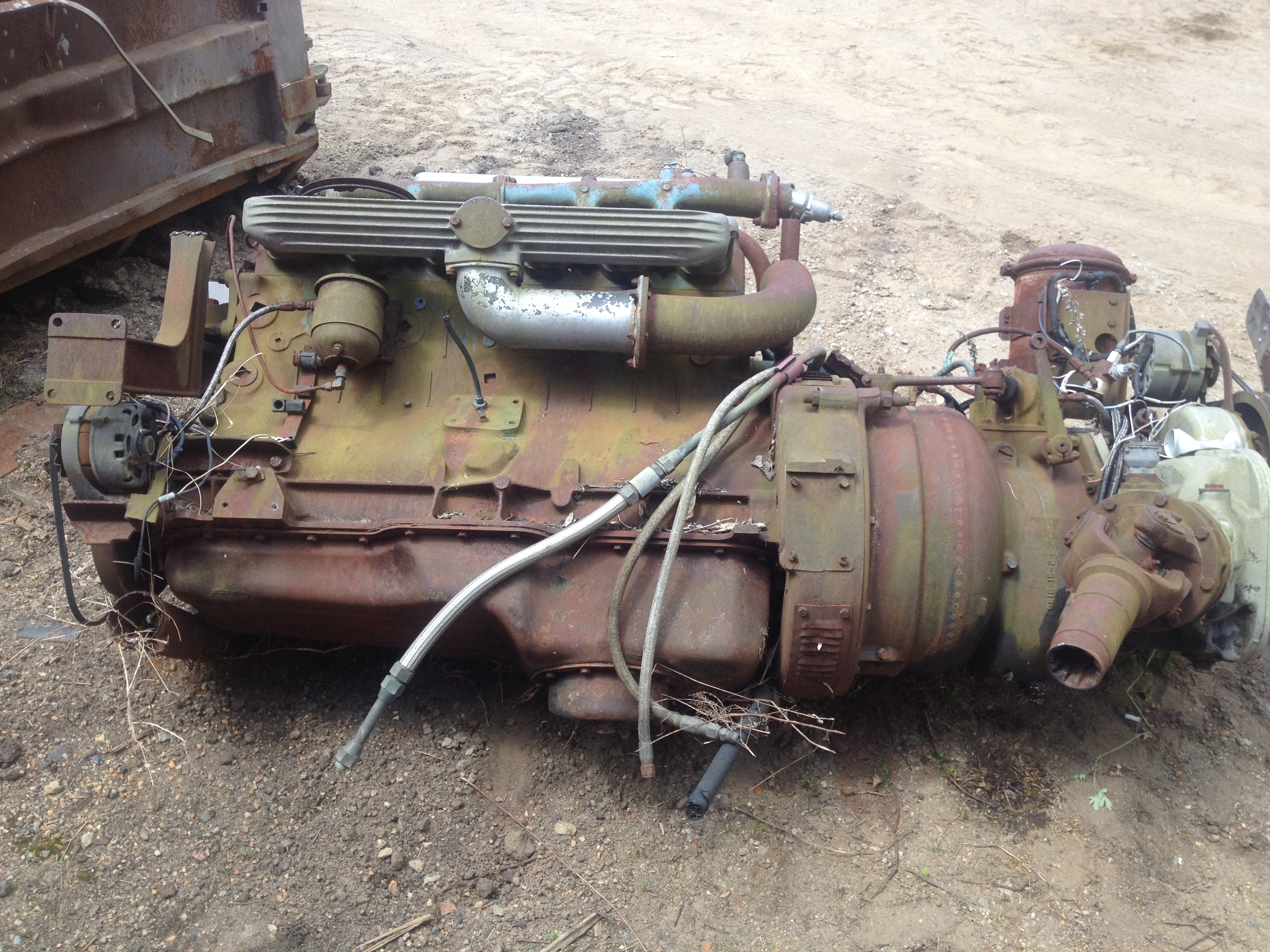

I have a complete engine and transmission out of a Mack bus I wish to sell. Had it on here for sale a while back. I have some pictures, and some info on what is cast onto the engine and tranny. Was removed from a working (ROADWORTHY) BUS BY A FRIEND ABOUT 20 YEARS AGO. I know very little about it. I do not wish to take it apart, but want to sell it complete. Can palletize and load on a freight carrier, or take to a fastenal store for shipping. Contact me here, or 540.371.2301. Located in Virginia, 50 miles south of Wash., DC. Carey Leitch
