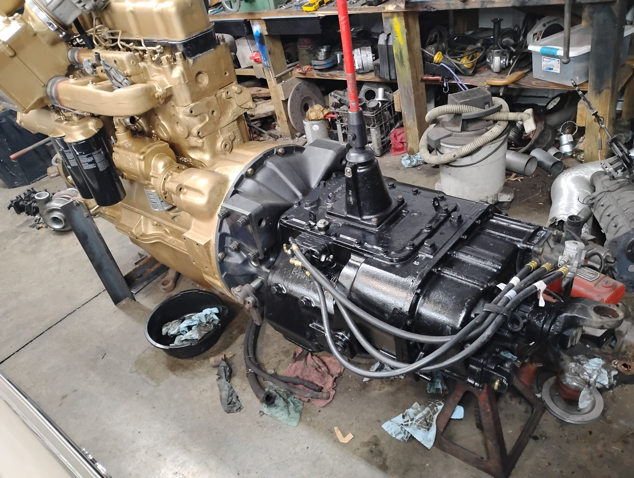

Larry, i am sure you mentioned and i read it but cant remember.
what trans are you going with. a 5 speed, or a multi range?

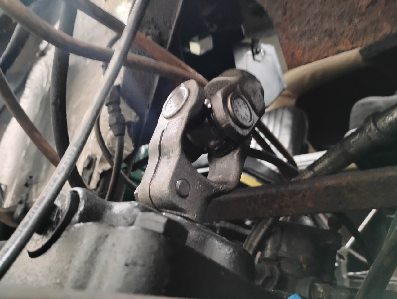

Larry, you can take the 4 motor bolts out of the air starter, flipping the motor down low and re clock the drive. I don't know if that will give you enough wiggle room to get the motor out with the filter on, it will however give you a little more room on top to attach the large air hose.
Not sure where your steering gear come to in relation to the engine, so that may be a problem.

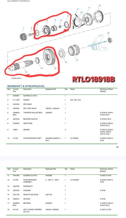

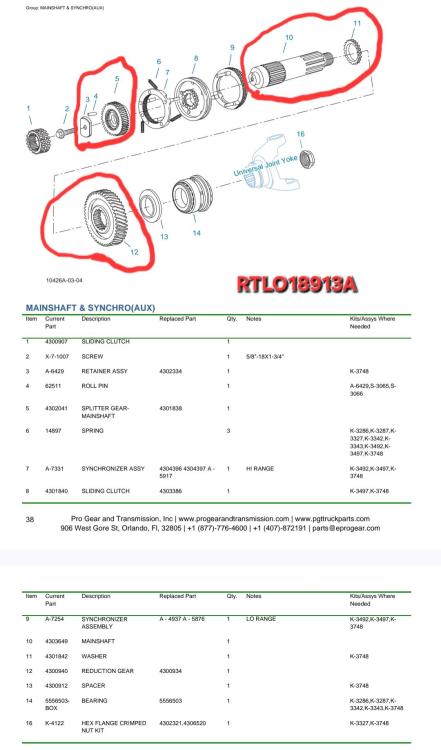

13 spd.. my second guess. 😁 im curious... if it had a 13 spd shift knob, could it be used as such ?  The Mack 2130/2180 is the same but the shift knob makes the difference.. years ago we called it a $65.00 upgrade to go to 18 spd.   That was the cost of the shift knob with the gray splitter lever...  if you took the shift knob apart, you could trim the red lever to work on the low side,    if I remember correctly,  seems like I have done that before somewhere.....  GW?  I expect a correction...
https://www.bigmacktrucks.com/topic/75768-300-rebuild/page/35/#findComment-593786
Ok.. yep ,he will know.  He should be here soon.  I cant tell you how many times I shifted an Eaton 9spd Like a 10spd by accident, and it was fine..  Hell, what do I know?  😆
I have used that low hole 1st on the high side of a 13 speed many times.. Then split it!! It actually splits what would be 5th on the low side into 2 separate speeds which you need at the time.

Let be start by saying I have zero experience  with the newer RTLO series.
All the roadrangers I worked on were the older RT-RTO series. I haven't been inside one in almost 10 years now 😮.  I remember there being a reason the old series can't take a 13 and make it an 18 with just a knob change.
 So I am going to disappoint just about everyone including myself and say I don't remember why.
There is no reason not to use highside low on a 9 spd or a 13 (or 18) where it becomes more risky is when you use the splitter gear. You are multiplying the input torque through the the front box, then passing though the splitter gearing, and it isn't designed for that. In direct the power flows straight through the back box.
 The reason it is not generally used in a 9 spd or others is it is a ratio in between 4th and 5th (or 3rd and 4th if you use the "low" terminology) and the step between that isn't a even step.
 If you're climbing a grade it may be tempting to use "funny gear" as it used to be called (highside low) but the jump down is a bigger one then it is to low side high, and it means any further downshift will also be another un-even drop. The low range gears are larger and better able to take the torque input for long periods than high side low.
 Empty I also have used funny gear many times, 1-2-3 (or if you must, lo-1-2) flip to high and go back to 1st, it is a bigger jump than continuing on in low and the jump from there to the next gear up is  bigger jump than shifting as you "should". I only did it empty, not saying it is better or great but no harm will come.

always thought if adding an underdrive rear splitter box to an overdrive front, to make what Eaton finely did in the RTLO series.
Gives you two O/D ratios .86 and .74, direct is one stick position down splitter in direct.
Edited by Geoff Weeks
https://www.bigmacktrucks.com/topic/75768-300-rebuild/page/35/#findComment-593796
It may be as simple as the 18 and 13 use different low (range) and OD ratios and if you got it to function, it would leave you with ratios that aren't really usable.
A 15% splitter ratio for the 13 and 18% for the 18. So the 18 has a lower "low range" ratio so when in OD low it is close to low in the 13. If you take a normal 13 and add an O/D without changing the low range ratio you don't get the ratio spread you need to be usable.
