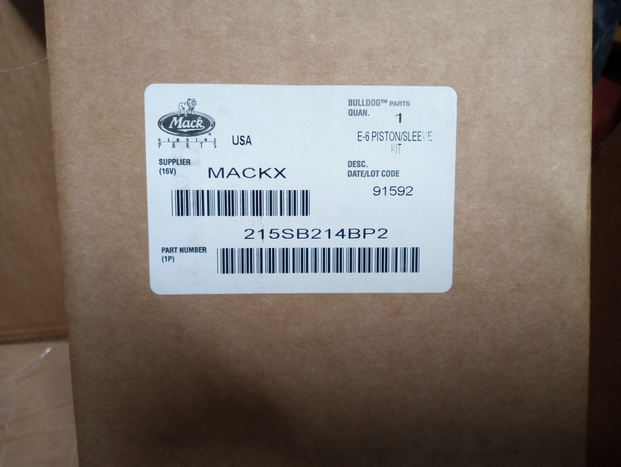

So I pull a liner kit out and start to inspect the pieces (liner, piston, rings, pin).  I take it over to the block to test fit liner.  It slips right down into block!!!  😲😲😲😲😲
Apparently they sold me std OD liners.  🤦🤦🤦🤦🤦🤦🤦🤦🤦🤦🤦🤦🤦🤦🤦
Guess that is why I got that itchy feeling when a "new guy" took my order.  Yup, got screwed over.  The box is marked "no return if open".  They better!!!!!!!!!!!
Can anyone decipher the part number?  It isn't at +.020 liner that's for sure.
Ugh ...time for a phone call monday morning.  Dammit anyway.

Ya, now I will find out .020 is NLA.....  Because he looked up the wrong part.  He said he was only there a few months and was a cumapart guy.  He was supposed to check with his boss, but someone screwed up.  Not me.

On 12/1/2025 at 2:21 PM, Freightrain said:
Good news.  Local Mack says full kits are available in .020 liners.
Pt number 215SB196CP2
$3355 cash over the counter.
Now I will pull the last 5 liners and confirm before ordering.
So, this part number is incorrect.  I need to confirm what brgs as I told him the crank was std.

Well, got my answer.  🤦
They don't offer a complete kit with .020 liners.  Sooo, I have to BUY six .020 liners and eat the six .002 liners in the kit.  Oh yay.  Another $1208.  Why not....😡
Anyone need some .002 liners??

https://www.bigmacktrucks.com/topic/75768-300-rebuild/page/11/#findComment-587162
Assholes! Check PAI ! I wouldn't darken there door step again that was the parts guys FUp ! you should eat nothing!
