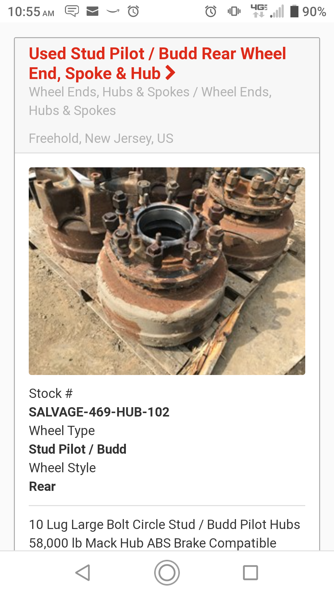

Those in the picture JoeH posted look like they might be it.  They're inboard brakes. No advantage to them as far as brake work goes. I'm thinking they may be the only way to get disc type wheels on 58s.  I could be wrong though.

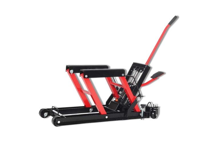

If you do have to drop the wheels for some reason, a motor bike jack works a treat

On 4/7/2024 at 11:03 AM, JoeH said:
https://truckpartsinventory.com/part-details/82219704/used-stud-pilot-budd-rear-wheel-end-spoke-hub-for-sale
Pulled this off the googleweb. Haven't been able to find a P/N. Gonna hop on Truck Paper and look up RD/DM SX models and see if anyone has budds. Then you can pull a VIN off the truck,go to Mack and get drive hub part numbers.
I inquired about them and was told even though they are stud pilot they require a special rim and can only run 24” tube tires
