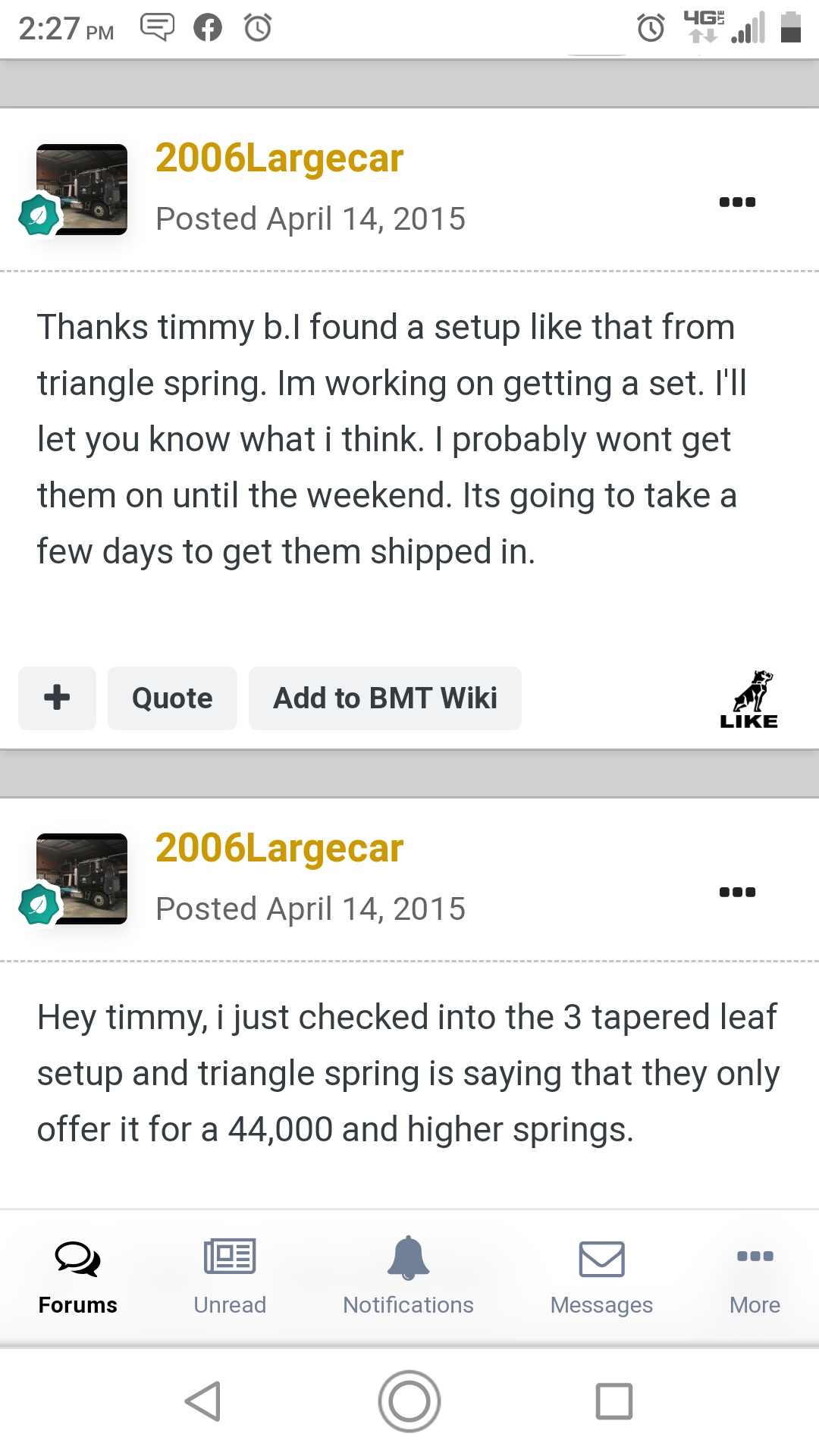

Looks like they start on 44k setups?... Don't know if they make 38k versions.
Also I havent seen any weight ratings listed on any of the quick research I just did. So I wouldn't trust it as far as I could throw it. 38k is a bit light weight for off-road dump truck work, but we have a 1979 volumetric concrete mixer truck we have had since 1986.  Same 38k rears, the suspension has held up very well. It just got new rear springs a couple years ago, one side was sagging, other side finally broke a leaf.
