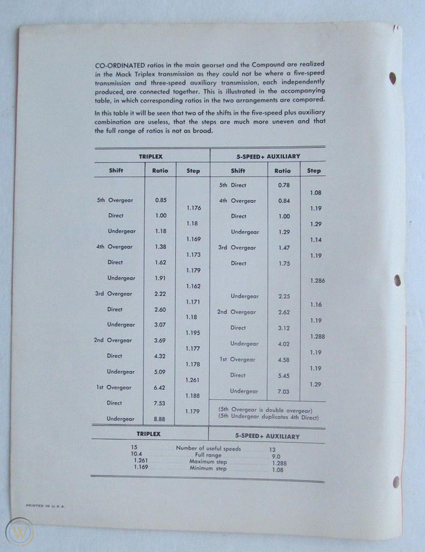

So doing some googling and from what I can gather you have a Triplex box
Google tells me these were in either single over drive or double over drive
Which one do you have ?
Double overdrive gives a pretty hand overdrive
vintage-mack-triplex-transmission-1-ad14
Maybe also be a option, dunno enough about these transmissions and their numbering
