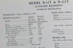

Was a B421 diesel? I was always told with B model nomenclature that model numbers ending with an odd number were diesel, and model numbers ending with an even number were gas.....it holds true for everything I've seen but I havent seen much and I don't know a whole lot about B's
B421 was a flathead gasser, very gutless!   Terry
B42 had a EN 401/402 @ 150 HP. Minor differences and I believe an extra head stud. The B421 I thought was an overhead valve EN438. There’s also the B422. There’s a factory chart around the lines up the difference models and engines, just can’t put my hands on it.
Also, Magnadyne was the flathead and the Thermodyne was the overhead valve. Run some google searches, tons come up from this site, ATHS and others. There's an answer in there somewhere, I just haven't looked at that stuff in years since switching to diesels.
  • Thanks 1
I had paper work on that B421 from new and it had the flathead.    terry:MackLogo:
I'm probably off. From what I saw in a quick search I did, the 421 was a "cheap" version of the 42. No oil cooler and several other things deleted. I think I was mixing it up with the 422, which did have an overhead valve engine. There was a site from where the B model registry came from that had a lot of engine and transmission reference material from Mack posted on it. I can't seem to find it, so it may be gone.
There was a comedy movie in the early 70s when a young kid was driving a Mack gas job I think it was a strait job flatbed it didn’t even have air brakes I can’t remember it I’m sure one of you fellas can bob
422 has an over head value Thermodyne.  I think an EN 460.  Mike.
