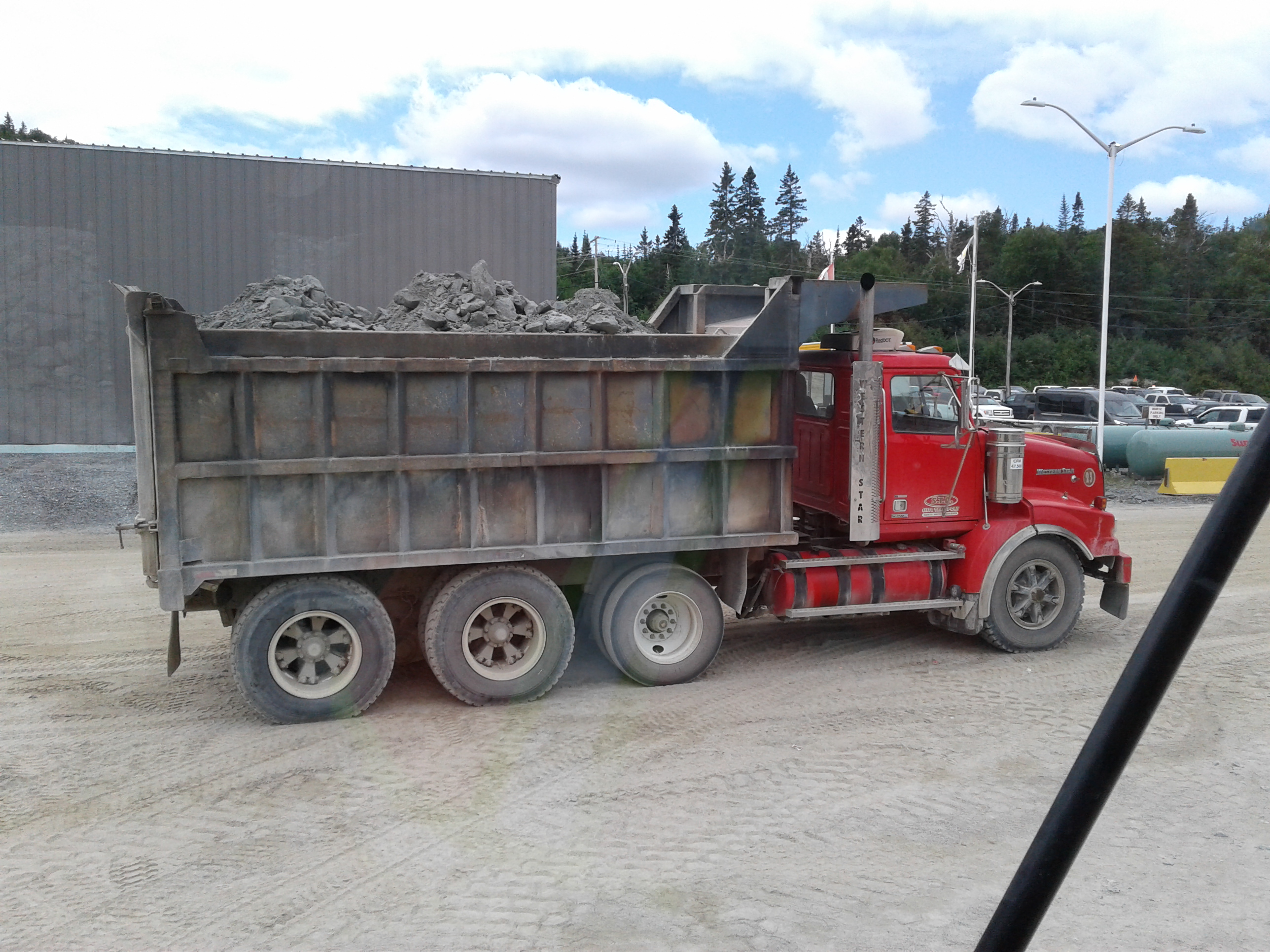

Saw this at the Mack Customer Center back in 2015. Export only...or so the numerous stickers all over the truck said.
That looks like it has the 3-piece rims on it.  We talked about those in another thread recently.
Pretty good-looking truck.
Thanks for posting!
Thanks for posting!
Wow I didn’t notice that,,, but your rite,as well as the fact the hubs look 60s I’ve mentioned before... one of my first Jobs was in a truck tire shop... in 73. Worked with hundreds of those rims... bob
