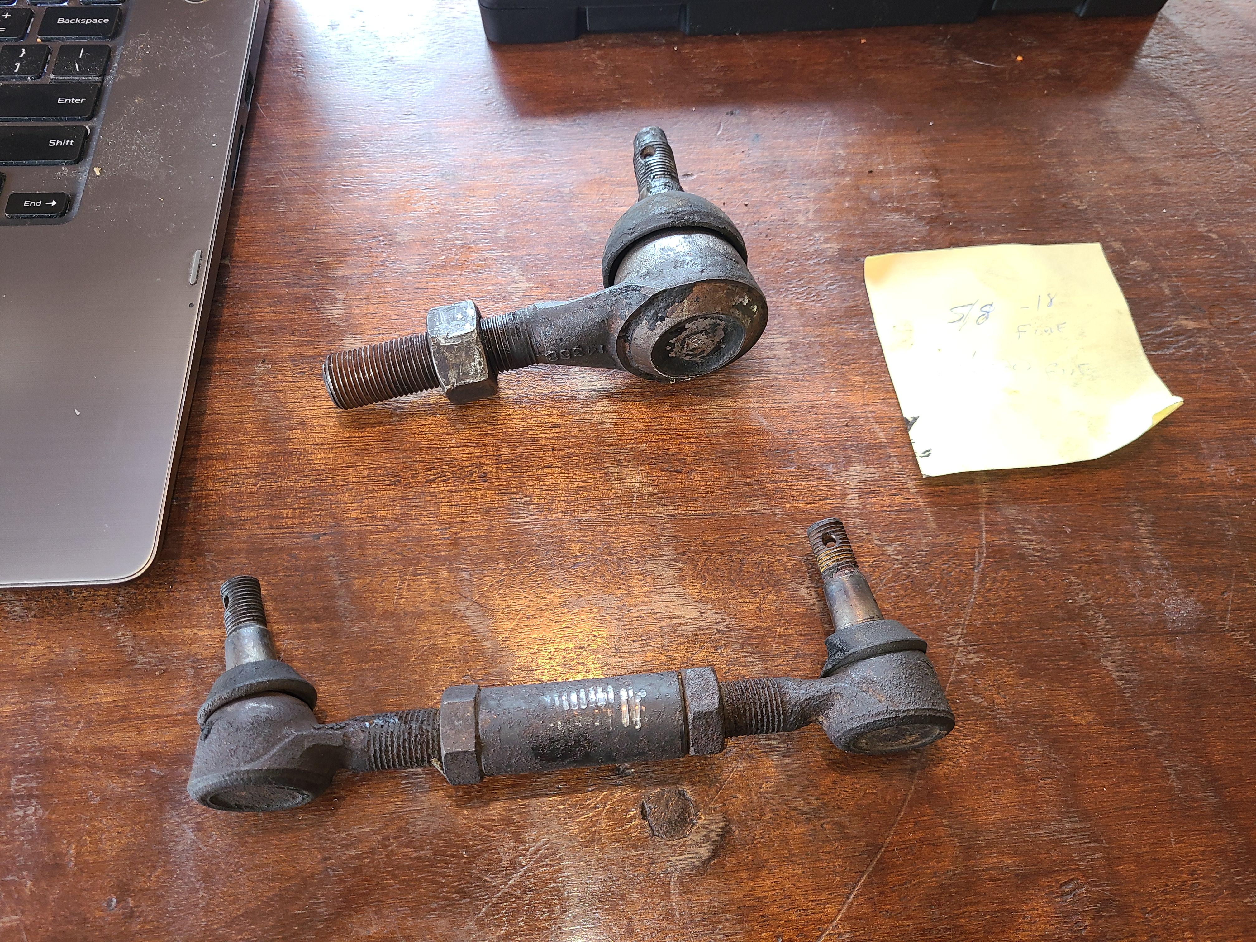

The U joint on the shift linkage is a Rockwell L6N or MOOG 861 if anyone ever need to look

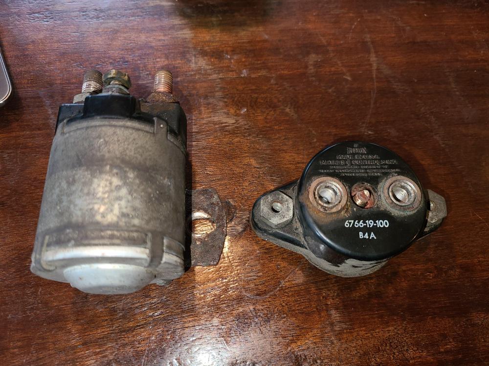

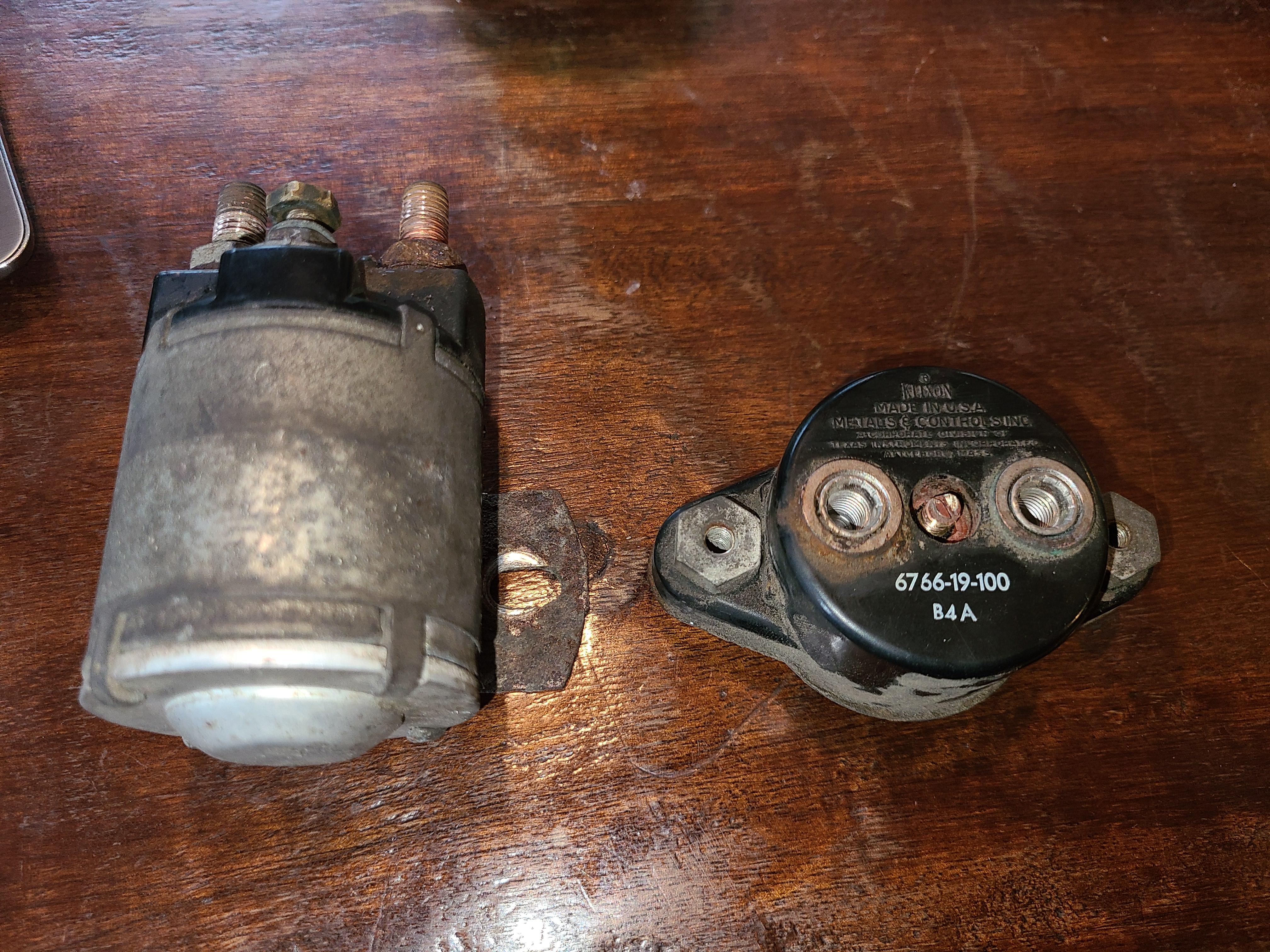

The battery cutoff and the ignition switch are clearly a problem
The cuttoff is frozen on and something is leaking heavily to ground. I get 12v from the aluminum step up to the Cab.
My seems to be similar to everyone elses it looks like there is a master disconnect on top and a key powered solenoid. I think I will replace those 2 and see what happens. It is difficult to diagnose as there is so much current leaking into the chassis

I am stumped on the shift linkage ball joints. The larger one I think is just something someone stuffed in there as it was not fitting correctly and the lower one does not seem to match anything I can measure out. I think I should start with what was supposed to be there and go from there.

The thermal fuse (electric breaker) is a Klixon 6766-19-100 $53 from Peerless
the Continuous duty Solenoid is a White Rogers 124-906 $39 from Ebay (if you want the exact replacement)
U-joint at the bottom of the shift linkage is crosses to a MasterPro 861 (There are tons of subs from different manufacturers)

On 5/15/2020 at 1:42 PM, Vladislav said:

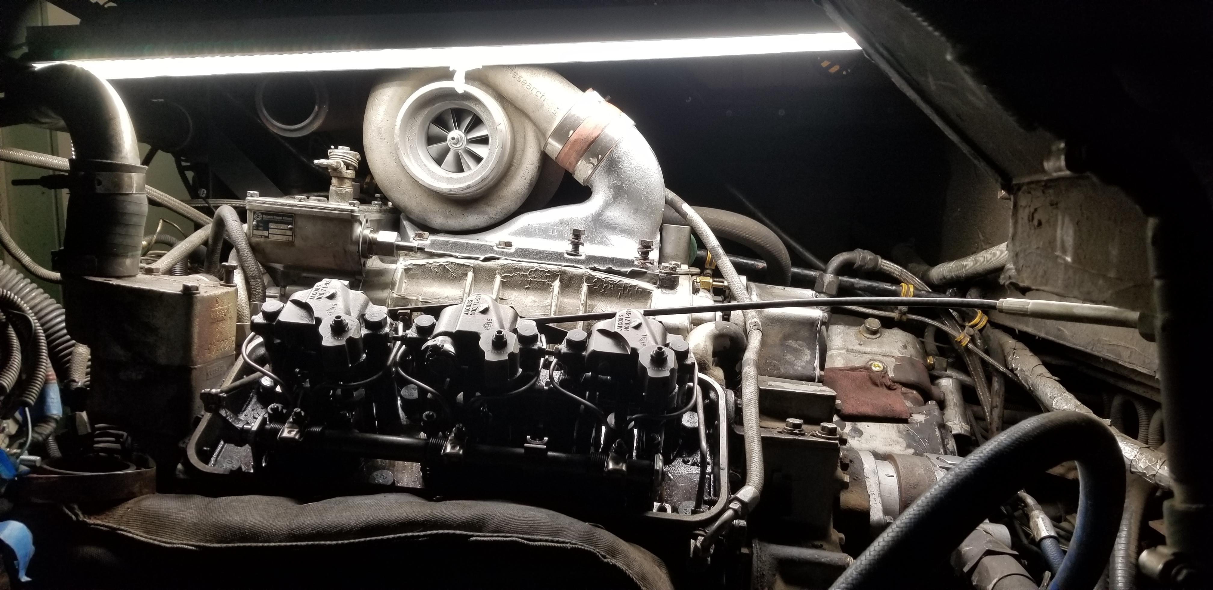

The engine looks like 2V E6-350 which was installed in MH's before 1985. It must have a chassis mounted intercooler in front of the main radiator. Very reliable engine and the most of parts are easy to fing and cost reasonable.
The solenoid looks like a main shut off relay. R-model has similar part installed under the dash. It gets on when you turn the ignition key and supplys power to instrumet panel gauges and alternator. Probably to other circuits either. Some outside lights (or all?) and engine starter are supplied straight passing the relay. I didn't look for the relay in MH since didn't have a trouble but my R-model has it inoperational from time to time. Usually after the truck is parked for too long. Actually it gets stuck and you have to turn the key multiple times or slightly hit the relay body. Once I bought the truck the previous owner hitted it every time he switched the ignition. I took the solenoid apart, cleaned and greased it and it turned out troublefree. But in a few years it started remembering me his existance.

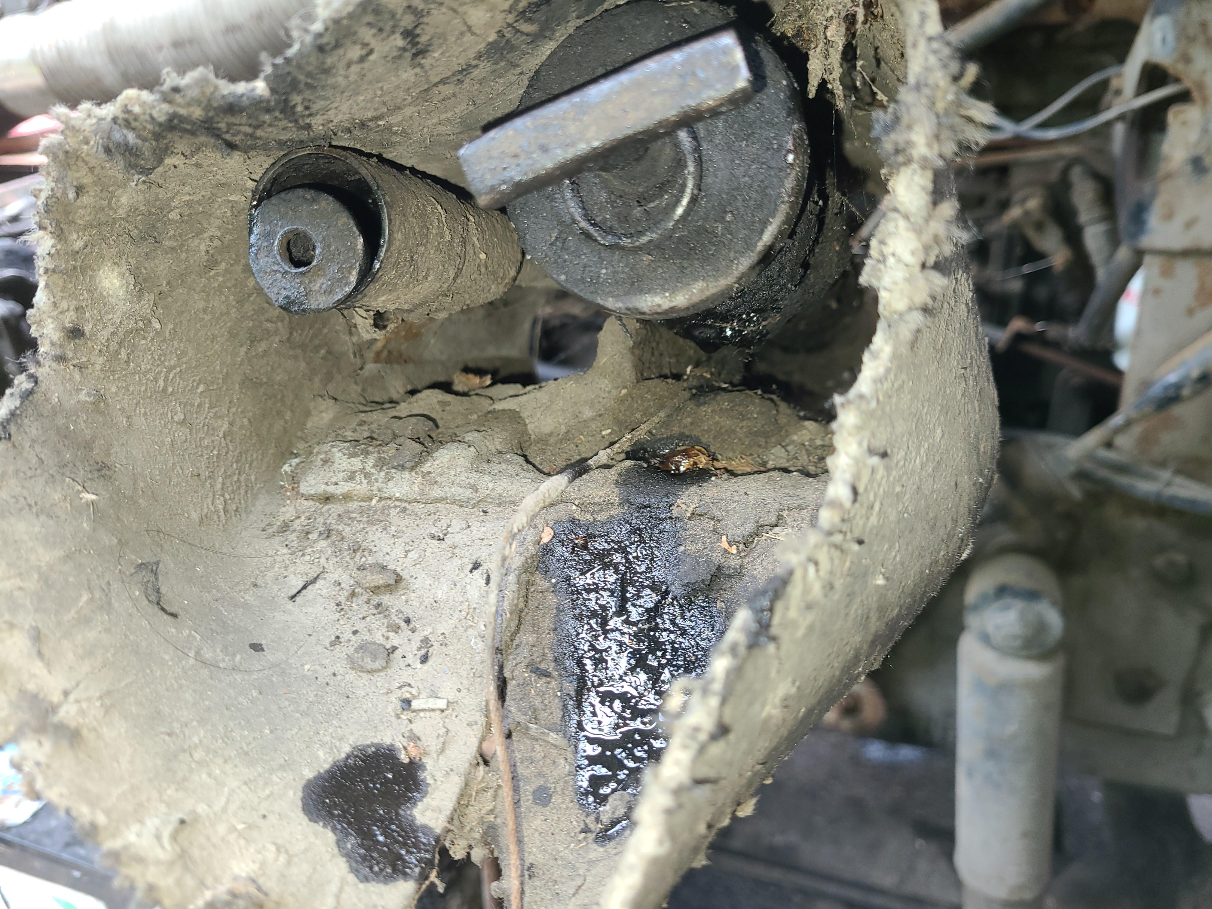

Another Question, On the bottom of the tranny there is an inspection plate missing with a grease zirk on a tube and some sort of shift collar in it. (Hi/Low?)
Is it common to remove that plate and leave it off?
It seems to have been gone for a while based on the grease on the flange. I am worried some tranny issue got this parked years ago.

Sounds like zerk for throw out bearing, don’t over grease, watch & or listen for grease. Should also be zerks on each side of trans for the shaft & fork that pulls throw out bearing. Lots of covers have been taken off, it’ll be ok for farm use
