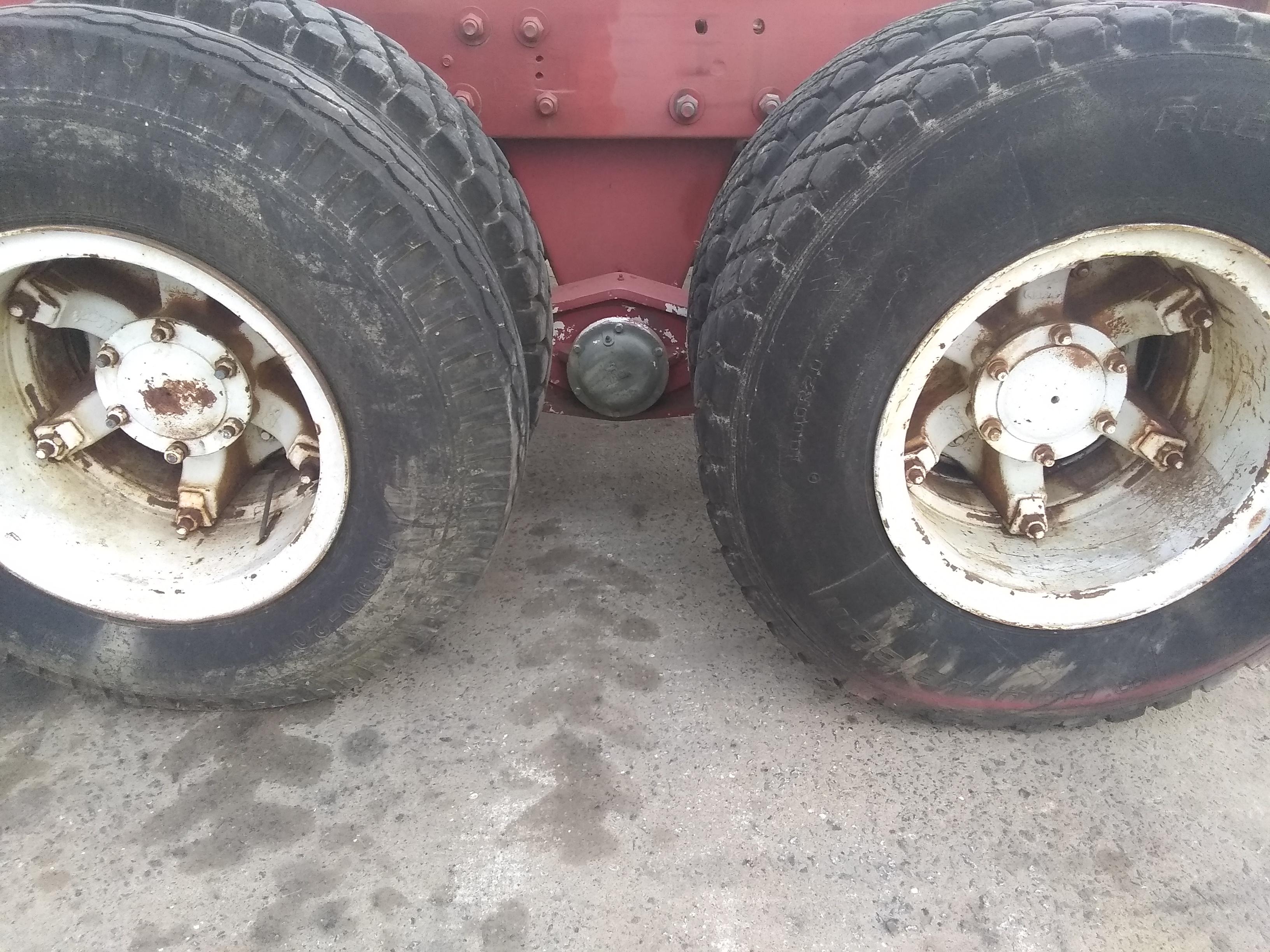

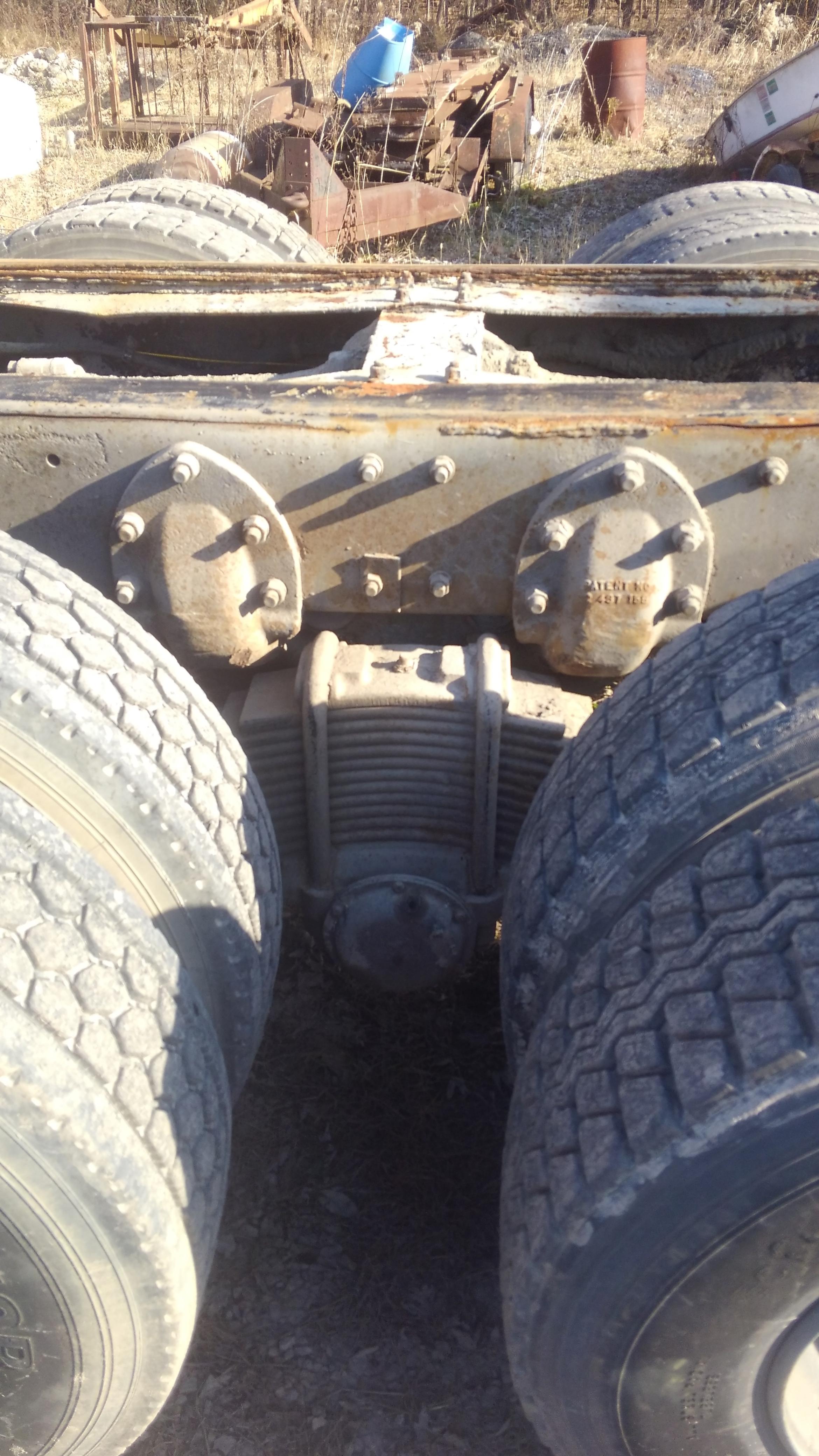

My best guess is 44k.  6 spoke hubs rule out 38k I do believe, unless 38s on 24.5's require 6 spokes, and the trunnion crossmember is lacking the eagle rails that make it a triple frame for 6 ft or so for 55k+ setups.
This truck has 55k springs on 58k rears.

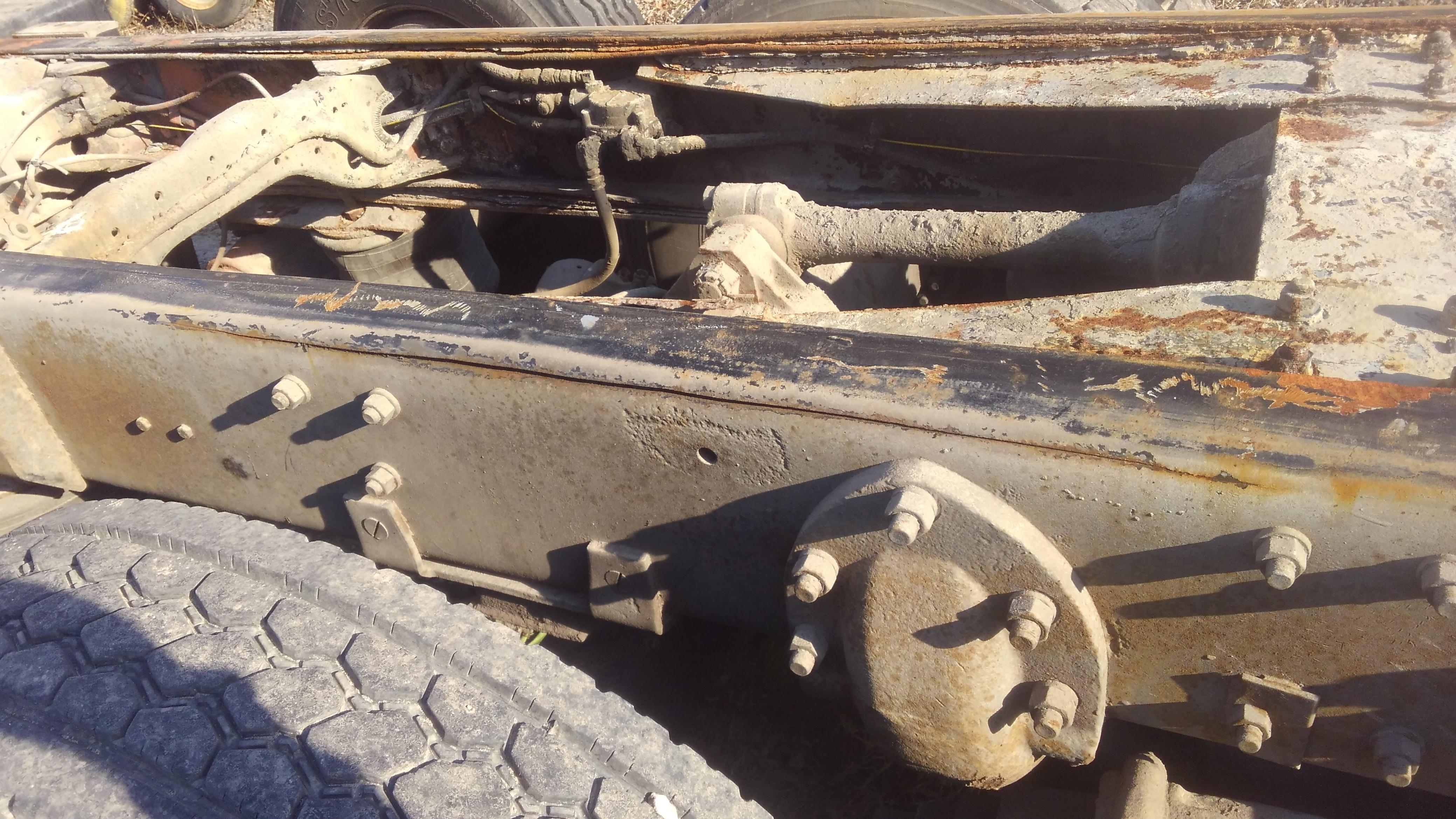

The "Eagle" is a third inner rail that functions as a gusset to stiffen the trunnion.  It's a double frame truck, with two 3/8" rails for a total of 3/4 steel, excluding the Eagle. Also note that the trunnion stands bolt to the outside of the rails.
5 hours ago, theakerstwo said:

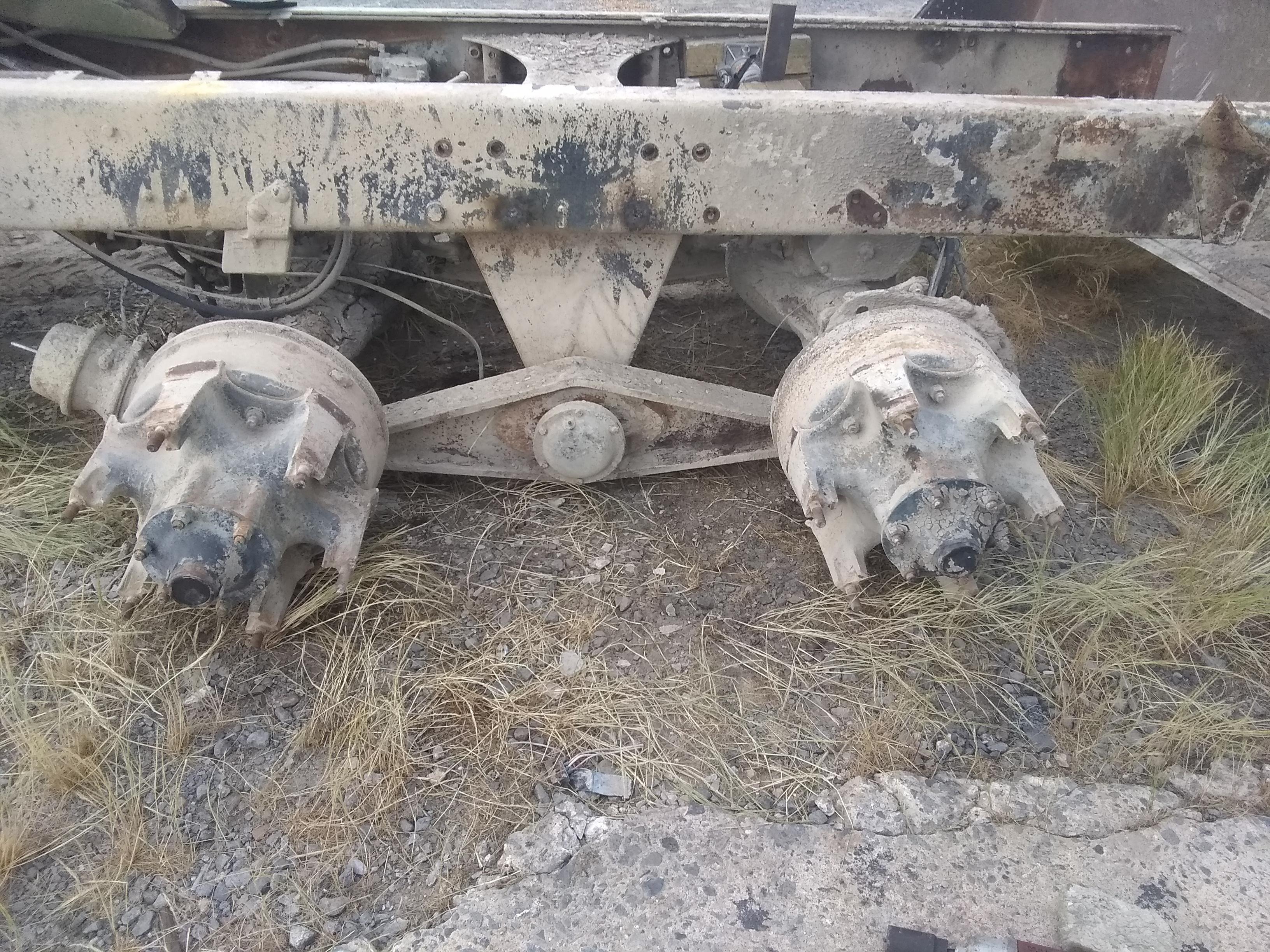

i have a trunion like that and can i use 44 springs on that trunion shaft?
I am not sure if the trunnion height is the same between the spring and the solid walking beam trunnions.    terry:MackLogo:
