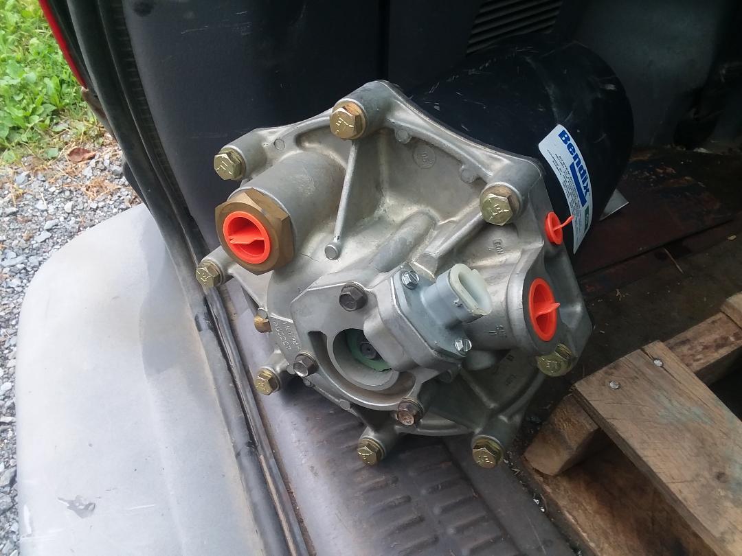

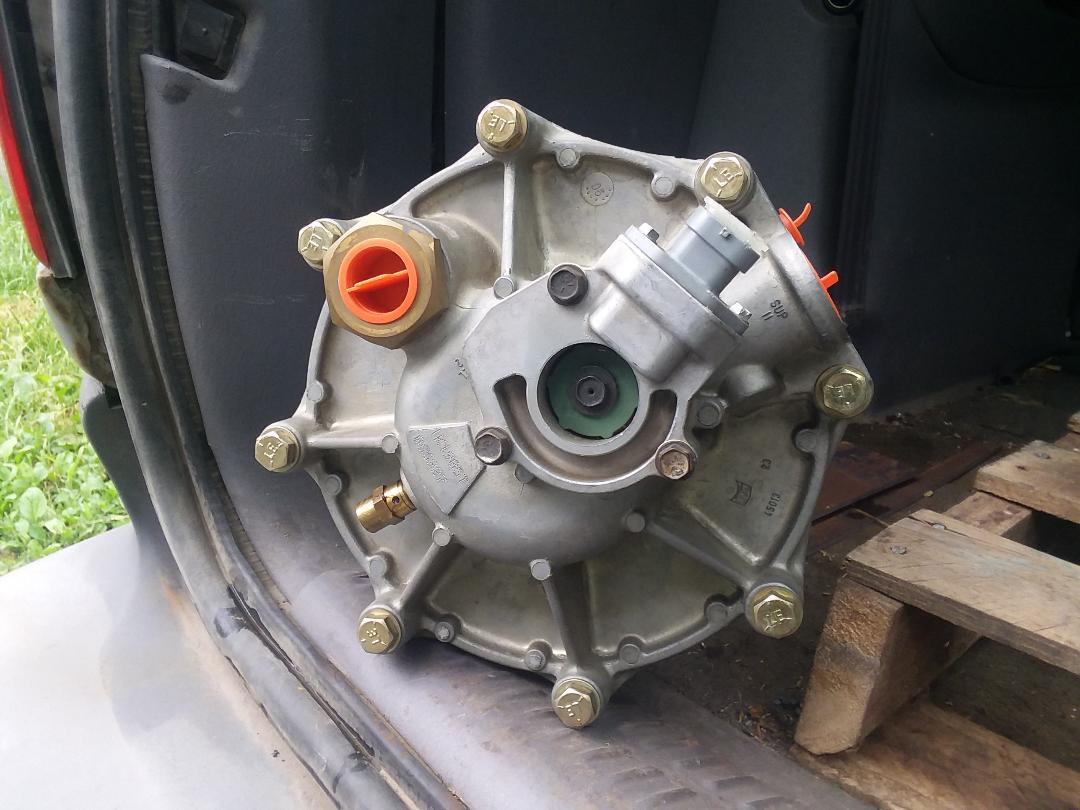

Is there an easy way to differentiate between the AD-4 and AD-9?
It looks like on the AD-9 the control port is located just above and to the left of the supply port.
It looks like on the AD-4 the control port is several inches to the left of the supply port like this photo

Attached pictures of a Bendix AD-9 I just picked up for my truck. I'm new to the air dryer thing. I don't know the difference between an AD-4 or an AD-9 but I thought a few pictures might help for a comparison.
