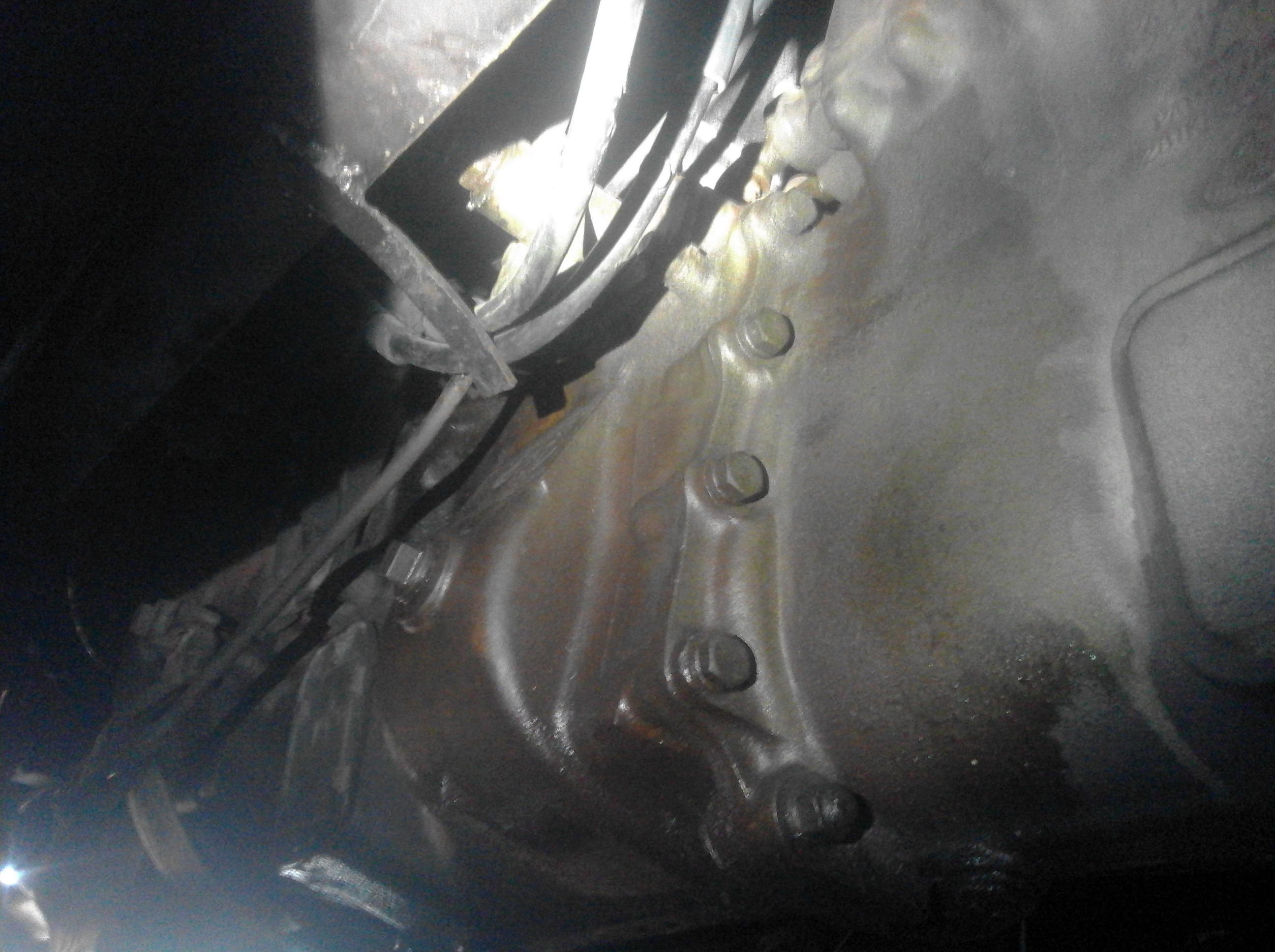

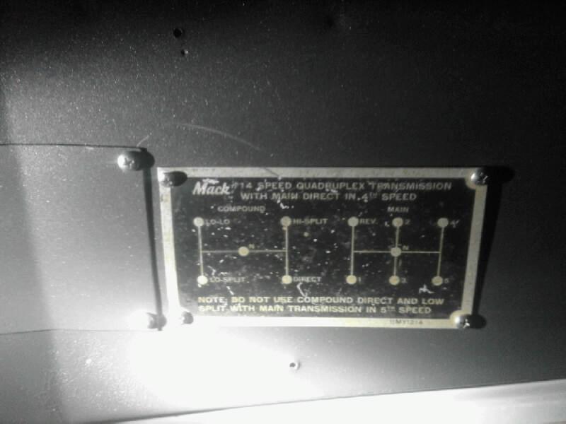

Rob:
Further details:
1. Tire size 1100-24
2. Pic of shifting legend.  It reads "14-speed quadraplex transmission with main direct in 4th speed"
3. Found what must be the Q, so it reads TRQ 7220
4. Pic of transmission:
Thanks for your help.

Being a double OD, you lose a few more gears then a Single OD transmission has.  You don't split 5th, since it is OD, thus it is only a 14 spd   Once you get to 4th OD, the last shift is moving the main box to 5th which completes the double OD.
Larry
Link to post
Yes, that's exactly my understanding of how it should go.  That is, when I get to 4th Direct (which I think you're calling double-OD) I then shift up by going immediately to 5th Direct.
Don't completely understand the nomenclature on the tranny.  I take it that a) the first OD is what is term HI-Split; b) the 2nd OD would then be what is called Direct.  Is this correct?
I should have 5x4=20 speeds.  How do I end up with 14?  I see that I lose 3 in 5th main by not being able to run 5th in LO-LO, LO-SPLIT or HI-SPLIT, so I'm down to 17.   I must lose another 3 speeds somewhere.  Could it be that I can't use the full auxiliary range in 1st main?
Anyway, plenty of gears for what I need, and thanks for the education.

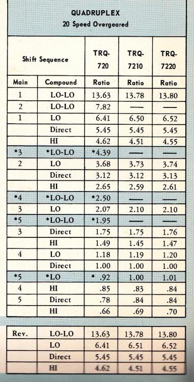

Don't get all 20 because of ratio overlap or redundancy which is noted by the asterisk.
Here is a chart with the ratios so you can see what you have.
Jim
Link to post

Many thanks for this information.  I believe I get it now:
1. I lose LO-LO across 3, 4 and 5 in the main.  Minus 3 gears, down to 17.
2. 5 LO is useless, since you've been there already with 4 DIRECT.   Down to 16
3. 5 DIRECT redundant to 4 HI.  Down to 15
4. 2 LO-LO gone as well, so down to 14 effective gears.
Conclusion:
1. Forget about LO-LO unless loaded;
2. Unloaded , option 1: 2(LO/DIRECT/HI), 3(LO/DIRECT/HI), 4(LO/DIRECT/HI), then 5 HI--unnecessary, if unloaded
                                     2:2(DIRECT/HI), 3(DIRECT/HI), 4(DIRECT/HI), then 5 HI--also unnecessary, if unloaded
                                     3:1 (HI), 2(HI), 3(HI), 4(HI), then 5 HI--perfectly OK
                                     4. Better yet: 1 (HI), 2(LO/DIRECT/HI), 3 (HI), 4 (HI), then 5 (HI)--a little easier getting going
Opinions?
Link to post
