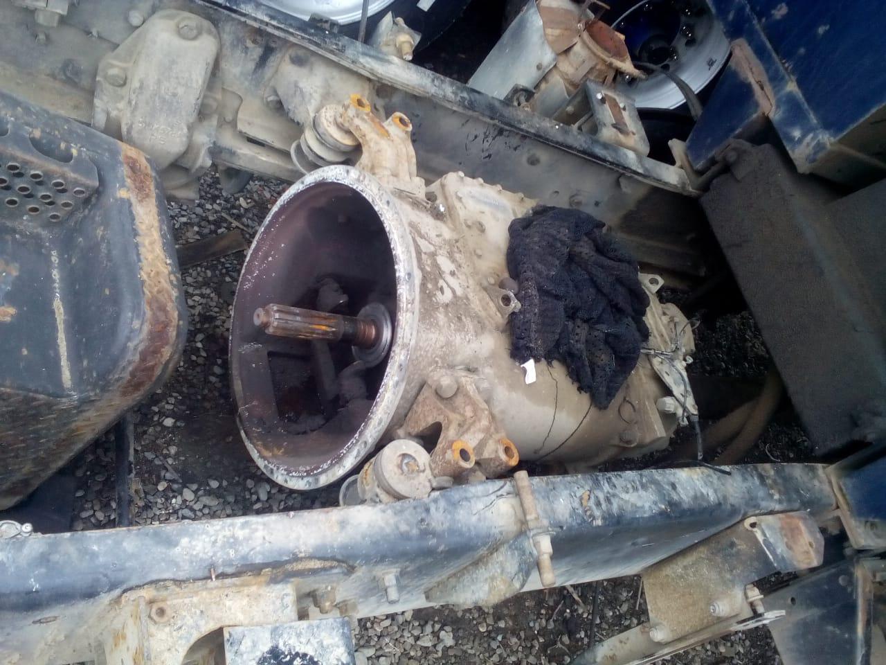

I am offered to buy such unit locally. The price tag is reasonable but I have no idea on the ratios, body length etc.
It was removed from (as they said) 2004 DM dump truck with some kind of E7 engine.
I'd check the bellhousing to make sure the mount flange still has some taper--hasn't been run loose. Also looks like it may need an input shaft by the looks of the throw-out bearing area. If the bellhousing is in bad shape then the only good thing its good for is parts.
Good point on the bell housing, thank you.
Actually the potential use is in a hobby truck. So not many miles are planned. This doesn't bring much worries on the input shaft cond too. As long as I know the engine was taken off just a week back. The matter of the rust seems the truck was parked with another issue (rears) for nealy 5 years as I was told.

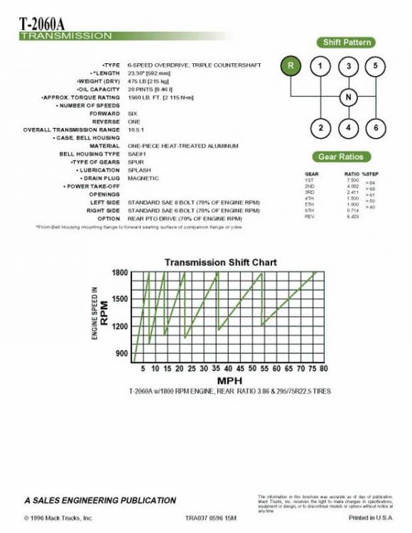

My main question at the moment is the ratios. Originally I had T2090 with 40% steps between the shifts and now T2070 installed with about 70% which is not what I like. So that unit with 6 speeds in the main box might be a compromize. Depending on the step lenthes and the top gear ratio.
Thanks the great Jim, that's what I was looking for.
Interesting that the overall length of the transmission (798mm) is almost similar to T2090. The overgear ratio is also similar - 0.71. Definitely looks like T200 and T300 series have a lot of things in common. But too probably many parts of the content could be found different.

That's what i keep in my mind. Originally my truck had T2090 and I would keep it but the sliding clutched got worn during the years of unexperienced driving. Locally I could find T2070 with 0.60 overdrive and put in the truck. Affordable but the gear spacing is up to 70% what is too much for Econodyne E6-350. Fast overdrive is good but one more gear between the direct and the over is required. My current idea is to try fixing the 9-speed using parts off the 7-speed but that newer 8-speed unit could make the deal too having the steps of nearly 60%.
