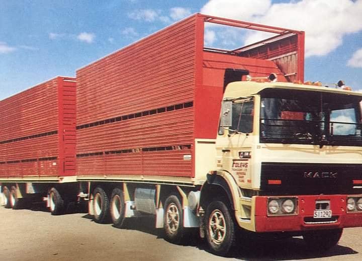

I'm more intrigued by that Folding front wall in the Top deck of the Front Crate..!!
Can't for the life of Me See the reasoning for It... one thing though. that French poodle would be huffing & puffing up a Sweat when It's got 2 Decks of Cattle in It..
Hayseed, the only thing I can think of is it’s maybe to reduce wind drag when emtee?
Yeah, Timmy. That thought had occurred to Me As well..!
