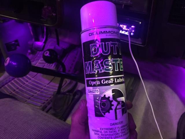

Don't know? You have a Lawson Dealer near you? I put in my order, Lance (salesman) submits it to be delivered to my house, arrives in 2 days (from Chicago) and I get a bill at end of the month.
https://www.lawsonproducts.com/Drummond/Duty-Master-Open-Gear-Lubricant/DA6250.lp?_requestid=408398

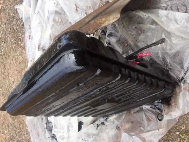

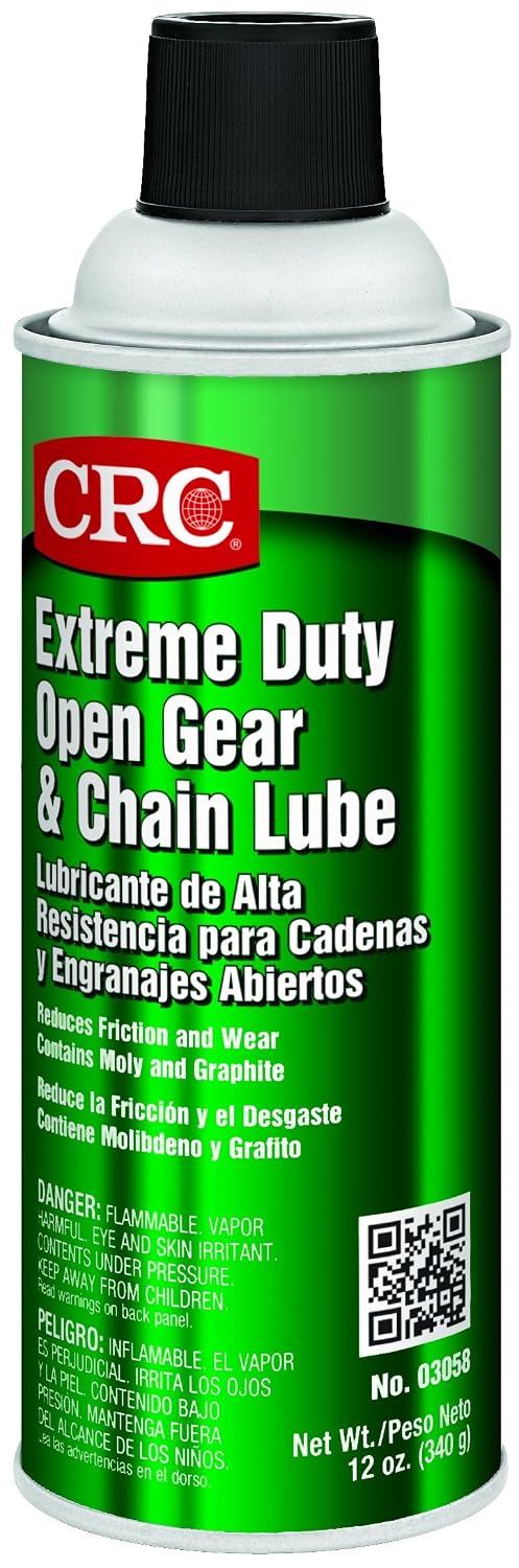

There are multiple kinds and they are completely different. I tried three different brands. Lawson sells 2 dissimilar types, one thin and then the stuff pictured. Some like CRC Extreme Duty Open Gear and Chain Lube have the consistency of smooth butter with no real tack. Wasted a bill on it, not very good, rubs and washes off.

The Duty Master won’t creep, it will draw and pool, but not creep into fasteners as described. I also keep it off my wiring, can’t afford to experiment.

I've used the Lawson product on open gears in the past and it works well. If you get a truck up so weight is off the suspension and spray the spring leaves, they run quiet and work much easier. The rep used to stop by a couple of the shops weekly for clips and such and it was always really convenient. A little spendy at times for some items but they certainly have a lot and want to ensure you are happy is what I've found.

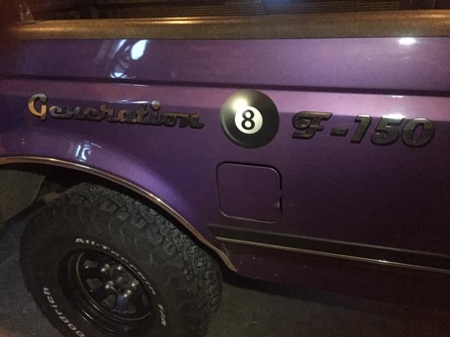

Funny with your original photo as I have a fresh "13" pool ball for the shifter, and an "8" for the steering column adjust in my RL-755LST model I have yet to install.

Whats a three pack of that Drummond stuff run? I have to create an account and log in blah blah blah.........Would like to coat the underside of my 1500 Ram.
Sells in a three pack of 20 OZ cans for $28.99. The guy I buy from is 715-564-3328, straight shooter. You will pay the shipping.
It was the "8th" generation F150, so I picked the theme. My favorite vintage for general build, spec, etc. Keep putting the same driveline, engine, comp, harnesses, and diff gears into new versions of the old chassis since 2004. Motor is on it's third life.
Nice theme. My grand daughter would absolutely love the color. Put a LOT of bedsides on that series due to rust under warranty from Ford in the 90's.
Grandpa always called someone whom was different an "8 Ball", so was wondering how you cabbaged onto the theme. Once upon a time I installed higher end billiards tables so retained a high quality set of balls and had both mentioned earlier to fit shifter handles eventually. I've had them since about 1979 or early 1980.

As far as interior spraying.....I sprayed the interior of the doors.....That wept from the rain drains (onto the low door jamb), a little at a time, for almost two years in the heat of direct sunlight and will want to stick onto the wife's pants when she hops in, so avoid that mistake. In places where I couldn't properly direct-spray the underside i used a weed sprayer to inject a mixture of waste oil. Places like the up side of the inner wheel well canopies.
initially I bought a cheap roll of vapor barrier plastic for when I left it in the garage. It doesn't drip for very long and stiffens up. As mentioned, direct sun can thin the tar a bit.
