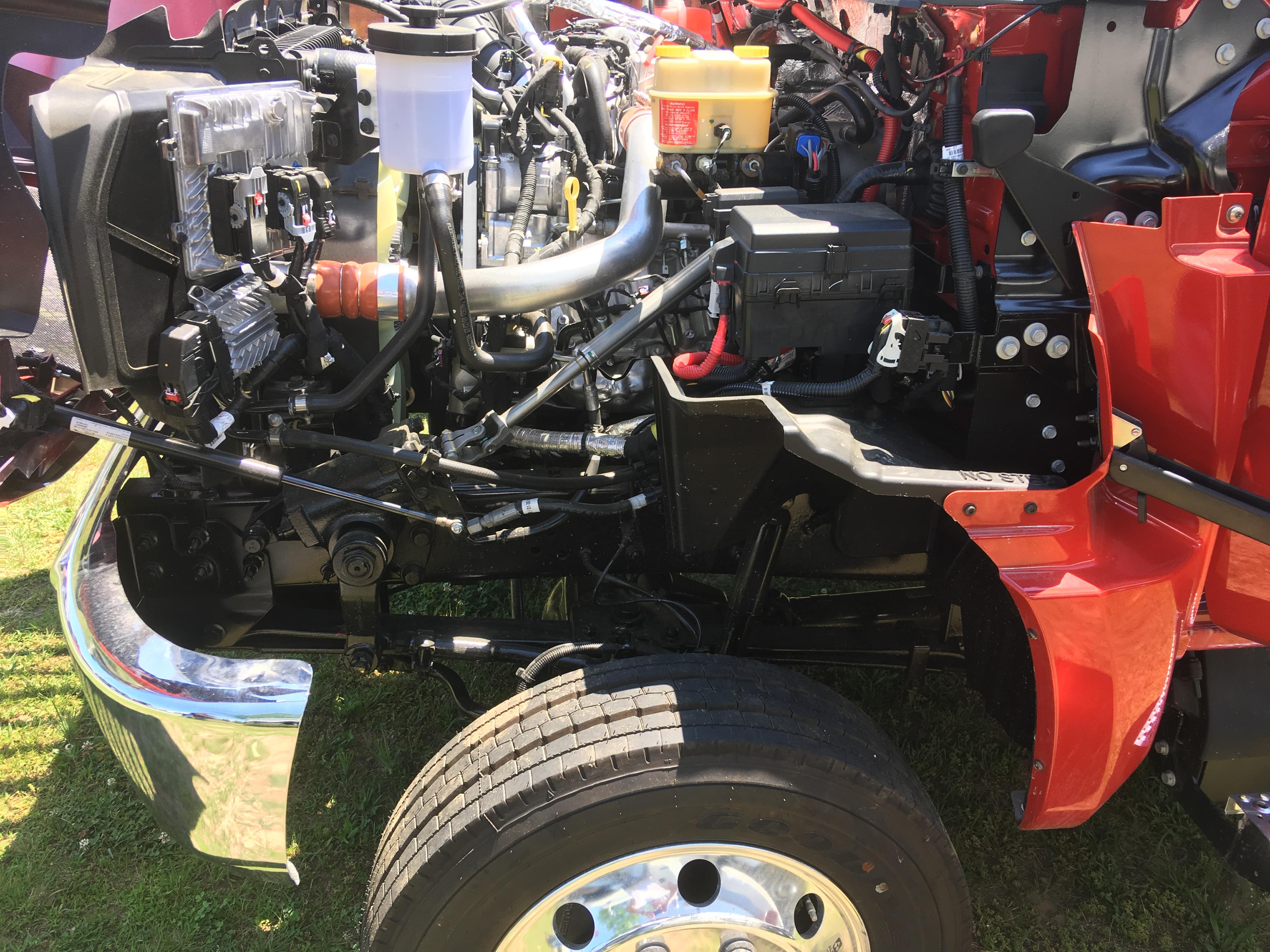

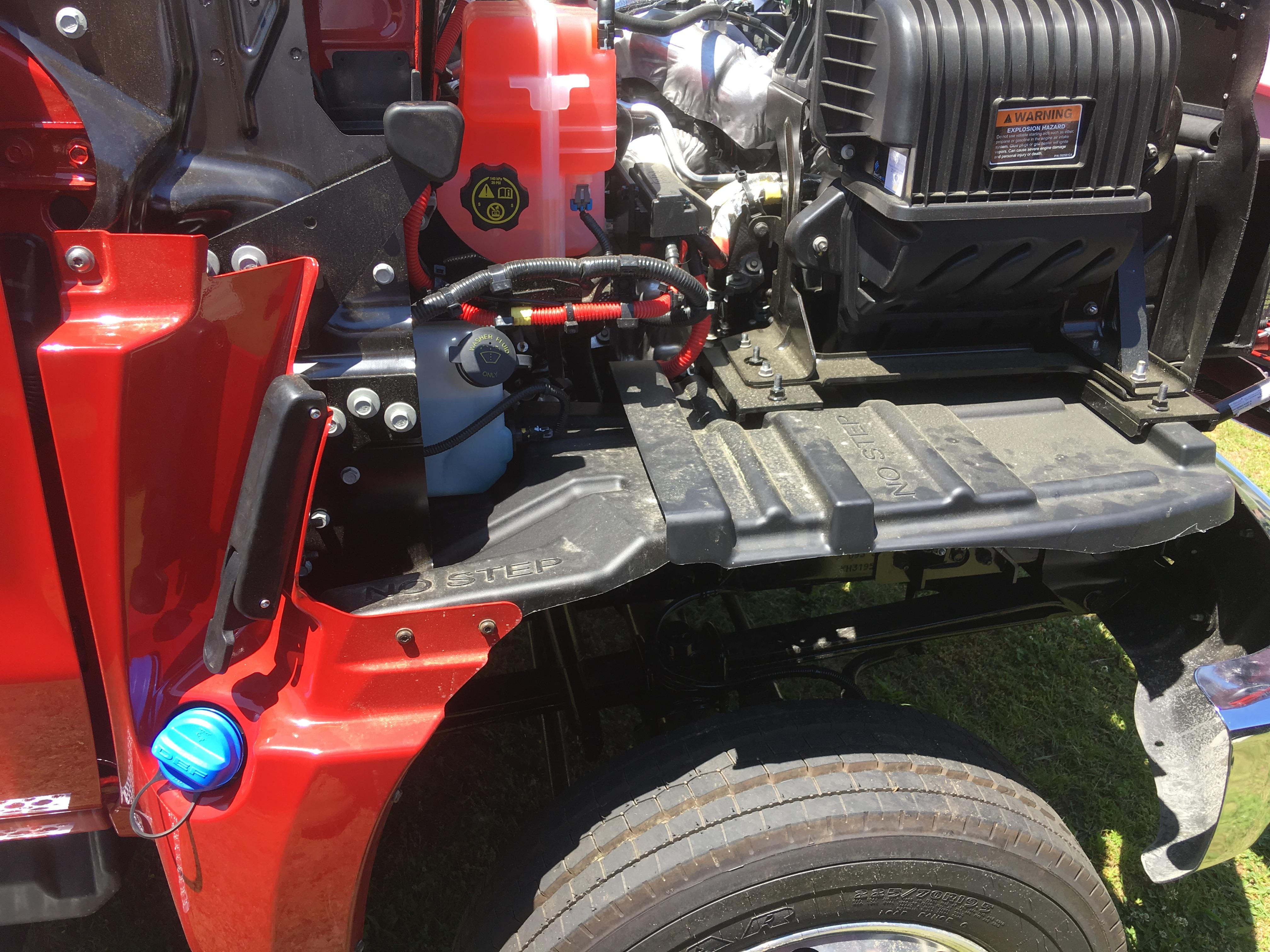

These are pix I took at  a show.  Still looks "crowded" but a V-8 is a V-8.  and for sure better than a PS in an F-550.  Ford and Dodge have to get with it and come up with a tilt hood.  Even the Cummins in a Dodge looks crowded.
11 hours ago, kscarbel2 said:
So Bob, users are going to spill AdBlue (DEF) all over the right fender. Poor design.
Well when I saw that my only concern is what area of truck is most susceptible to accident damage?  I would say front end and in particular right front.  I did see Roadway's positive view that the body guys are less likely to mess with it vs the typical rear of cab chasiss location but I think it makes most sense in close proximity to fuel fill.  I'm sure soneone will say- "yeah but then someone is going to put diesel in it" but given the color of the cap, that should not be a real issue unless someone has a booze or drug issue🤪
