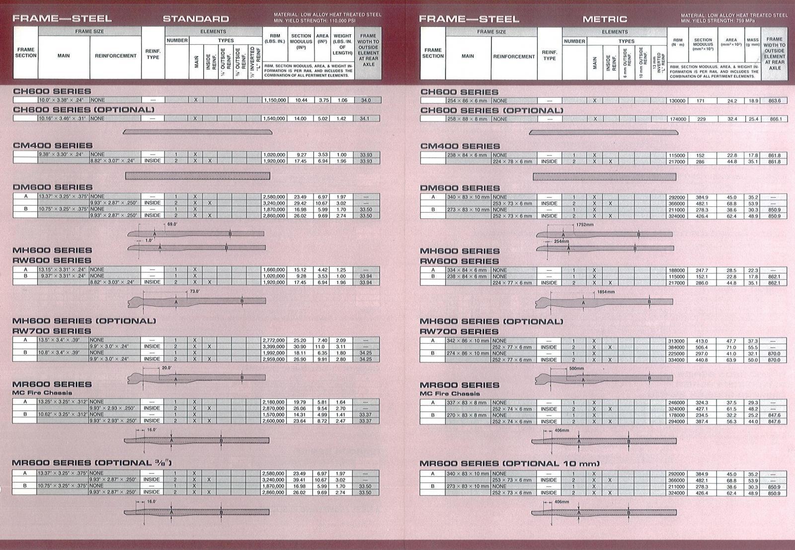

Similar frame rails. Not exact. Very few bends and curves in comparison to other models Mack offered.  R series style cross members used.
The table is what I used for reference. Just didn't post. As you see CH has 10" rails and I suppose pre-2004 Vision either. CM had 9.27 as printed in the pdf file and the table points out 9.38. So there's a mess already. I may suppose the rail section was the same channel as CL600/RW600 rear portion of the rails had. 9.27 could me missprinted 9.37 or vice versa and 9.38 as just approximated 3.37. Interesting point are the CM rails SAE 1/4" 6.35 mm or metric 6.00?
BTW the table shows 0.24" thick steel both for CM and CH. But it shows the same figure for MH/RW. At the same time two of my MH's have 6.35 thick rails and one of them is as late as '91.
