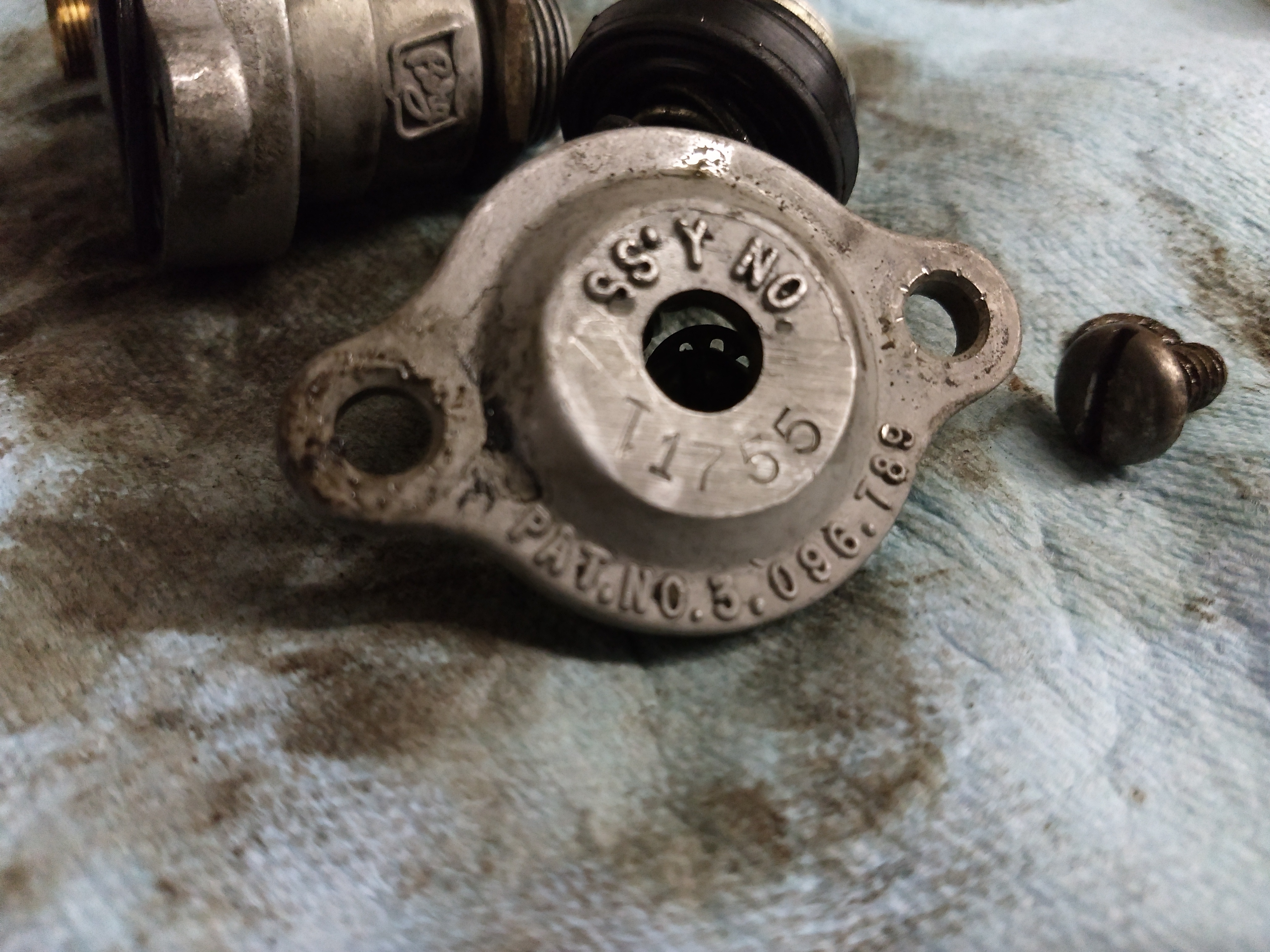

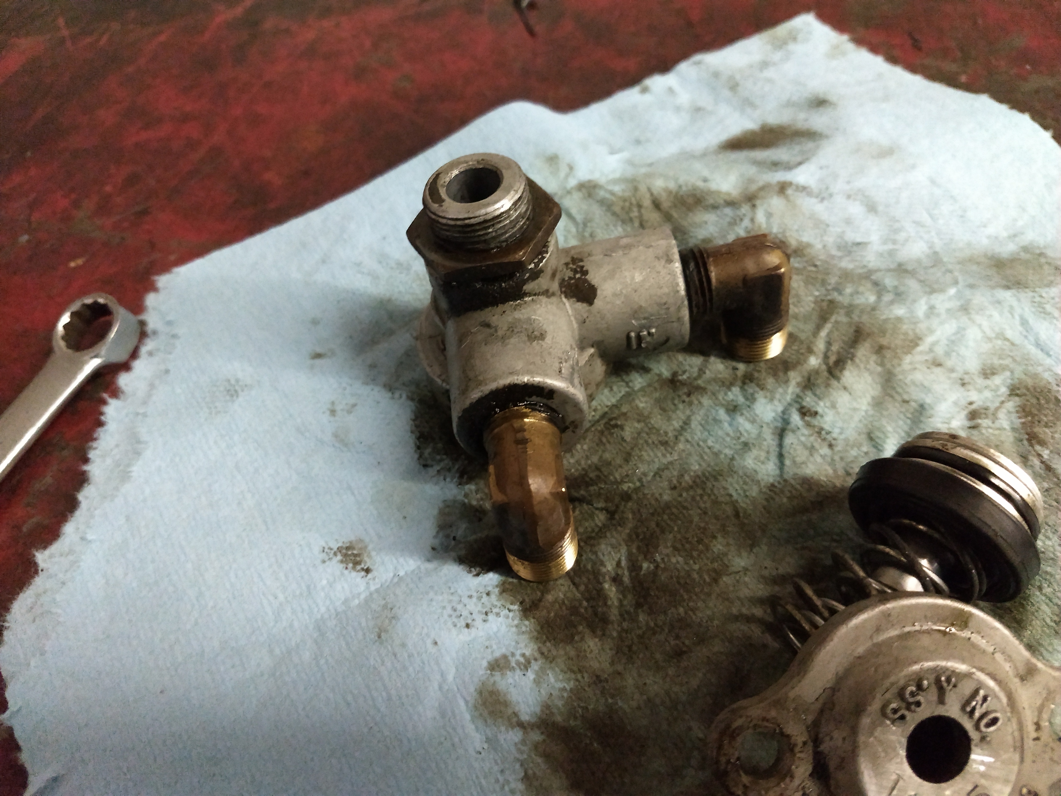

larry    i have some old berg valves  let me look around before you go all new  shoot a pic of what you broke
 Sounds about right?  I need to measure it and see.
It's crazy how it just snapped in half and fell in my hand when I went to release the brakes.
