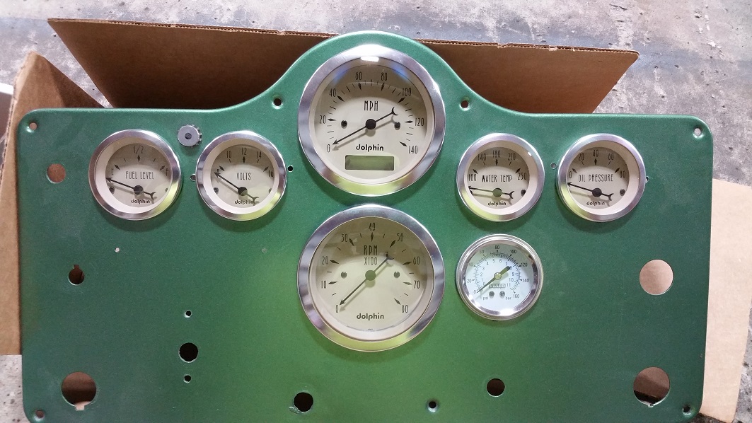

Thanks  Rob  The B color was easy, It was on a post here,  R color has ben more elusive
When I re cabbed my 72 Don at the MACK Museum said the correct color is Mack paint code 808 Light Mint Green. Mack paint code  811 is the Olive color. Both Kirker p/n's
