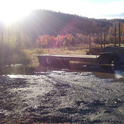

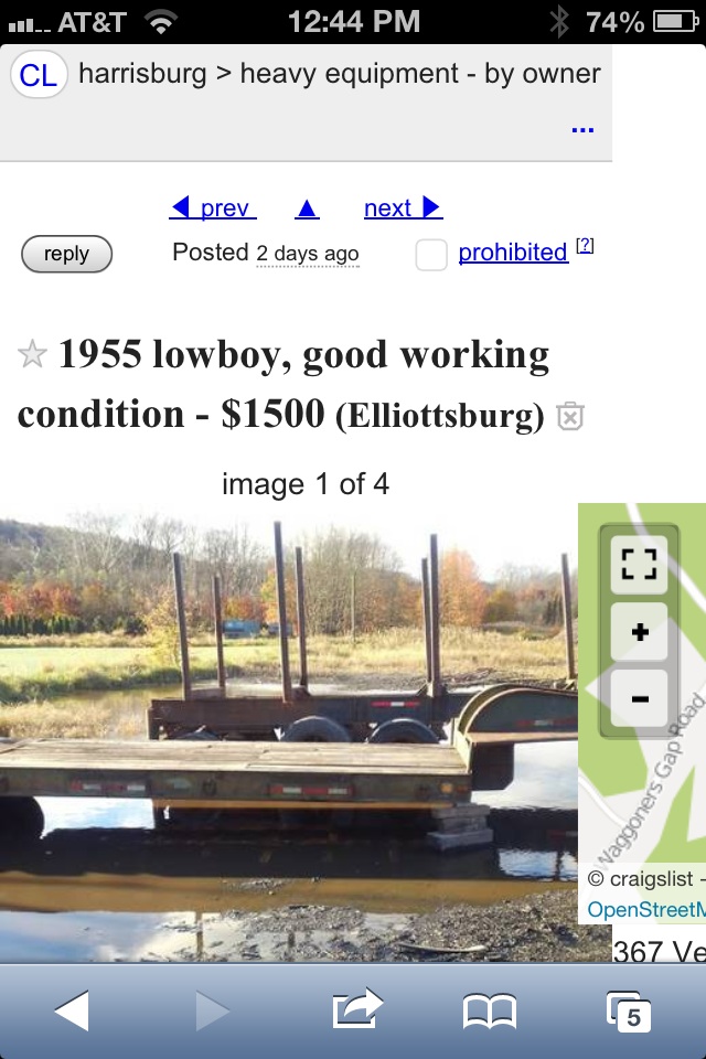

So I bought this thing.
I called the guy and talked with him, his father had bought it new and they used it occasionally. They supposedly had just gone over it making sure everything was good as the ad had said. Seemed like a real straight up guy, so I sent him a check and parked my truck at his yard on our way to NJ fpr thanksgiving. On the Monday after we met up and transferred the title, no problems.
It was all down hill from there, hooked up and only a couple lights, no biggie its old and my wife will be following me anyway. OK, so now no brakes, well I'm empty and my truck has good brakes, is what it is.
So we take off, make it 12 with 250 to go and smoke, damn... you can see what I found in the second picture.
This was after finding a small shop that was open on the first day of deer, I carry tools, just not enough for tearing off a wheel. So chain up the axle and put some grease in the other wheels.
I made it to state college when another starts getting hot. We were 5 miles from the central parts facility of the company I work for, so I drop it off there and we head home.
I ran down the following Thursday and retrieved it with my pickup and gooseneck. I tore it apart and got lucky I guess, no real damage to the spindle and I only needed an inner set of bearings. I'm gonna convert it over to oil filled hubs and replace the hardware for the brakes, along with re wiring and re plumbing.
The trailer is in really decent shape with almost zero rust and is rated for 60K. It'll work perfect for the few times I want to move a piece of rented equipment from work to home.
I wish the owner had just told me the truth about the thing, I would have still bought it just would have hauled it in the first place.
