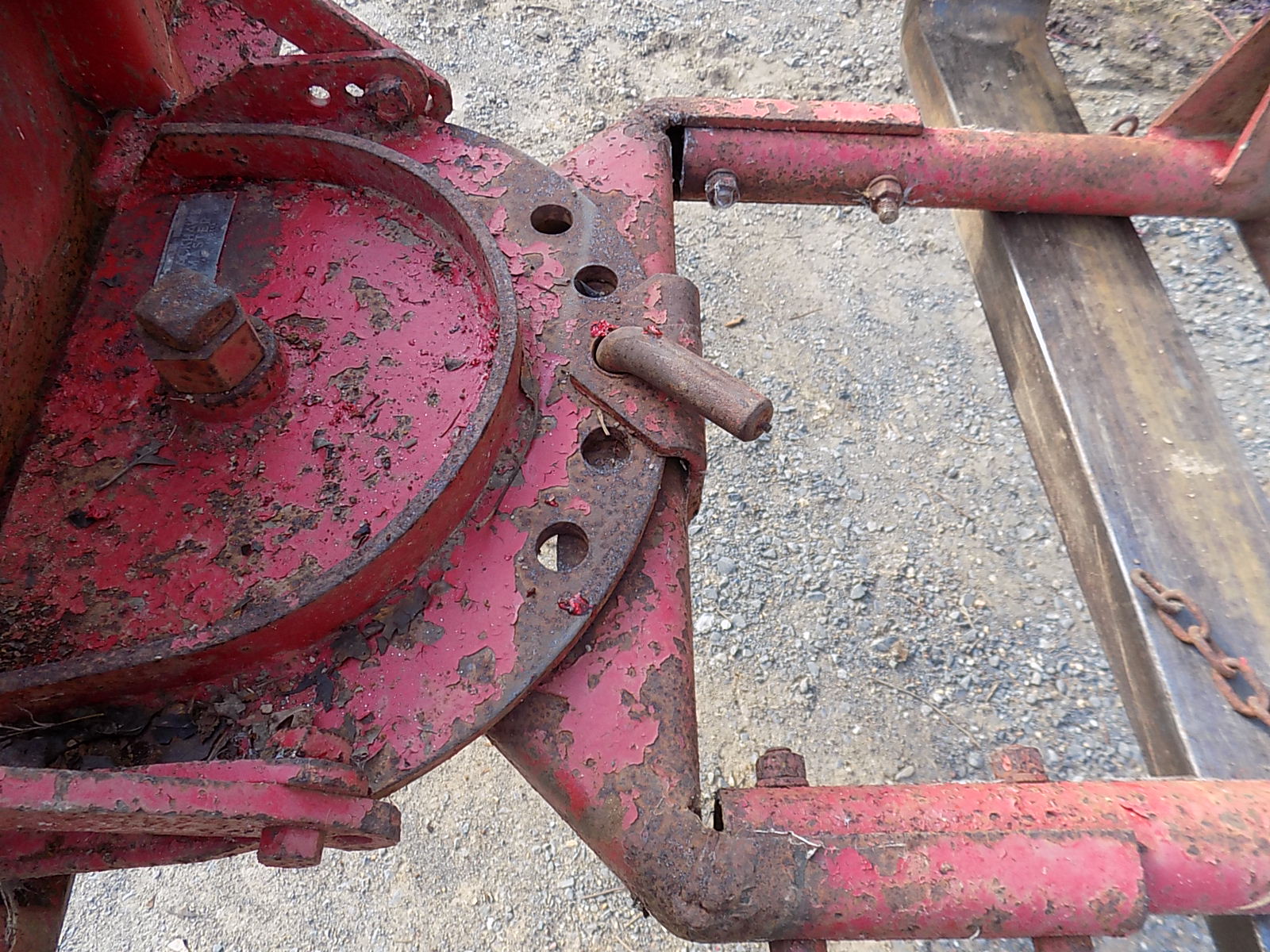

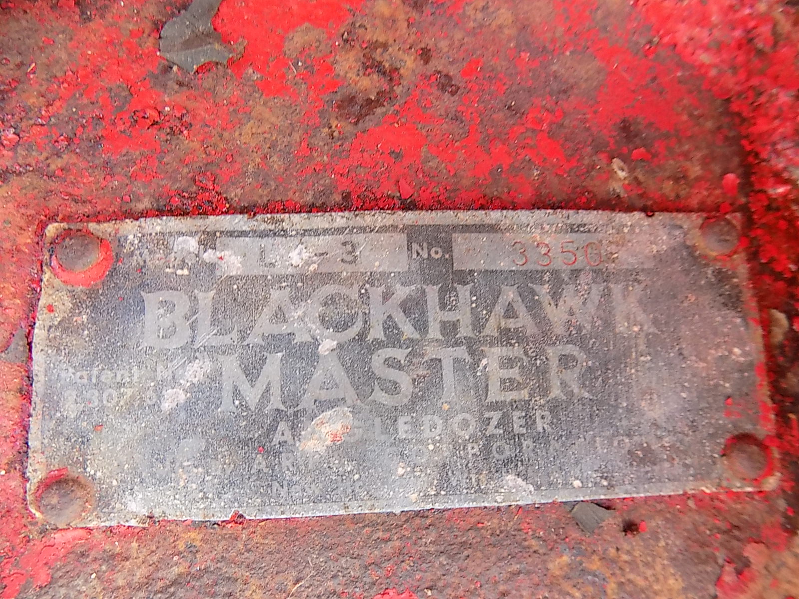

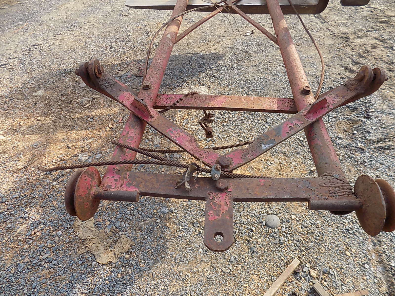

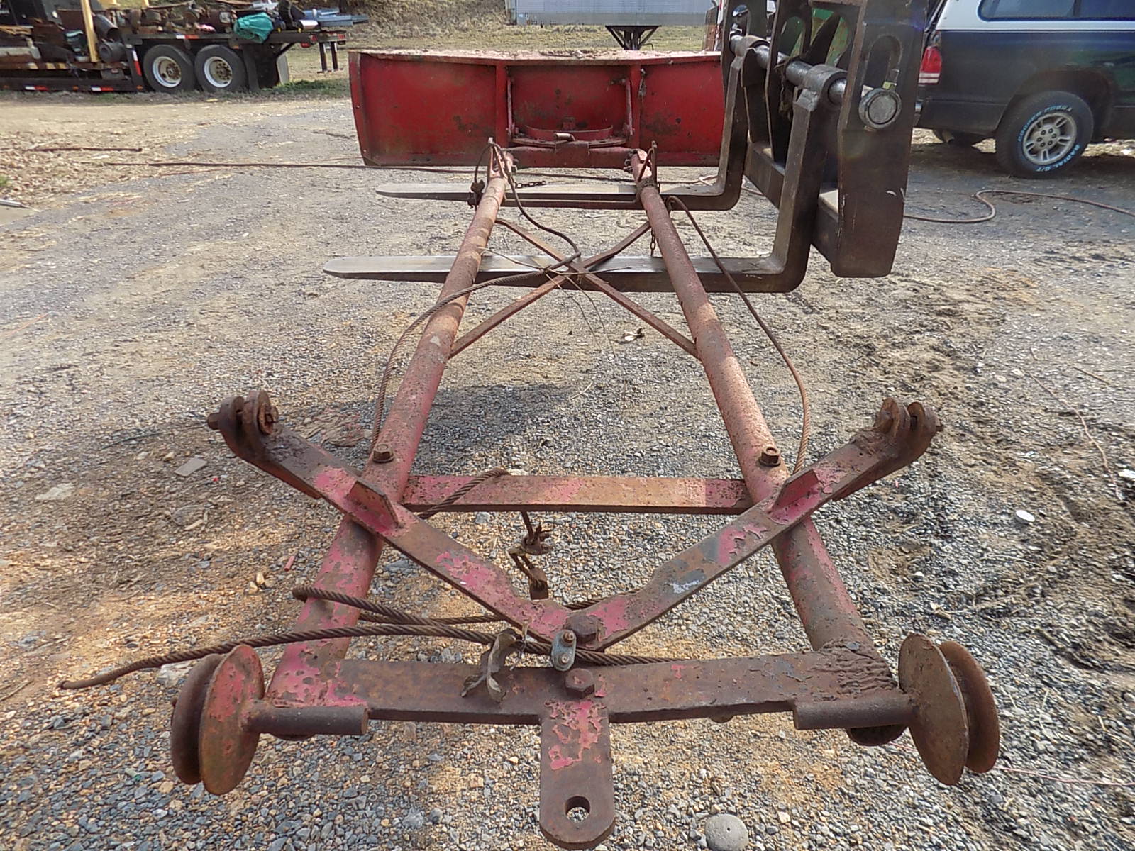

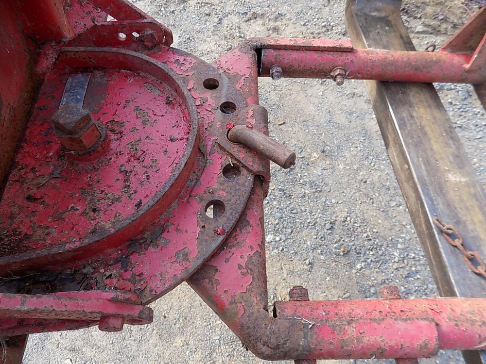

they did make one detroit harvester or dearborn harvester one of those cos. i have one   fits  8n 9n 2n   or mfs, of same size will get ya some pics of it .works off the   3  pt.hitch  would be real easy to copy                        heres a pic. made by blackhawk     i have never tried to use this but looks like it would work for light stuff

The only drawback to the winch would be that you will have to manually angle the blade when you want to change from right to left or to straight. Being able to hydraulically angle the blade makes you much more productive.
The downside to electric/hydraulics is they are amperage hogs. You may need to add a second battery or replace the generator with a higher amperage alternator.

So does the whole frame move to raise the plow,looks like the plow is hard bolted to it?
the whole frame moves up&down  being hinged at the rear axle  there are also parts mounted to the tractor! we have the tractor with all the parts to operate the rig  but as i said i have never tried to use it
