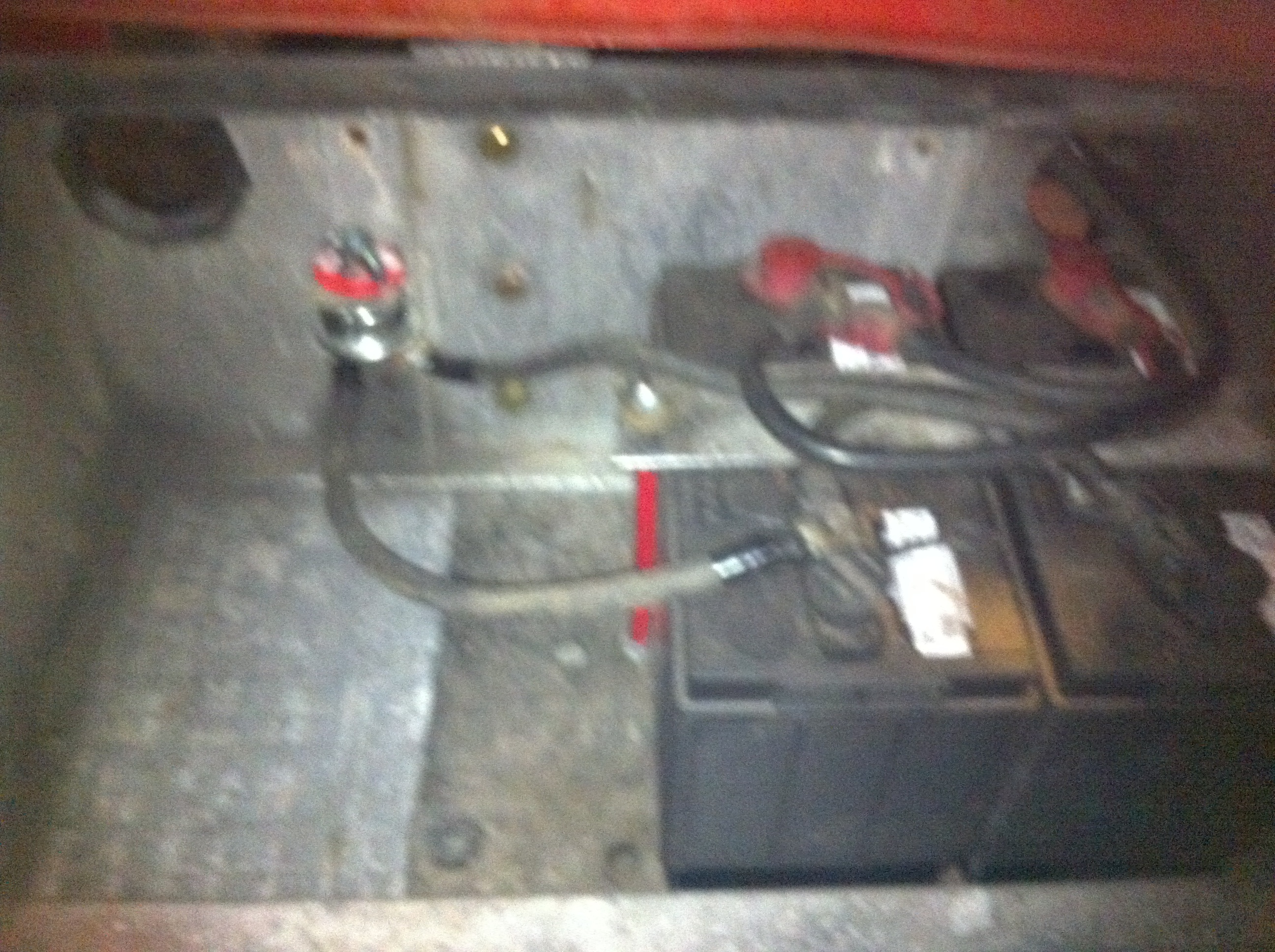

I have my disconnect on the ground circuit.   My switch was $30 from a race car/speed shop.   It's in the ground wire from the battery to the frame.    I only run 2 batteries.      No help on maintainer.     image.jpg

I would suggest getting the largest amp rated version you could find. These are typically for only one battery and once you get 3-4 batteries the current draw could burn it up over time if the contacts aren't large enough to carry it.  Maybe get a pair of switches and break the batteries up into pairs?

You are wise to place a disconnect on the batteries for safety and durability reasons. I would place the cut off as close to the battery as possible on either leg of the circuit (positive or negative). This will cut down on the chances of having a hot cable shorting out while the truck is unattended.
