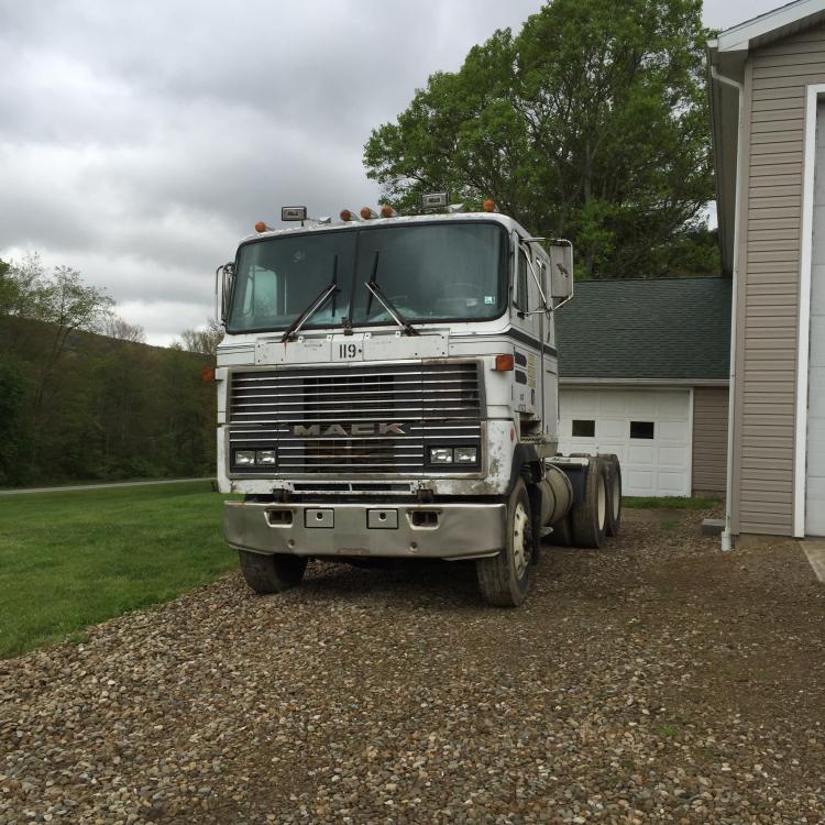

2 hours ago, carlotpilot said:
does`nt look all that bad
It looks better I the picture than in person. Frame is spread pretty bad under fifth wheel. The cab would need a lot of work. Everything under cab is rusty.
You have the entire running gear so I'd say swap it in, truck is well worth the time and effort in my eyes.   Paul
