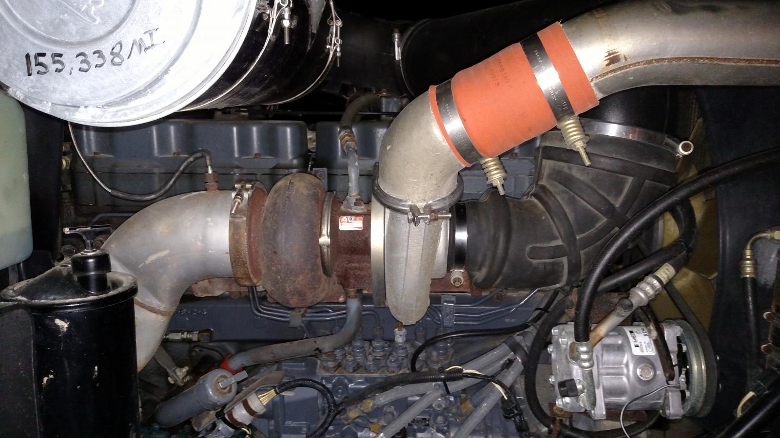

Hey guys its been awhile since i have been on here.
As some of you may know, i have a mack e7 350 mechanical engine with bigger injectors and a turned up pump.
The truck is a lot faster than it was in stock form.
I feel like the missing link to everything is that i am shoving a ton of fuel to spin a tiny turbo. The turbo i have is a Schwitzer S300 and according to specs its only supposed to see boost levels from 24-32 psi. I now get 30 psi by 1300 rpm which is great because the power is effortless now but i feel that i am maybe just wasting fuel. I have experimented with using half throttle all day and only taking it to 1500-1600 rpm on the higher gears but it didnt seem to really matter on fuel economy. It only makes sense to me that if i am already using a set amount of fuel based on injector size and amount pump is turned up, i would get a benefit to adding more air by getting a bigger turbo.
I was told to get a borg warner 427-460 turbo and i would be happy. If i am already quicker than 427-460 hp mack then i think a bigger turbo would do the trick in fuel economy and more power. I have noticed that with having bigger injectors and a turned up pump that my pyrometer never goes over 750-800 so i know i am good there. Is there any risk in adding a bigger turbo if i already am using the fuel i am using? would it blow a head gasket? I would basically be just getting a bigger turbo that already comes on a mack. I guess what i am trying to say is that i dont see a problem making the turbo bigger when i already have the fuel required to spin the 427/460 turbo. Now if i wanted a bigger turbo and i had stock pump and stock injectors then i could see it being a bad thing but i feel that i am setup for a bigger turbo, boost levels are good, pyro is great so i say why not.
What is the difference in a 350 mack and 427? I have bigger injectors than what come in a 427, i think the 427 has a larger turbo too. So if it already takes a set amount of fuel to spin that bigger turbo on a 427 and im already faster with a smaller turbo then it only makes sense. I was told i can get a borg warner turbo for 1600 and i would need a new oil return line and different intercooler pipe and thats it.
Let me know what you all think

I run a mechanical E7-350 that has bigger injectors, turned up pump and advanced the timing. My pyro was running 1200 degrees and had 35 lbs. of boost. Was told to put on a 427 460 turbo So I did. Best thing that ever happened to it. Now I get 45lbs. of boost and pyro never goes over 1000 degrees loaded heavy on a hot day and it blows the doors off of 460s without thinking about it. the turbo don't look much different than the stock one but it is a lot different. It really helps.

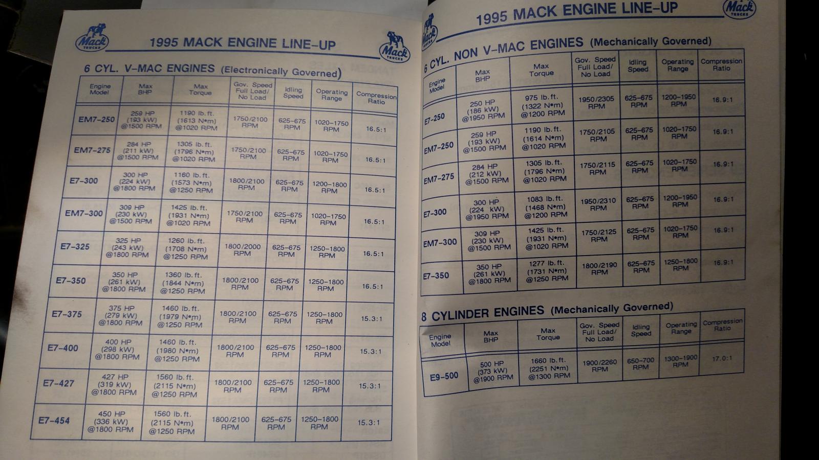

See what a 427 piston part number calls for. I will bet it is different. 400's and higher factory engines used a lower compression piston to allow room for more air. With that said if that is case you will be hard on head gaskets if you have your foot in the throttle alot. I know from experience.

Thanks for the link but this doesn't really answer my question. I was going to put a newer borg warner turbo that is fit for a mack 427/460 to my truck and was just wondering if it was safe. All this shows is that the compression is lower on the 427 and 454, but they also have electronic fuel injection right? I might just call borg warner about it. I m sure there have been others out there that have done much worse than me. Only thing is that i didn't do the typcial 350 mack to 427 mack conversion by just turning up the pump , putting in 427 injectors and a 427 turbo, I have a mechanical pump and i have 30 percent oversize injectors with the stock s300 turbo, also my exhaust is the stock 4 inch. Can more people with real world experience chime in on this please.

This is a turbo for a 460 put on a turned up 350. It builds good bost but it blows head gaskets when i put the fuel to it. I have another truck that is turned up from a factory 400 (lower compression pistons) with smaller factory turbo blows more bost and doesn't blow head gaskets.
