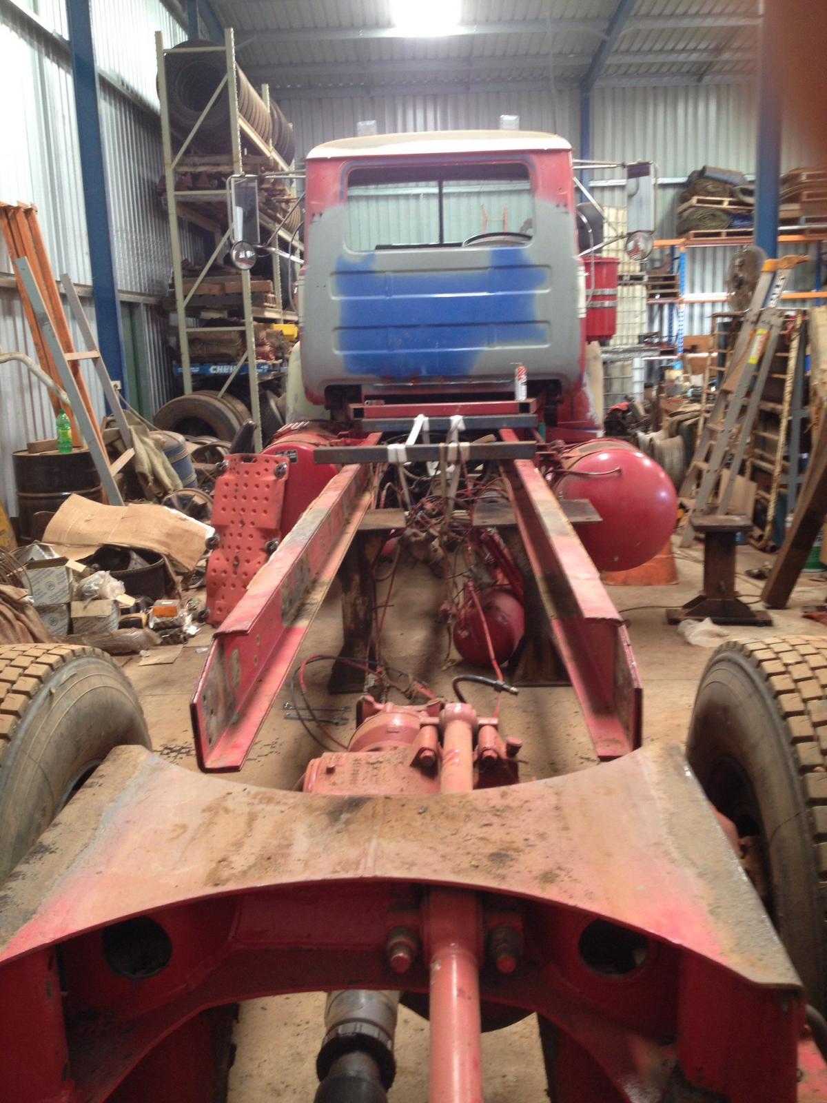

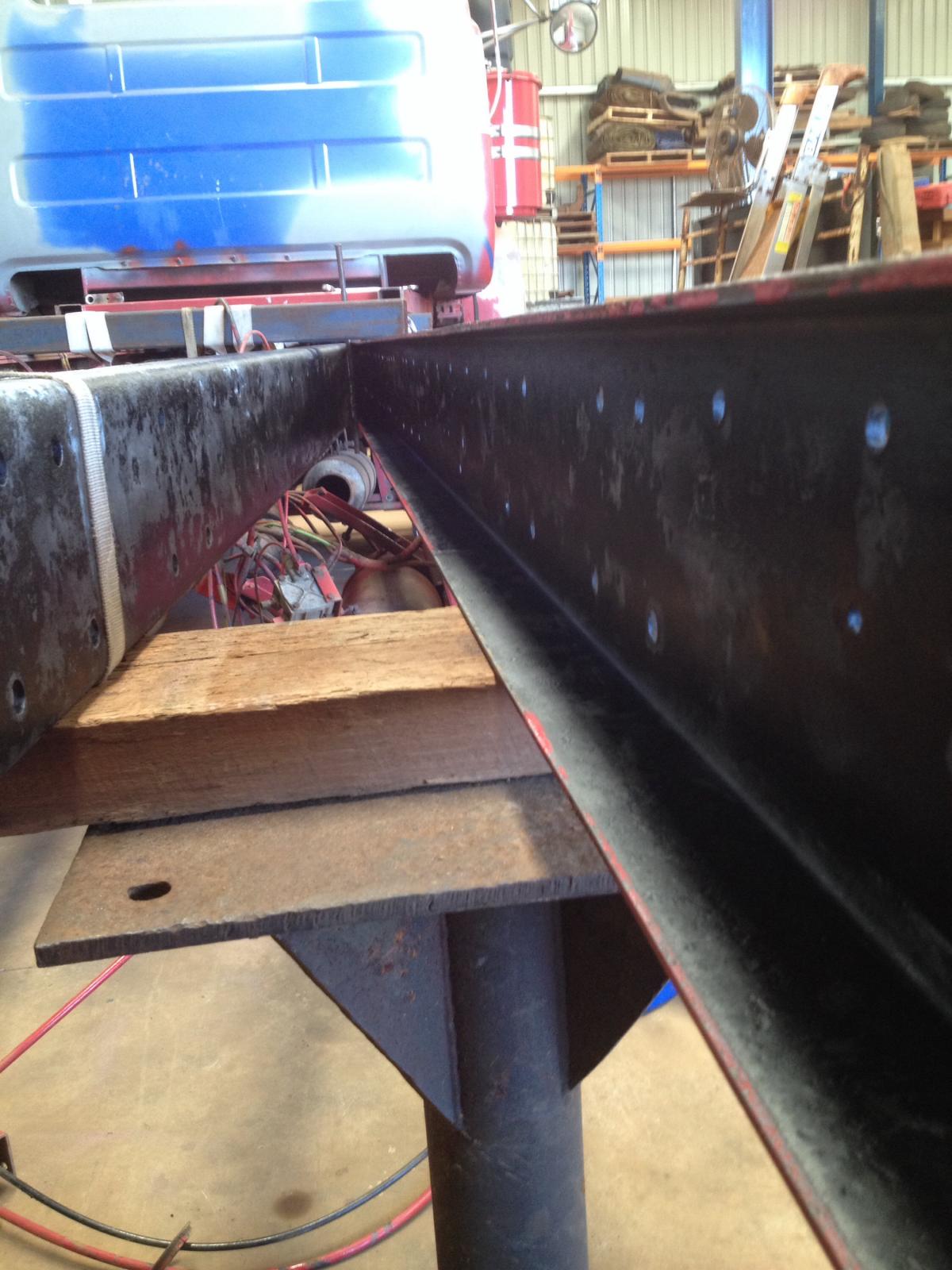

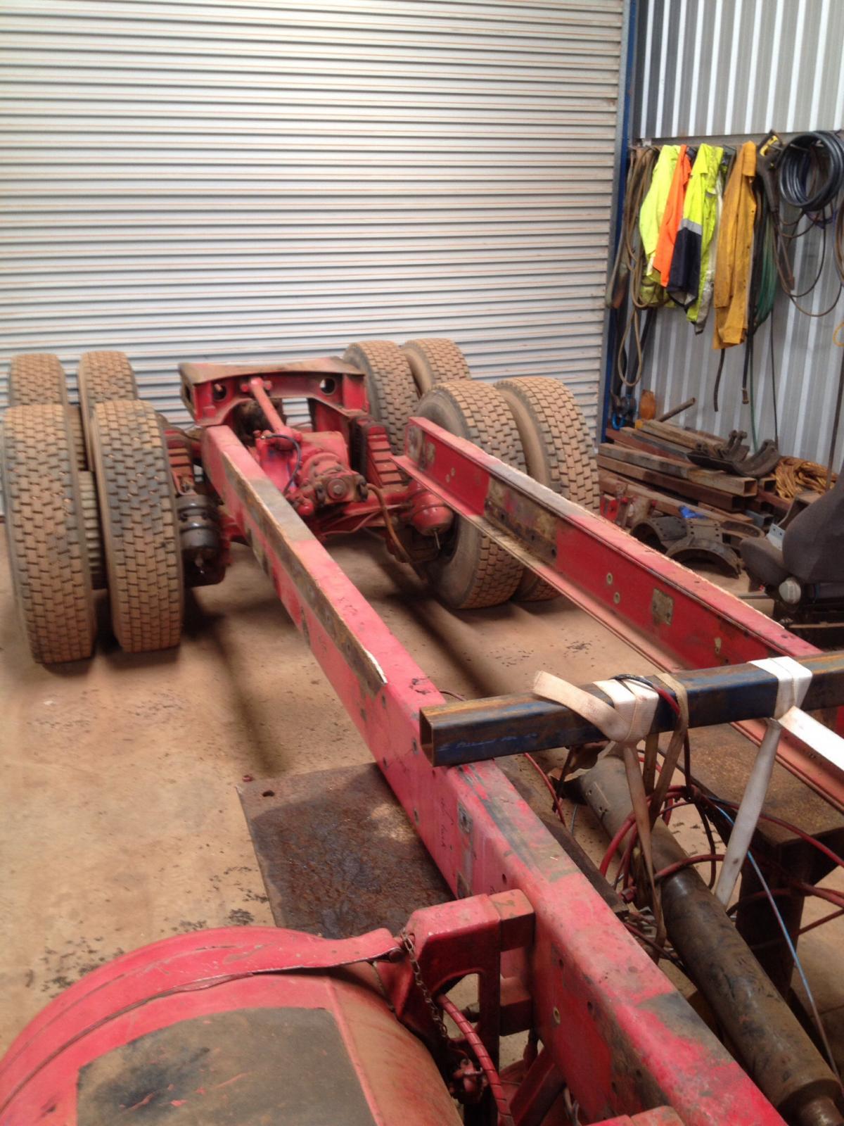

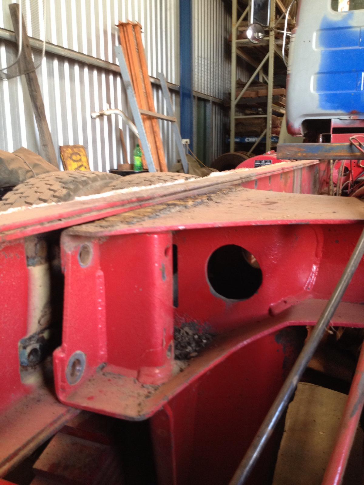

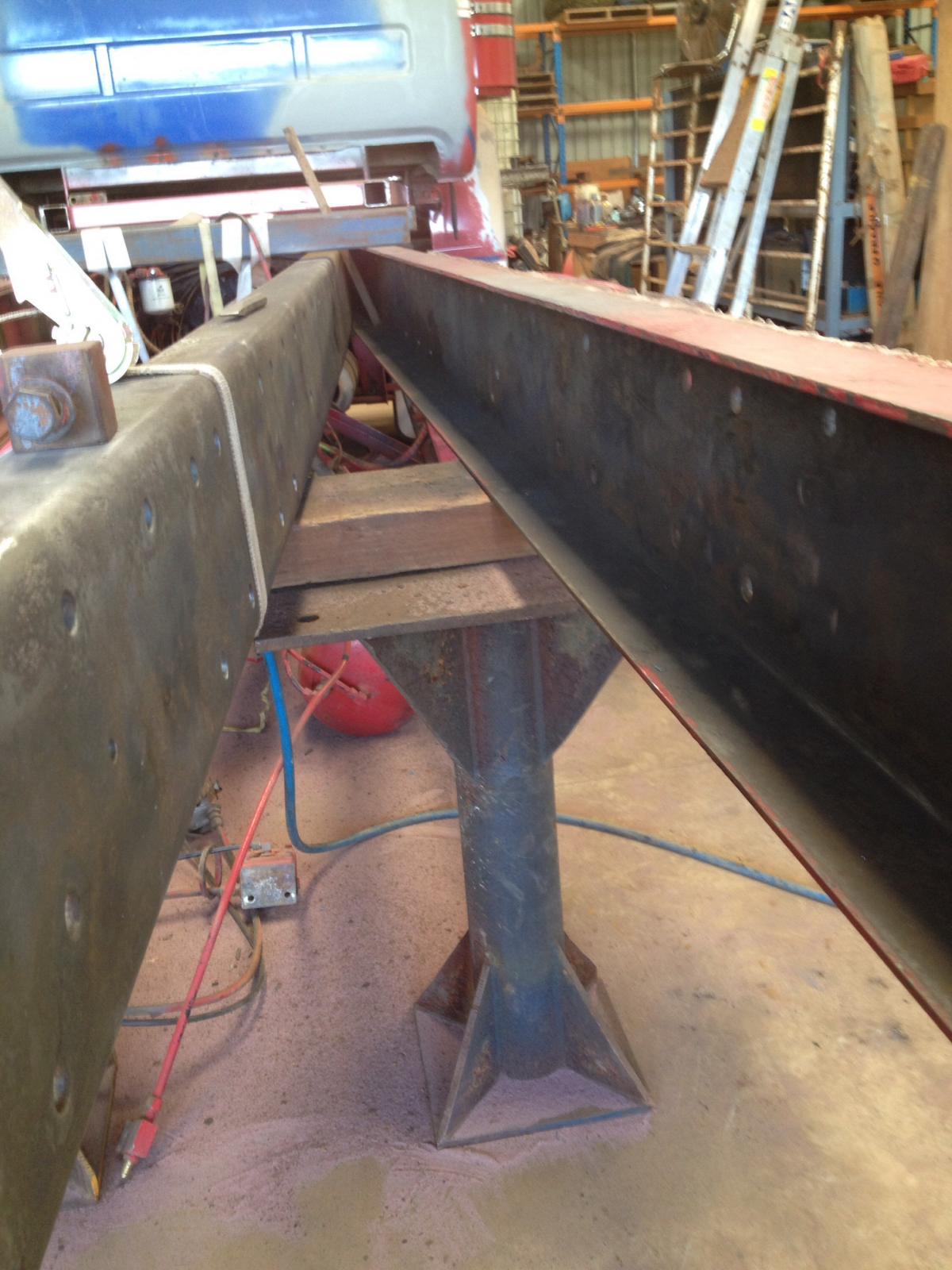

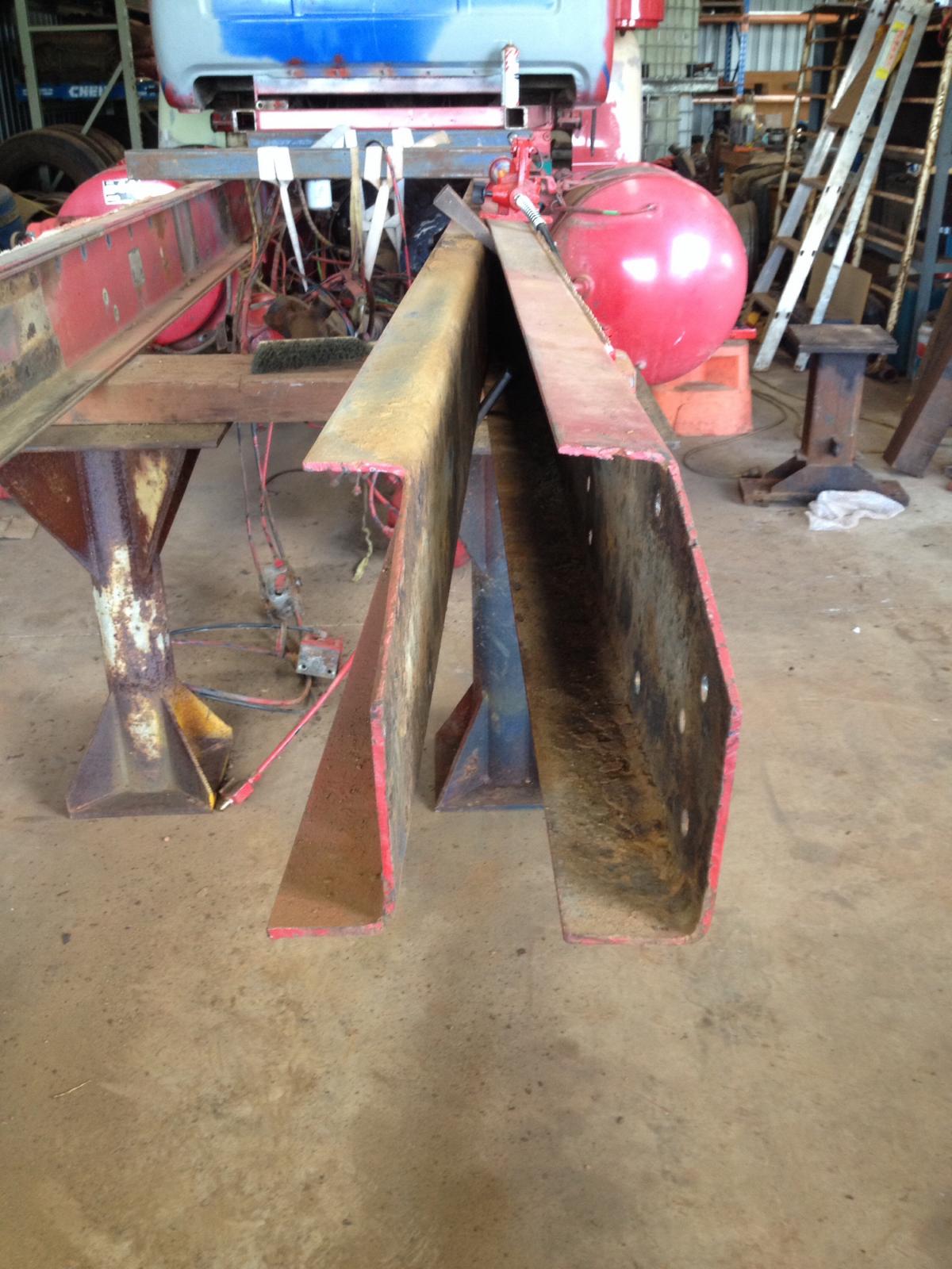

There were a few sections of the chassis that had a bit of growth so we thought we would attack it and try clean it up while we are doing it up.
It didn't look so bad, but when we pulled it apart looks a bit worse then I thought. Anyway, I've been working on this for the past 2 days, I'll keep the pics coming as I continue.

Did Mack paint between these rails when new ? fair bit of work ahead of you there Tim
Paul
Paul, it doesn't look like there was any paint in between the rails. I'm gonna use some rust kill epoxy paint to prevent it from happening again.
I know what you guys are on about, I've seen some pics in here where they have cut them off and welded new rails on. I guess mine is more like a prevention job.

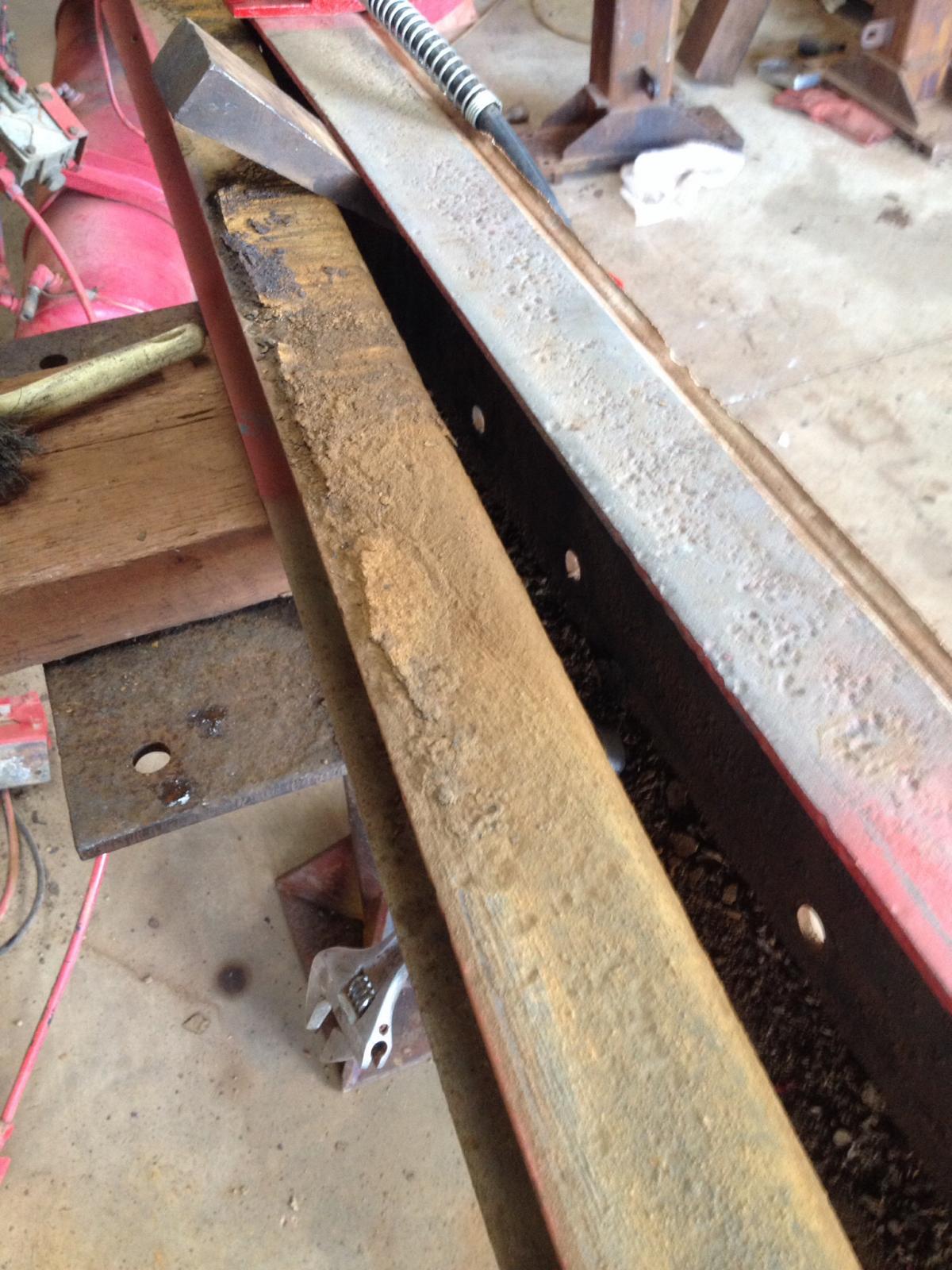

What do people use to fill the pitts left from rust? I know it's purely for cosmetics, but I was thinking of using body filler on them.
post-14557-0-94281100-1405762993_thumb.j
This is it after it had been chiseled, grinded, wire brushed and sanded.

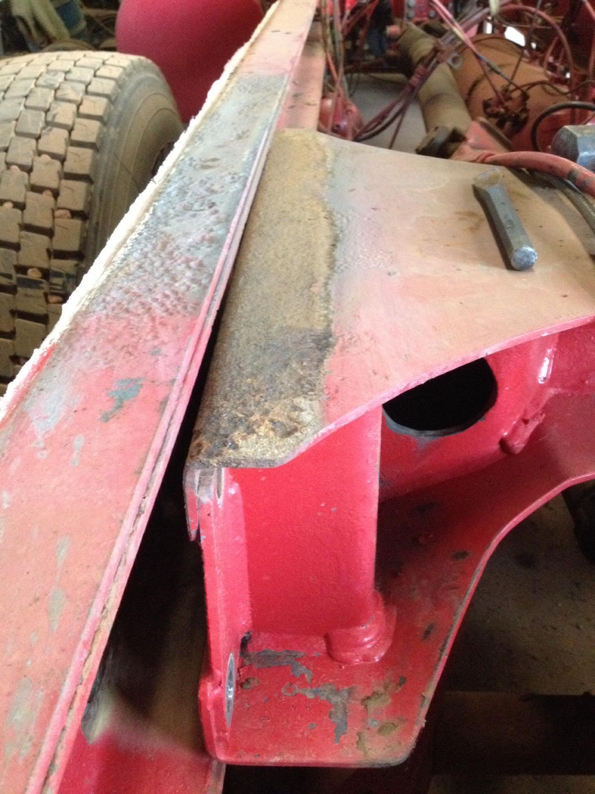

post-14557-0-49289200-1405763271_thumb.j
This is after some rust converter.

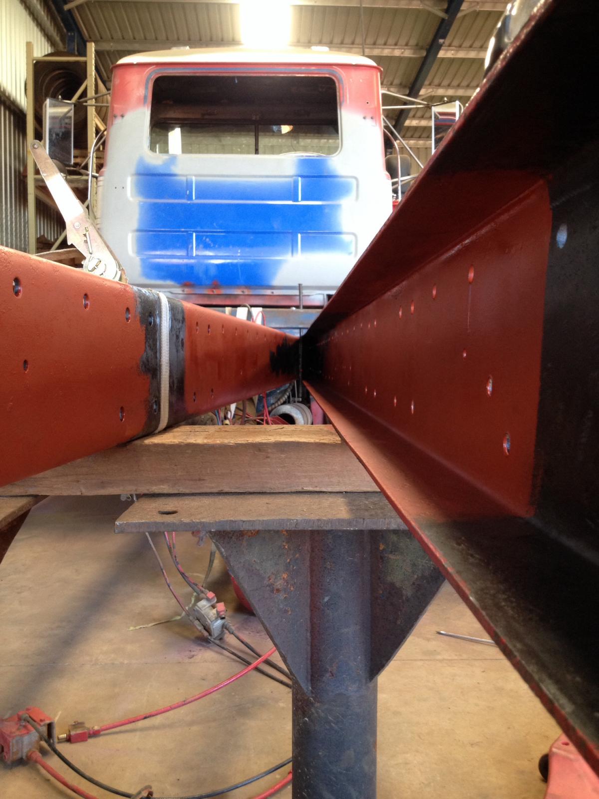

post-14557-0-58528500-1405763348_thumb.j
And applying some paint. I'm using white knight rust kill epoxy. Should be better than nothing...
Thanks Paul. Quiet times allow for a bit more work in the shed. I'm actually really enjoying it, although I've taken my time and there is no dead line. I've also discovered a few tools along the way to make the left hand side a lot easier. Having said that, I wouldn't wanna do this sorta job too often.
Looks done well.
I hope it will work for you longer than original unpained rails.
