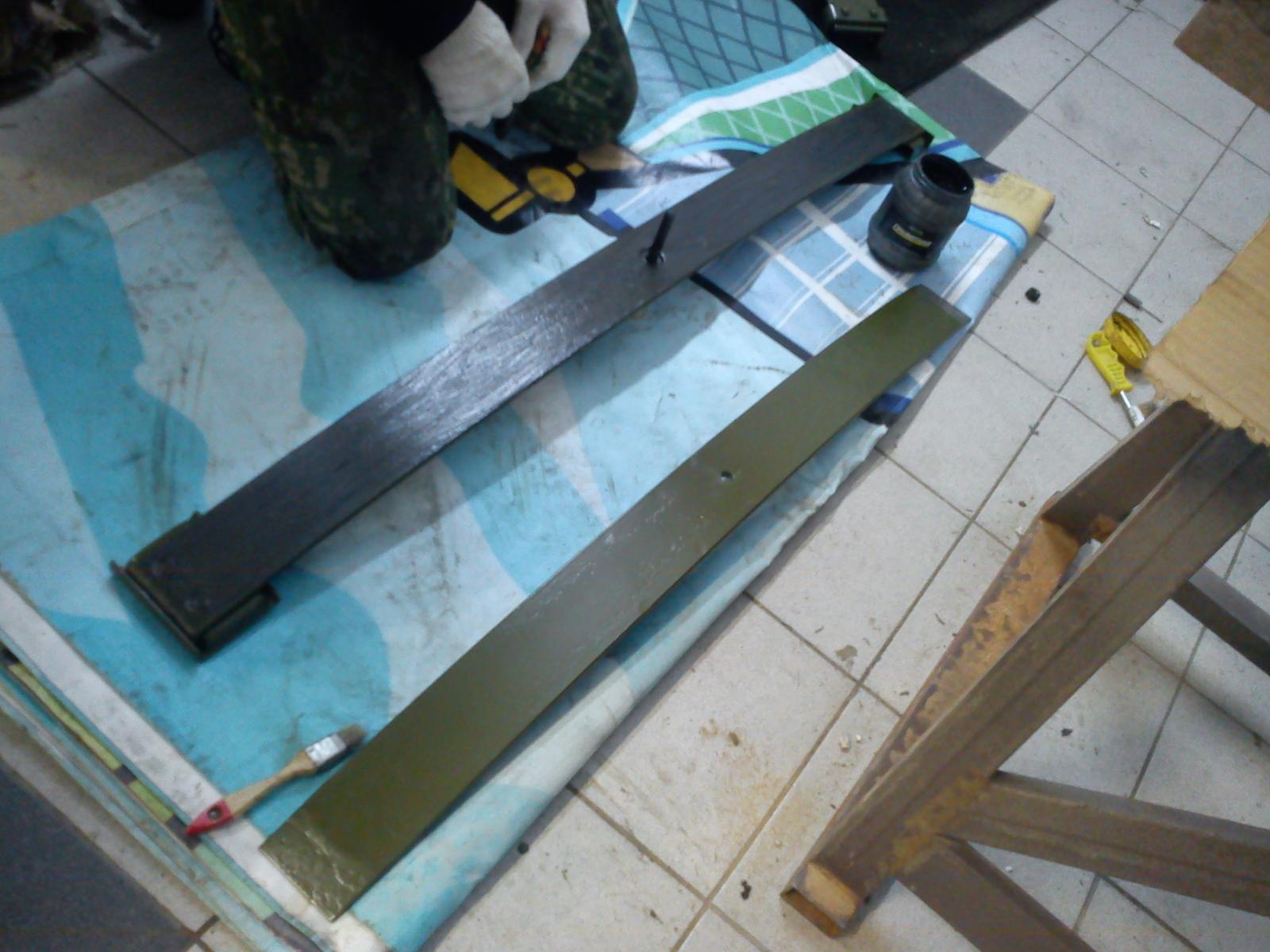

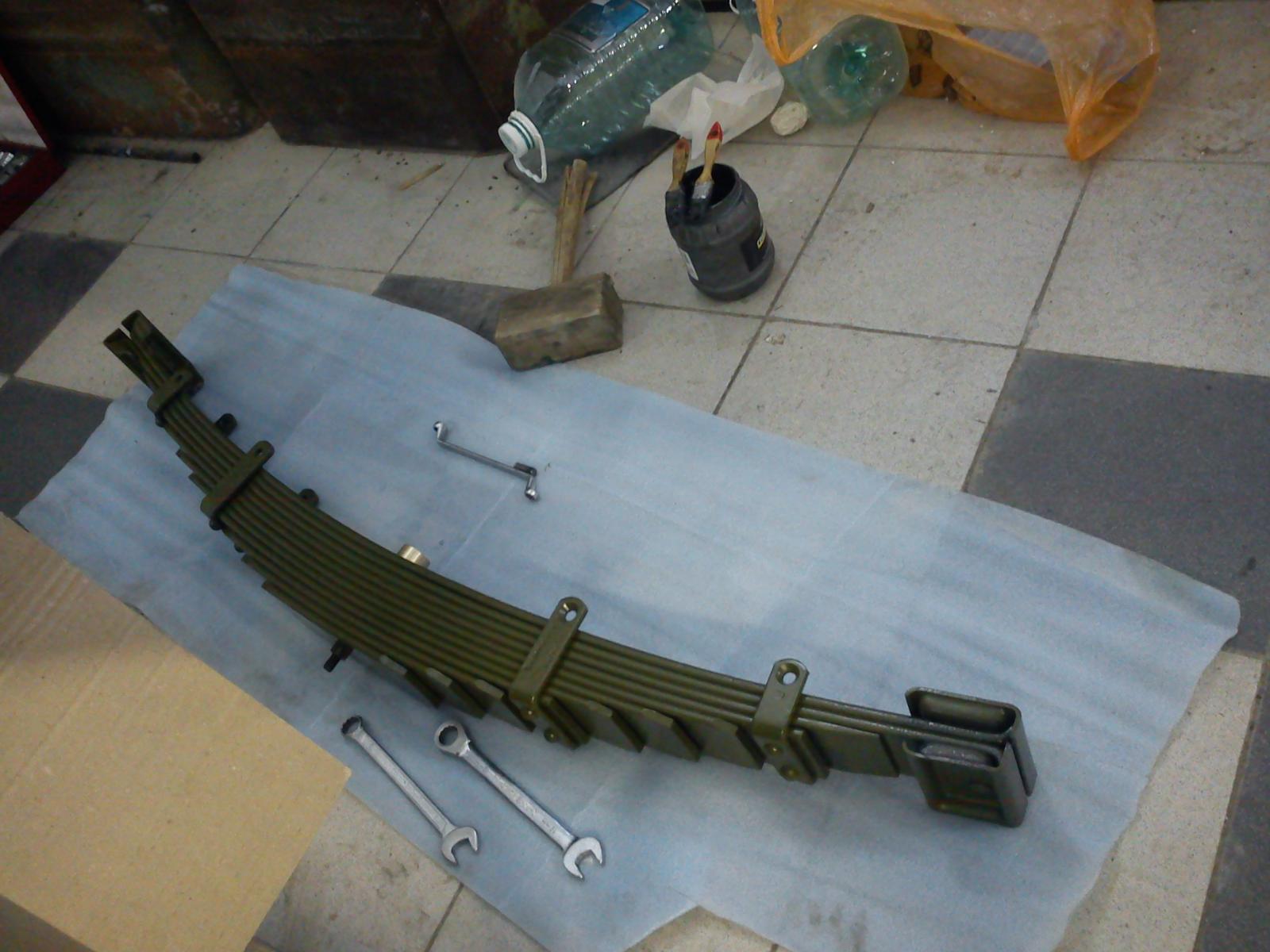

This interesting set up with riveted pads looks strangly familiar to me.
Because I worked out the same stuff in my army truck.
Those rivets didn't make a trouble because were not straight through rivets. Each pad fixed to its own leaf.
I had one broken leaf in one spring in the "project" truck and planned originally to change it.
But when I bought the "spare" truck I first realized to not change one leaf but whole the spring.
And next I resolved to change them springs both to keek them off the same vehicle.
post-3971-0-10709600-1395693262_thumb.jp
post-3971-0-78223000-1395693292_thumb.jp
