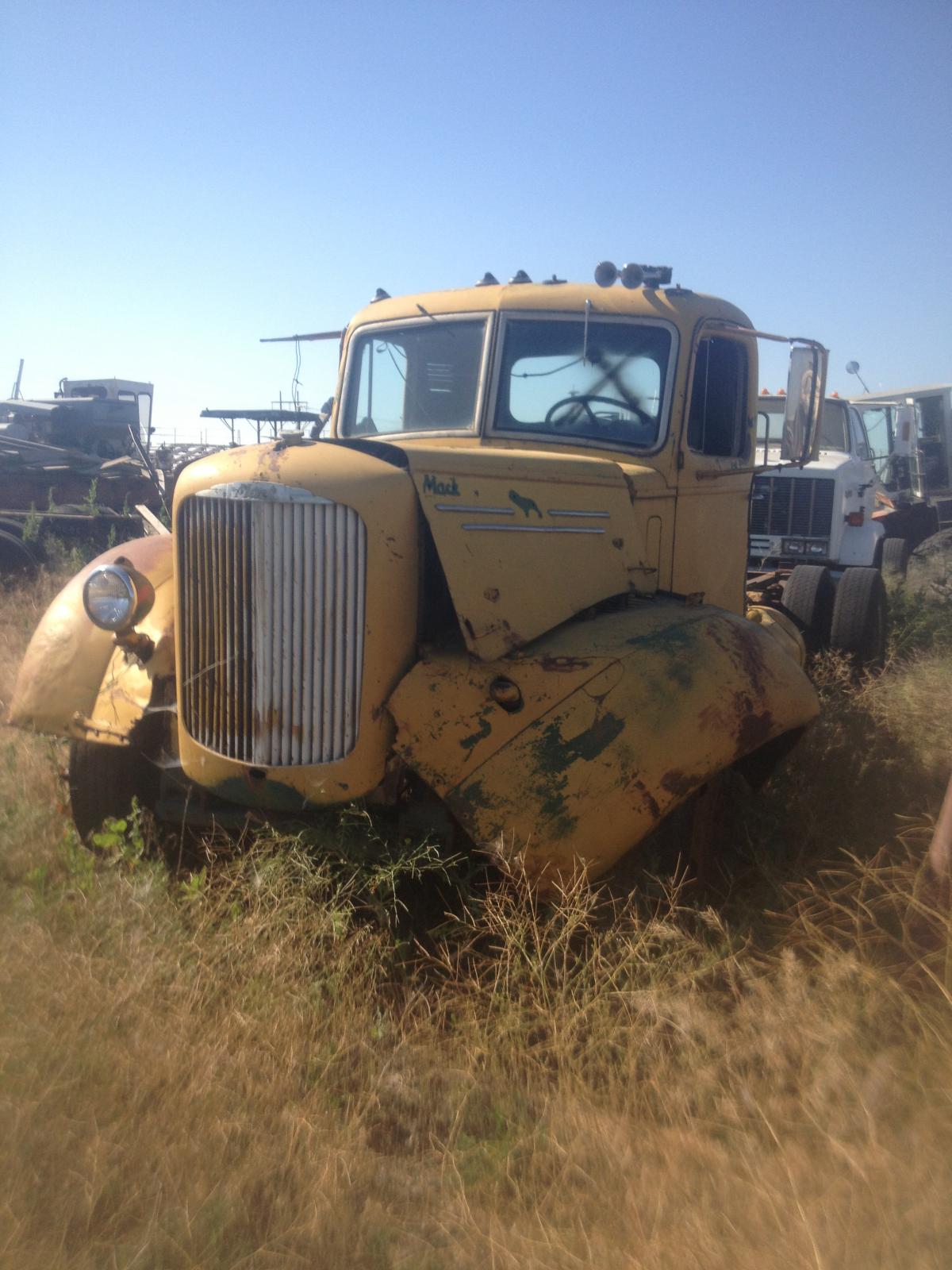

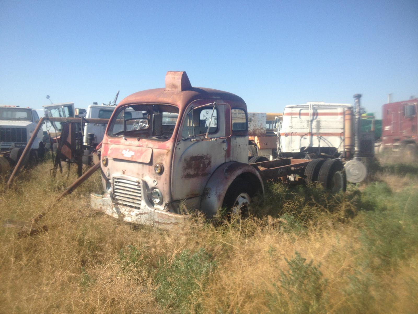

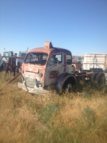

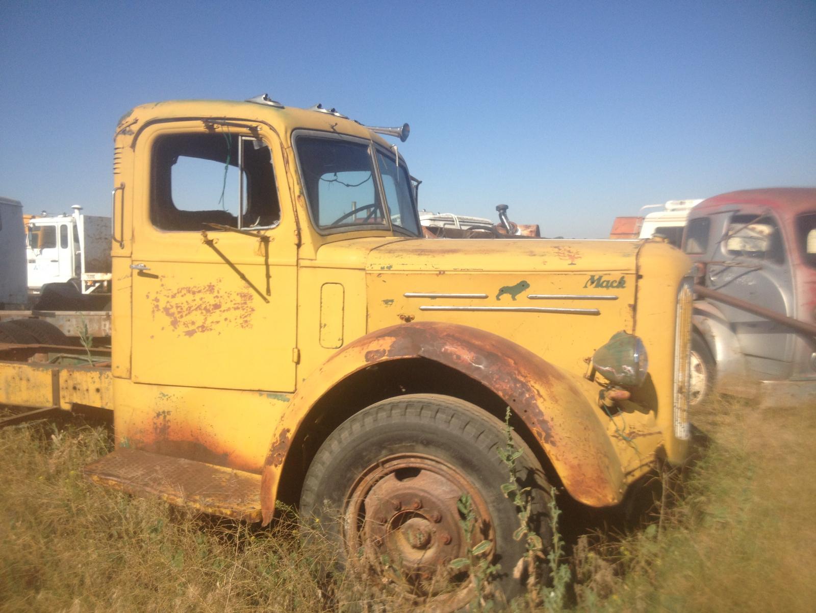

Chasis Number LF2D3575 .. I will look closer tomorrow, the cyl head is missing, I want to sell as i have too many projects now.

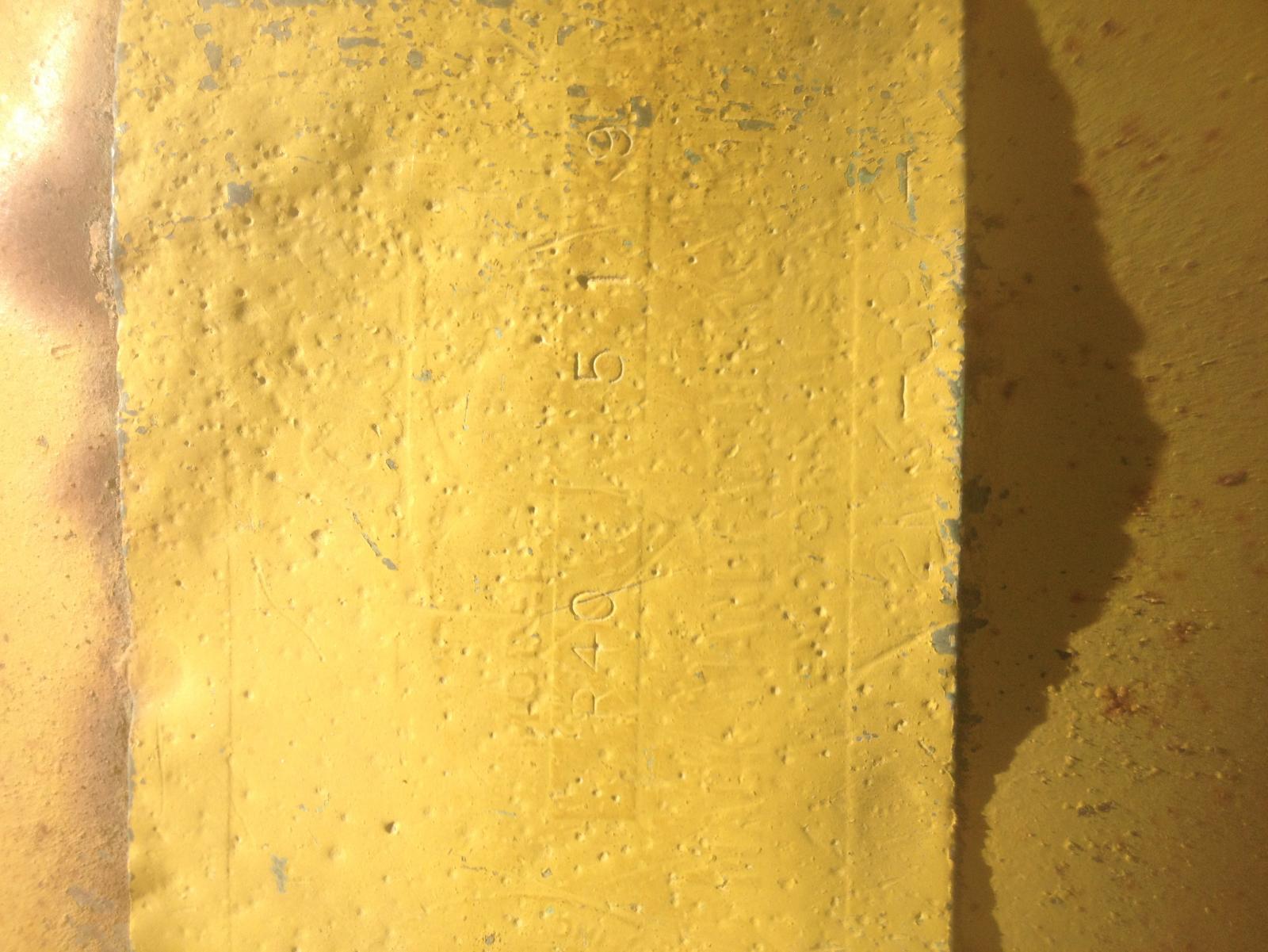

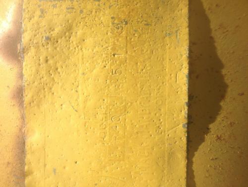

Found sn? in glove box frame .. 37QR531P3 .. single drive axle, one trans, gas engine w/w valves in head which is missing all the rest is there hoping someone wants this project as I saved it from the crusher .. helping a buddy clean up his wrecking yard he has closed to the public.
Thanks for the input i've been looking around for the head there's so must to go thru it may be there somewhere .

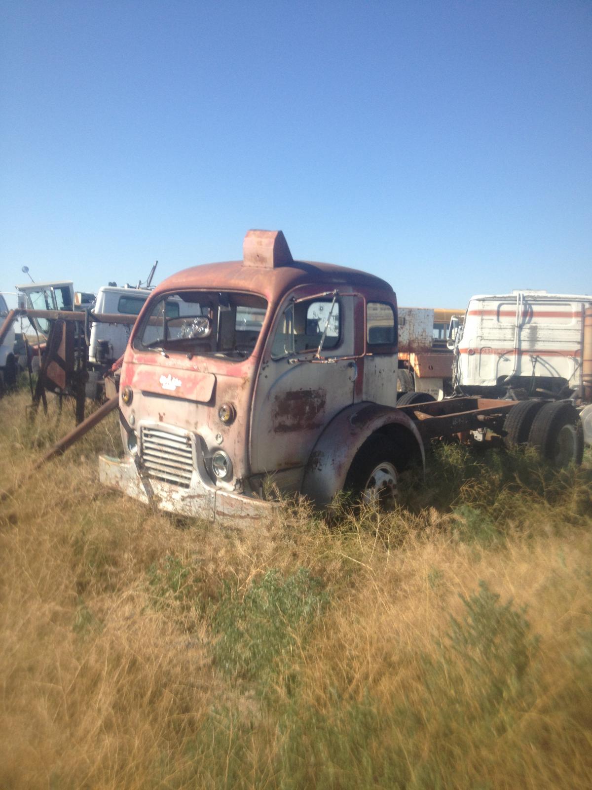

Another prize i saved 1948 White mod 3018 sn-400325 its all there complete aside from seat cushions an windshield .. engine turns over i bet after couple hours i could have this running.
I double it, 37QR531P3 is a Mack part number for shure.
It's a bit strange to me but NR model wich was built too close to LFSW had the chassis number on a left frame rail in front, just above the front spring.
Still haven't seen or heard about any L-models with the same location.

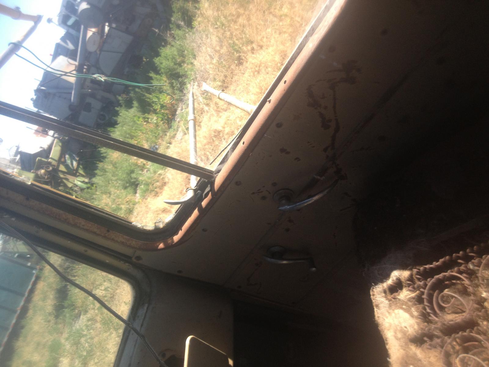

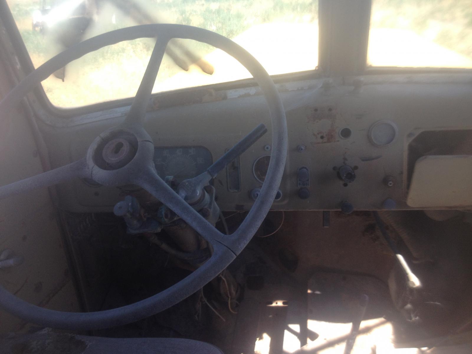

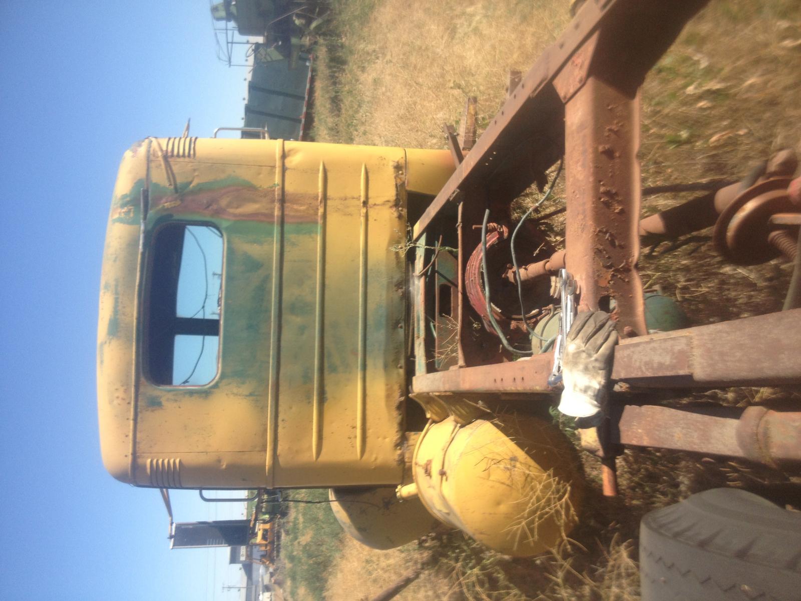

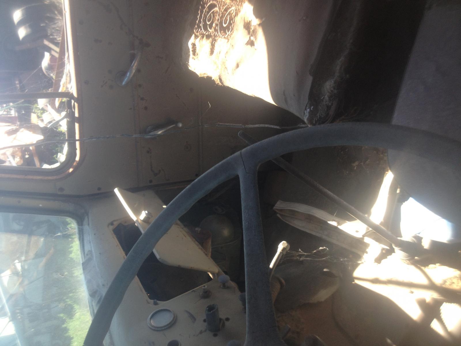

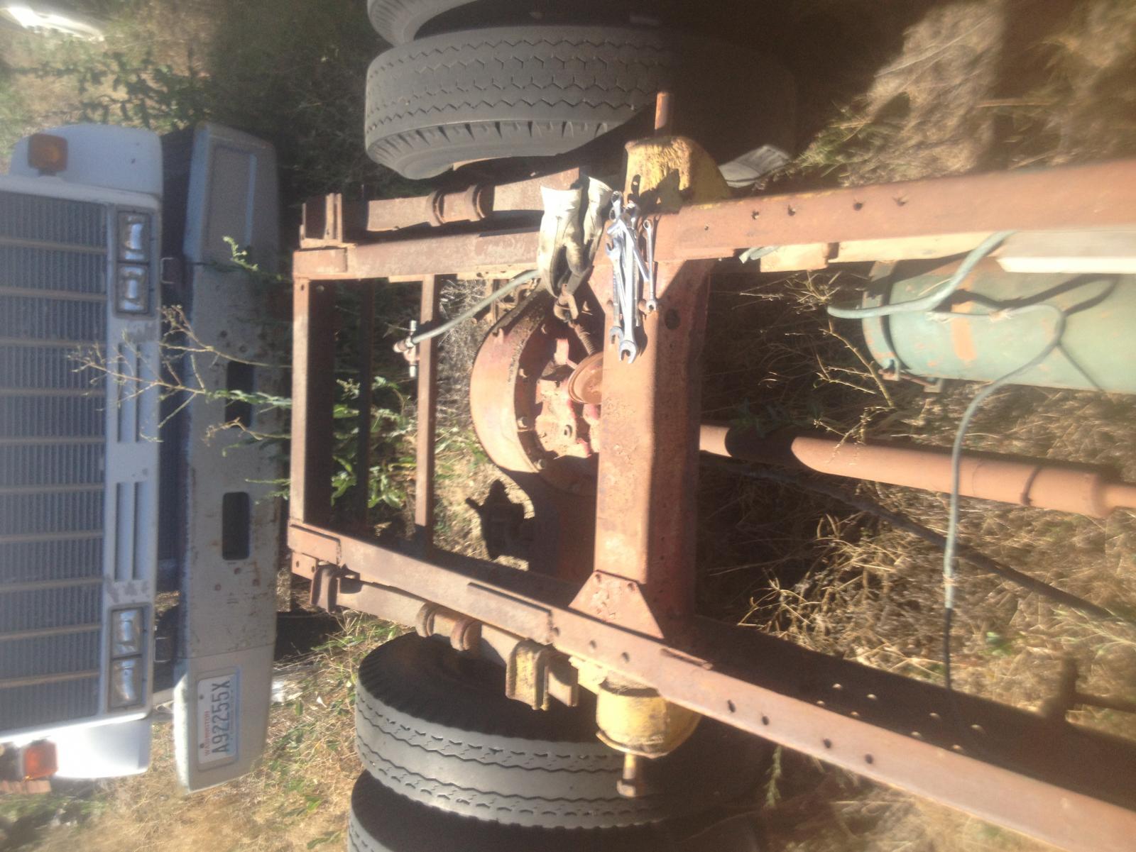

post-15422-0-26610500-1374031059_thumb.jpost-15422-0-24683300-1374031096_thumb.jpost-15422-0-07143100-1374031066_thumb.jpost-15422-0-21960700-1374031072_thumb.jpost-15422-0-22449400-1374031079_thumb.jpost-15422-0-64479000-1374031088_thumb.jHi Guys .. Fuel tank tag says 9 51 .. I'm a busy guy will look better for sn tomorrow and take tarp off engine n measure bore, i studied the SINGLE drive axle looks original with a hefty damn park brake behind carrier brg .. funny that the fuel tank looks to only hold thirty gal with such a big sucking gas pot ..
not too long ago i ran an old Rio w/w a 1693 best engine cat ever built it would not quit i could see the road thru the cracks in the wood floorboard especially over 70 loaded over 109k thats when it really performed n put out less than that was a cake walk .. looking at this i'm thinking it'd be more like hauling cows up to spring pasture at a 20% grade LOW HOLE all the way don't even think of grabbing a gear as the next corner becomes the HILL again ..
