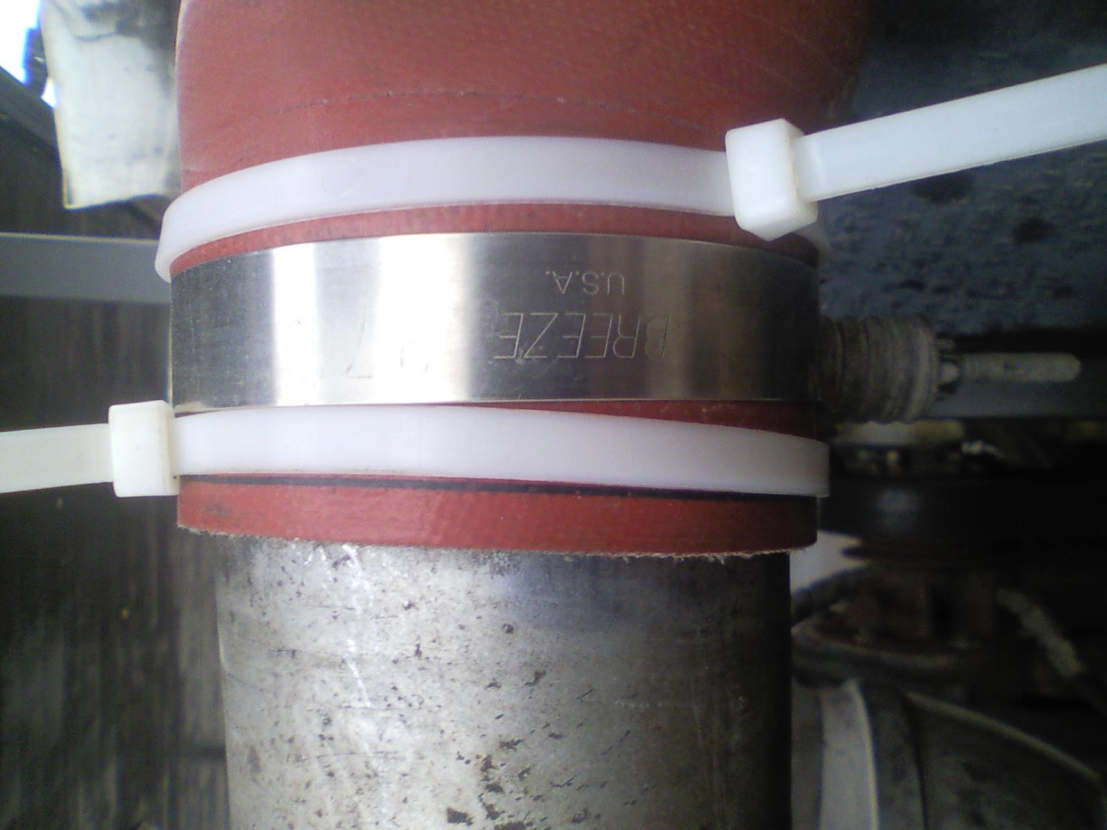

So I was driving the other day...stopped & fueled up...and when I left, I crossed the river and started climbing the hill into town. The truck started making a noise, similar to a balloon when you stretch the opening and slowly (and noisily) release the air. I pulled off the road and popped the hood to check my turbo hoses, and didn't see any holes or other problems with them...so I figured I'd press on and see if it continued. Sure enough, it was a persistent little noise. It wouldn't start until I was at 5 psi of boost, and would continue up to 20 psi before it would stop. The truck was running fine, though, and still pulled like it should, so I went on up the road a few miles to where I was going to dump off. Once I was empty, I pulled up out of the way and popped the hood again for a better look. I found a broken clamp on a turbo hose going into the charge air cooler....wasn't COMPLETELY broke, but wasn't holding tightly like it should. I guess it took 5 psi before the air would start leaking, and by 20 psi it was leaking out at a fast enough rate it wouldn't make any noise.
I started to grab the duct tape to wrap it up...but then remembered the heavy duty zip ties (125 pound break strength) I had behind the seat. A couple of them cinched good and tight got the job done. No more noise when the turbo winds up. :twothumbsup:

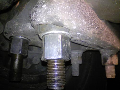

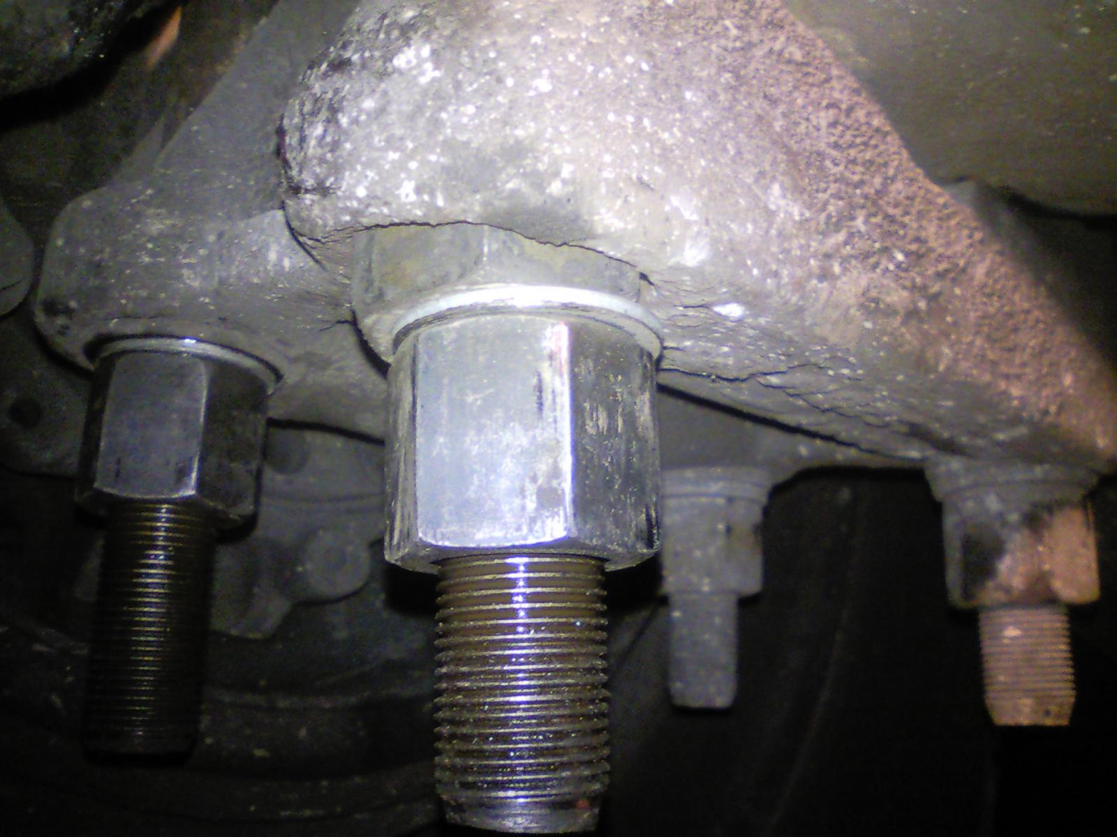

Broke the RR leaf spring on a trip a few years ago. Got to race track and noticed truck was leaning a bit. Tire was rubbing on fender, but with the rain I never noticed it/or make any noise.
I jacked that side up, slipped a 4x4 inbetween the fifth wheel mount angle irons and the upper spring block. Couple rubber bungee cords to keep it in place just in case I hit a bad bump. Made it home that night(2 hrs) with no problems. You gotta do whatcha gotta do to get home.

I did the same thing some years ago when I had a broken spring on a trailer. Had a load of lumber on, and jacked it up in the truckstop parking lot in Harrisburg, Pa. Stuck a 4x4 between the axle and frame rail and drove on to the yard in Appomattox.
