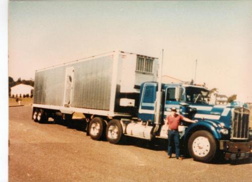

Nice Kenworth and reefer Mark!
Thanks Jim,that was a really nice truck,a friend of my grandfathers owned it,he had a driver quit,needed a load delivered,so pop "volunteered" me to go! I ended up taking a mixed load of produce from Vineland,NJ to Toronto. This guy was a real "fly by night operator" he gave me two checks for fuel (one up one back) and $50.00 expense money (it bounced) I made the trip,re-loaded a load of flour at Pillsbury in Buffalo,delivered in Jersey the next day. I think i made $85/90.00 for the whole mess! BUT i got to drive a "pretty" truck! this one had the nice V.I.T interior (blue buttontuck) 3408 CAT,14 speed Spicer sst,and 3:35 rears if i remember correctly.this was also the one and only truck i ever drove with a 120 MPH speedometer in it,and given the proper circumstances,i think it would easiliy have done it! my first foray in the pilot seat of a "largecar" lol!........................Mark
