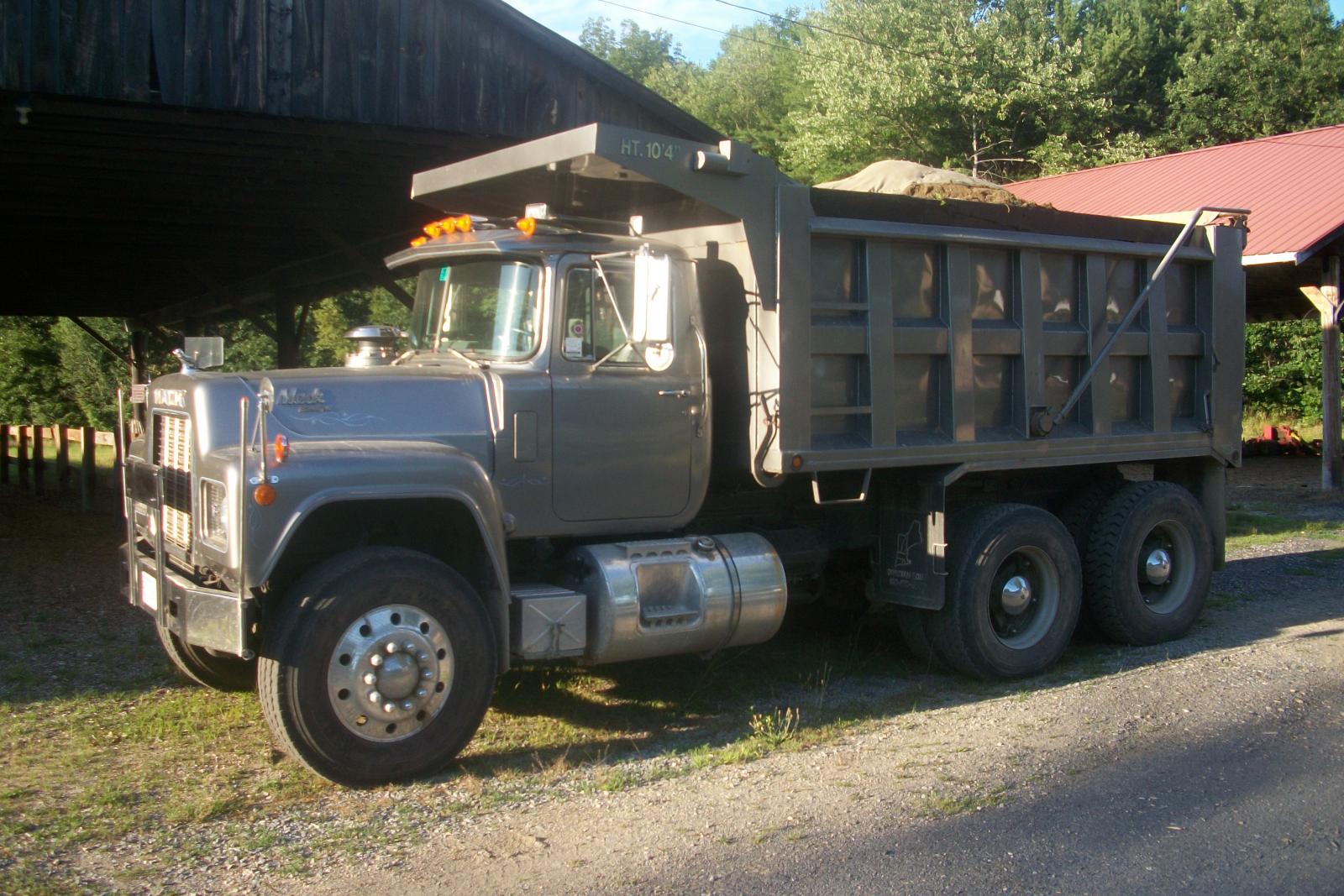

I have a friend who has a very clean 88 R tandem dump (I think its a 688SX), big rears, and the 1071. He has a guy who drives it from time to time and the guy does not think its a six speed but rather uses the low hole air shift with the stick in other than first. As a matter of fact, he says he takes off with the splitter in "L" and the stick in 2nd. He then says he goes back to 1st "D", then second "D" etc.

That is kinda the point boys. If you followed the dash/visor plate, we wouldn't be having this conversation. As I said when I started this, young friend of mine has this beautiful R that he paid top dollar for. He has a guy driving it from time to time who thinks its a 7 speed-or even a 10 for that matter. I just want to be able to tell him..."don't let him drive it that way" if in fact he is doing damage.
by the way-here is the truck-he let me use it for a few days for some "charity work" at our fairgrounds.post-1625-0-30235500-1331814934_thumb.jp
