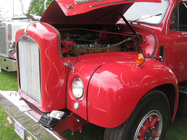

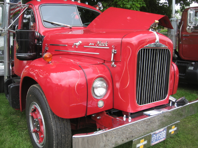

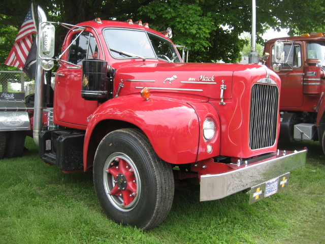

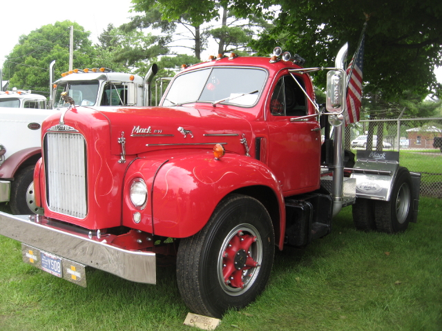

This was at the ATHS show in Winchester Va last year, factory Cat with longer hood and filler panels between rad and fenders. Same extended nose parts as the B model Fire chassis with the Hall Scott power plants I was told. Some body on here had extra sheet metal for the nose too.

This was at the ATHS show in Winchester Va last year, factory Cat with longer hood and filler panels between rad and fenders. Same extended nose parts as the B model Fire chassis with the Hall Scott power plants I was told. Some body on here had extra sheet metal for the nose too. longnosecuminsb_118.jpggallery_2_6_866140.jpg
That B71 truck has an NH220 Cummins and that engine is physically smaller than a 3406. I have photos of the underhood I'll find.
Thought I had better than these.
Rob
https://www.bigmacktrucks.com/topic/23818-3406-cat-b-model/#findComment-107043
The longer hood and filler panels are factory Mack parts. I'm pretty sure have a pic I just have to find where it is, but I'm sure it was a 3406 Cat, he has Cat powered badges all over it. Course my kids say I'm wrong so it's possible I am..........
Under the front bumper are Cummins Iron Crosses.
Rob

This is a B-71 with factory 220 Cummins.The B-21 fire truck hade the 400 Hall-Scott with same front end .Check lenths at a Cummins dealer of the 743 cid and 855 engines also check widths to see if would all fit down in frame.It should do because of flare in rails in engine compartment .Bob D

the 220 cummins has a length of about 57" where the cat is about 65" how tight is that 220 cummins in there?
Very cramped from my dissapating yet evenly dispersed memory cells.
Rob

  On 3/13/2012 at 7:22 PM, 220cummins said:
and the compression relief valve and chain on the cummins is visible in one of the shots
What is that chain for?
