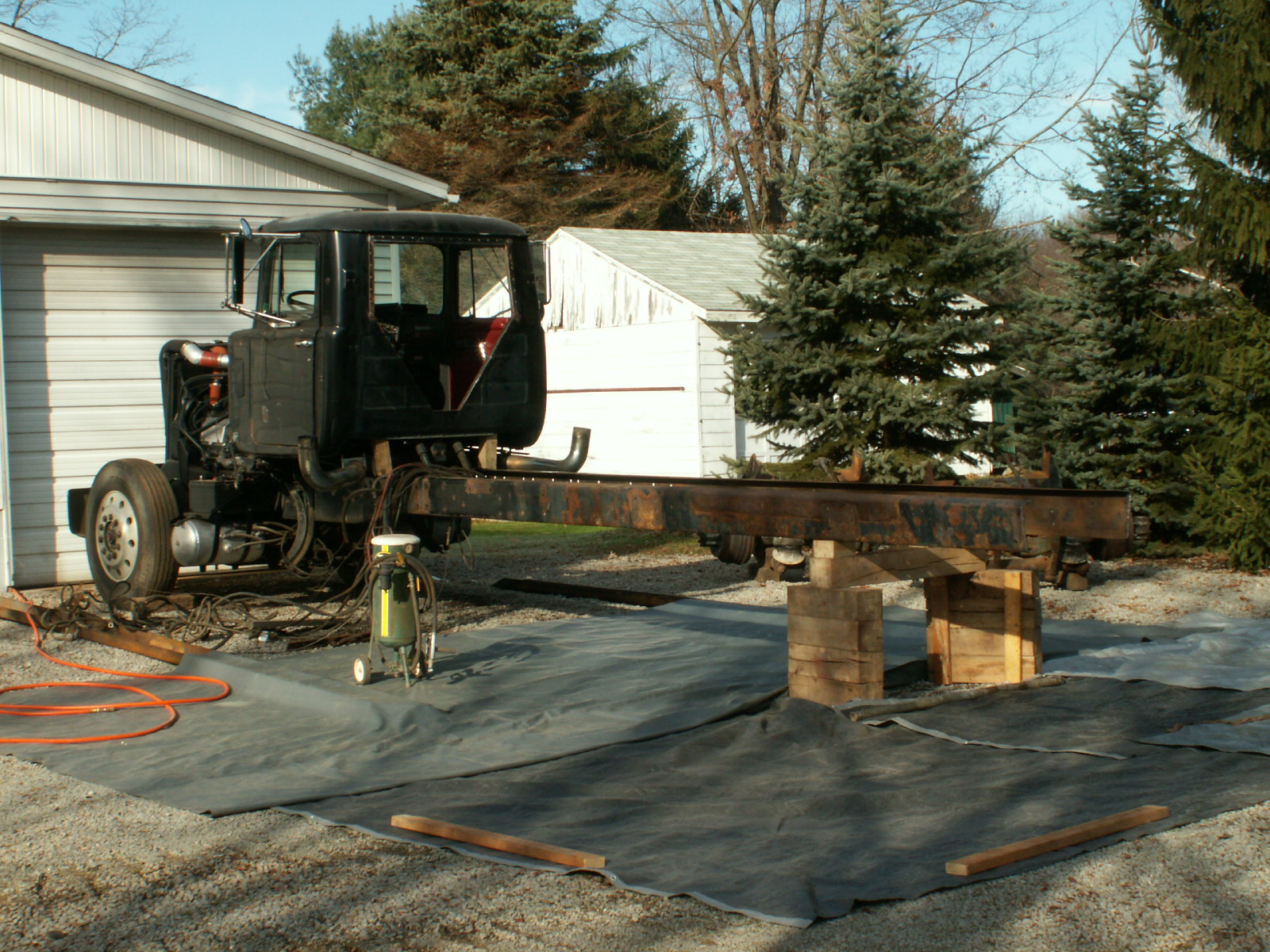

Im stripping the rw713 down for paint. I was just going to have the frame blasted, sealed and painted, but there is a fair amount of rust scale between the two(double) frames. I was thinking of cutting the outer rail off some where by the cab cleaning out rust and painting inside before rewelding and installing the outer rail. any thoughts? bobo

I've done that when there is spreading of the rails. If it is just rusty and not spread, have your blaster "delve" in the area(s) to root out the rust. Then pressure wash the blasted are leaving the truck frame in the sun to dry. By the time you acid etch the bare steel to promote undercoat adhesion, the flash rust will be nothing to worry about.

hey rob its pretty bad in some spots maybe 7/16 between the flanges, monday im pulling the 5th plate/slider off. see how bad it is under there. The truck was a float tractor, wasnt used much, only 280k on truck. It was washed more then it moved! bobo

I have done exactly what you are proposing to do. It would be in your interest to purchase a small right angle grinder jig to limit depth of cut. I then use the perimeter of a 3/64ths, 3/32nds, or 1/8th inch thick grinding cutoff disc to basically slice the outer frame wrap from the inner. It takes a bit of time, but there is no damage to the underlying material. I use my grinder to cut 1/4's from wrecked cars and it works slick. Your line of cut will be so straight that if it is not damaged, or thinned from the rust, it can be beveled on the edge and reinstalled after the rust is removed. Be sure to use enough heat to penetrate the baseplate completely but not enough to melt into the underlying frame, (inner rail) as it isn't needed.

I agree with Paul- On my RW 613 the inner and outer frame rails were separated almost 3/4" just in back of the sleeper. As the two parts were forced apart you could watch the rails regain their original shape. I would never have thought they would come back in line.
I sand- blasted to white metal on the mating surfaces and coated with Zero Rust coating.
See the attached picture- the inner rails are on the ground under the frame.

I've done this plenty also. However, if you don't plan on breaking the truck apart complete to separate the rails, (it is a LOT of work) the earlier mentioned way is very effective as the cab, crossmembers, or driveline is not removed.

ROB I did just like you said! It work out beautiful, I was getting a little discouraged when having trouble pressing outer rails off. 4 porta power jacks and some good friends that can take my abuse, BUT well worth the time and effort to do it. I painted the inside of the outer, and outside of inner with POR-15, We didnt even have to straighten any of the flanges out, they poped back into place on thier own. hope to have it welded by next monday, then sand blast and epoxy priming the frame boB0

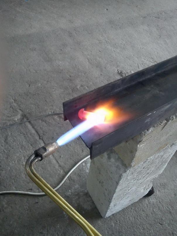

It's possible someone already rebuilt your chassis in the past and used rails which didn't mutch the size well enough. If the issue was done by rust the shelves of the rails must be slightly bent relating to the horizont. If so I would try to forse them down into the normal position hitting by sledgehammer along the edge or using hydraulic what's more preferrably.

Also a question is which model your truck is. If it's CH or CX (if a Mack) they have straight rails front to rear and you are able to order a full length newly made channels. Much more job removing the engine and the cab but you would get a truck with chassis of the same or even higher performance than it was originally leaving the factory. Older Macks with "fashioned" front end of the rails don't allow such approach so welding turns out as about the only option.
The rails themself aren't extremely expensive. But the amount of job may differ.
