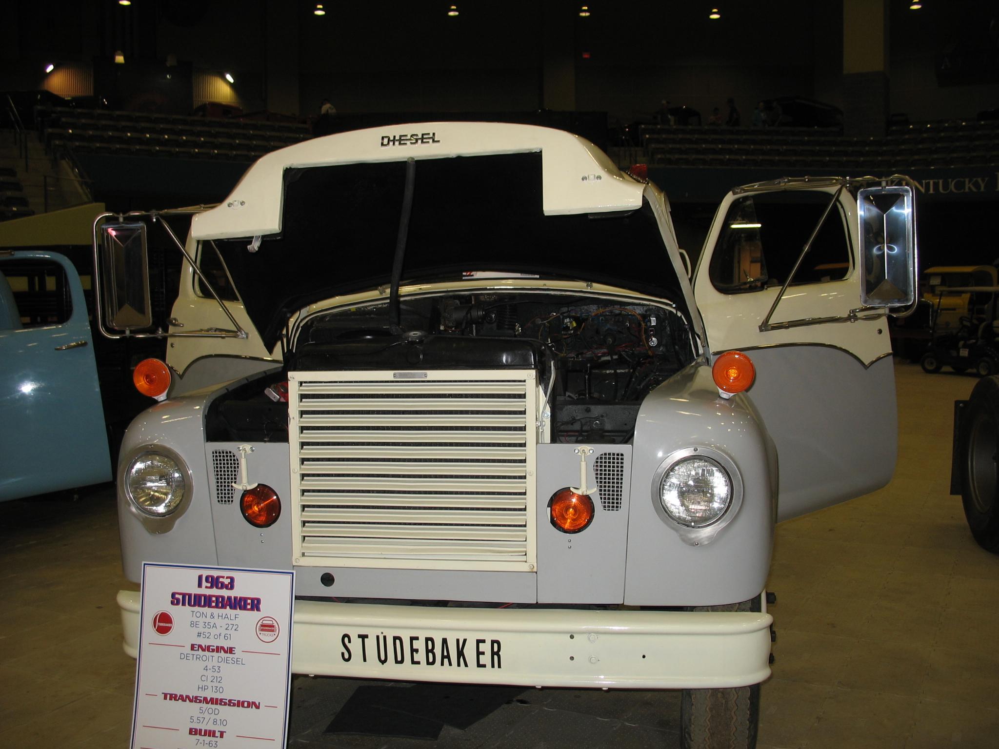

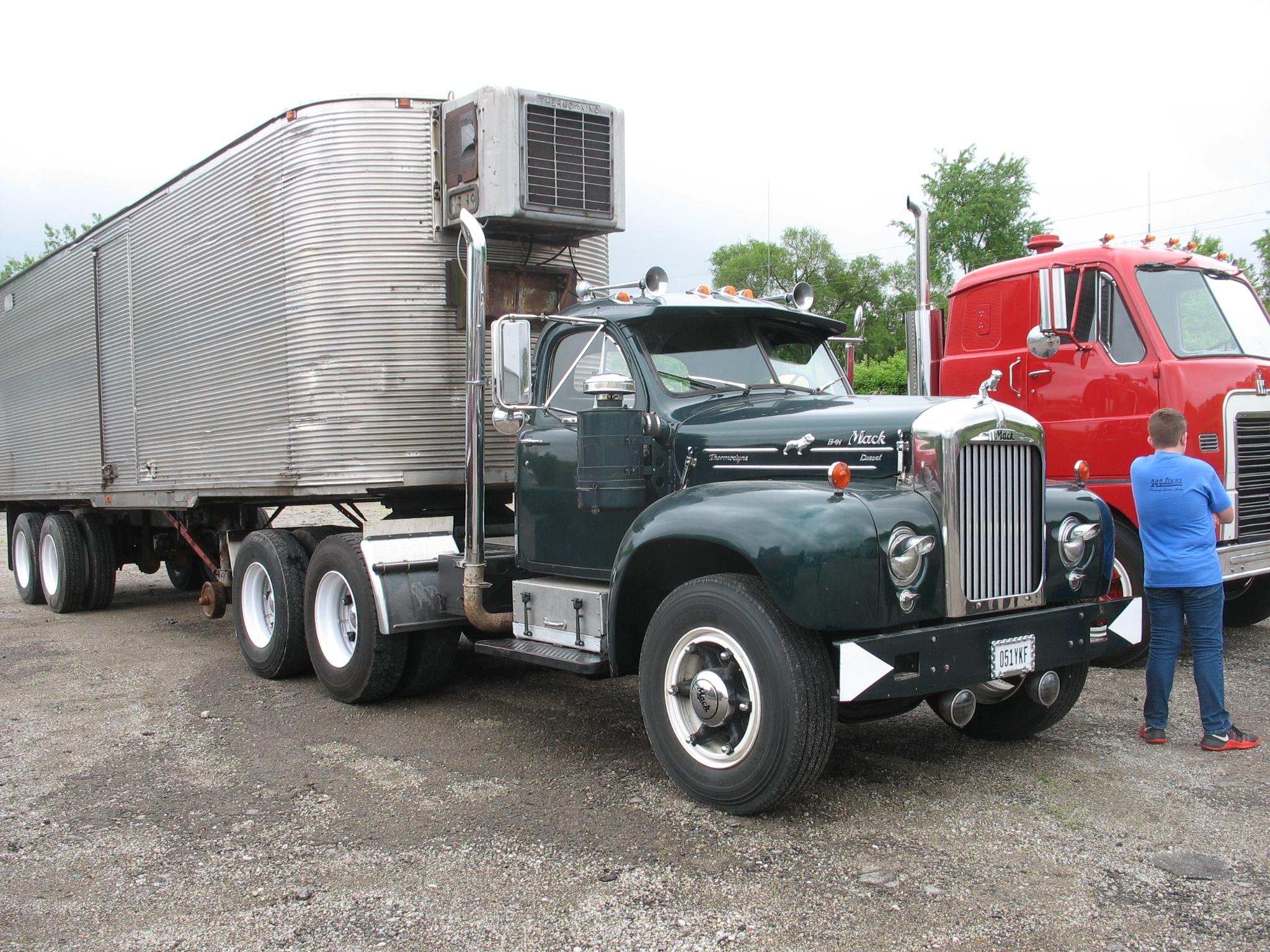

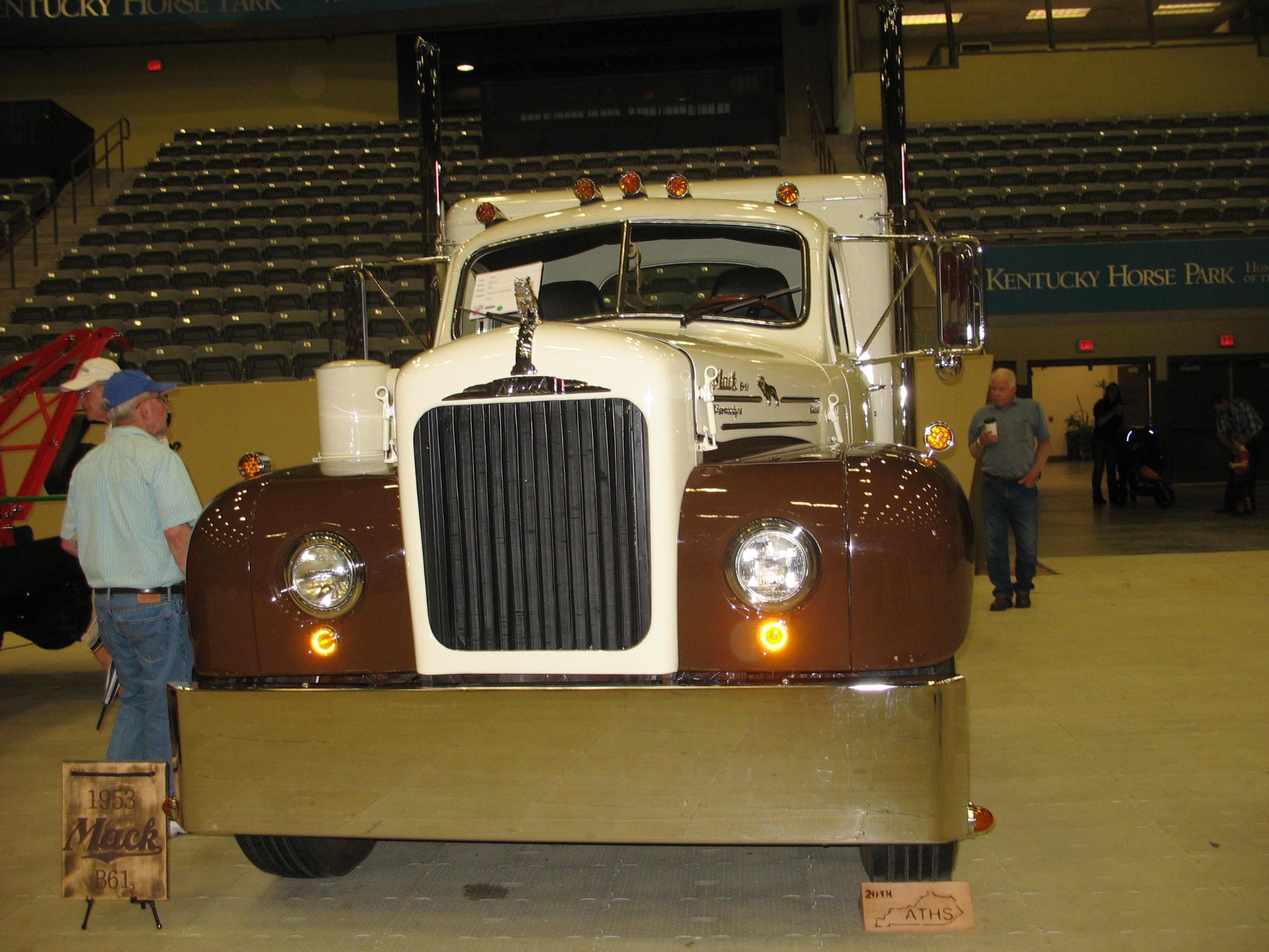

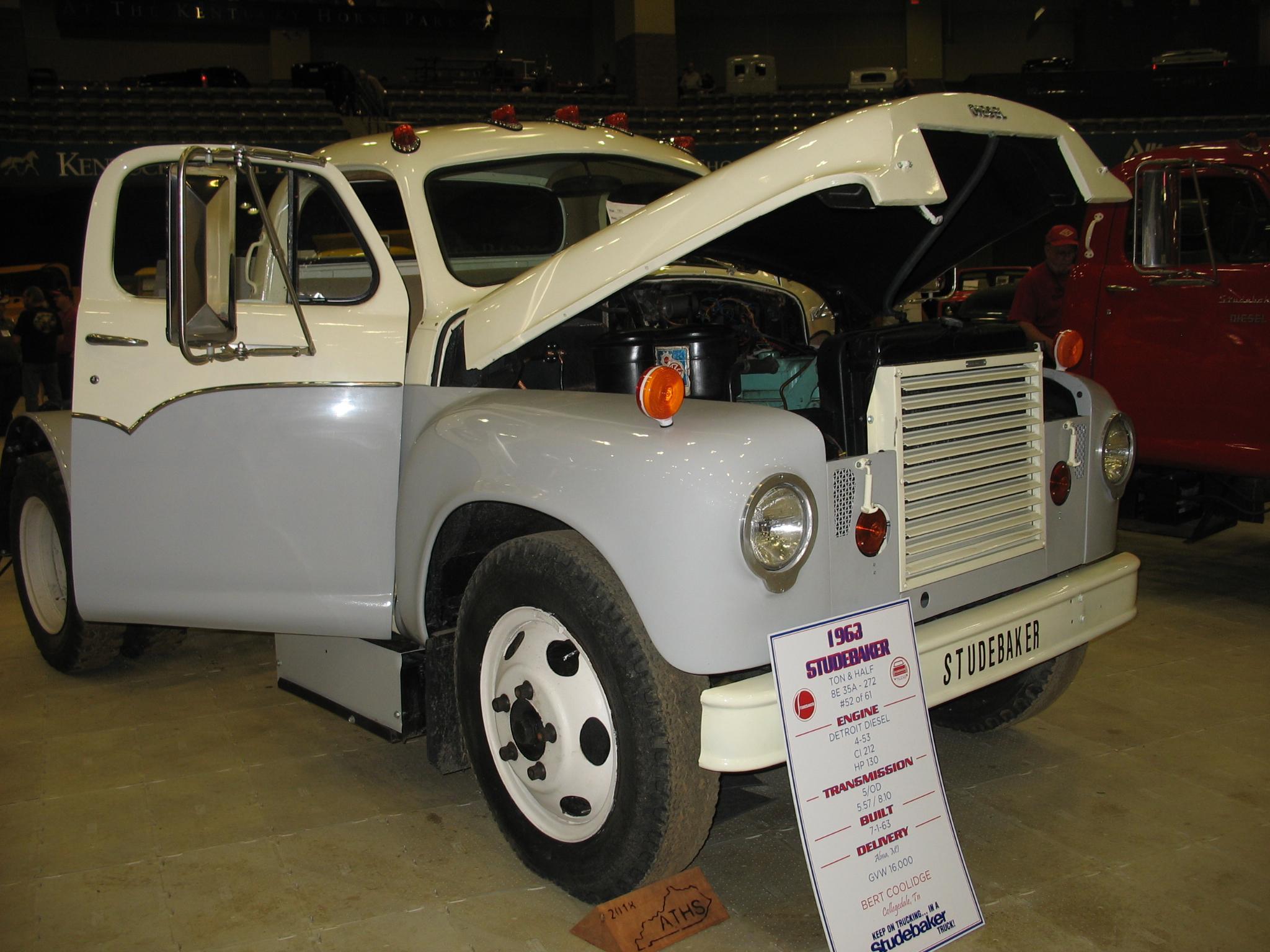

  1. Just got back from the show . Great show well organized . Took a few pictures but my camera broke after the pictures of the Studebakers with the Detroits . Did get a picture of a B 61 with a factory sleeper. Finally caught up with and met Larry Freightrain .
