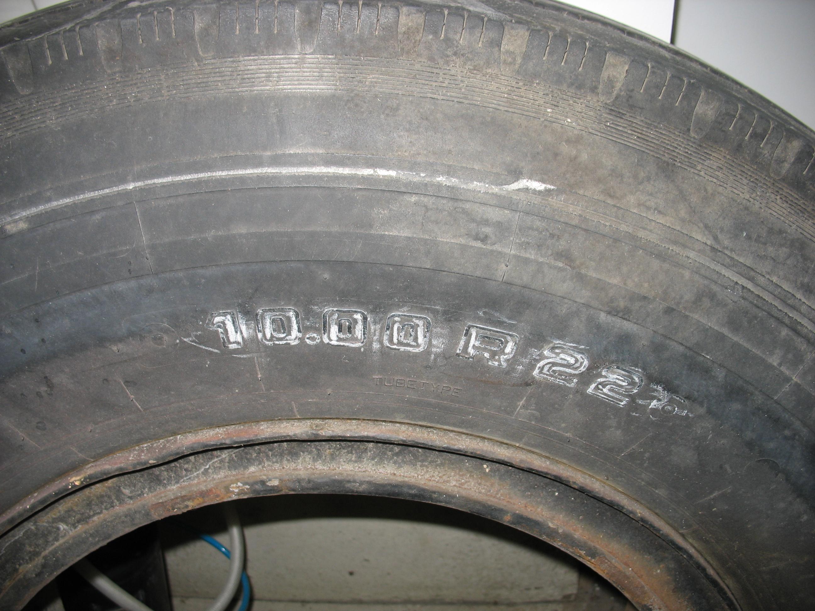

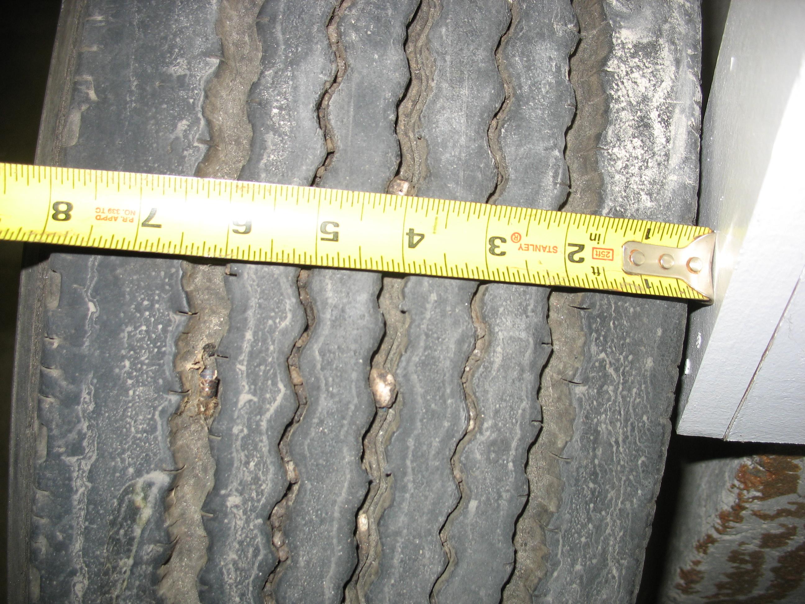

  1. Hobrert now you have me more confused . I can not find 10R24.5 tires My old 10R22 are about 10" at the bulge and about 8.25" tread . The 22" is the 24.5 tubeless. I think 11R 24.5 are going to touch on the rears.
  2. Getting ready to put new rubber on the front of my B 61. Has 10R22 with rims with locking rings . I have 6 good 24.5 tubeless rims about 8.25 " wide . All I can find are 11R24.5 tires which should be good on the front. The rears are 10 22 bias ply with 1 3/4 " between the two . I think the 11R24.5 are going to be too close . What are my options ? Are wider spacers available ?

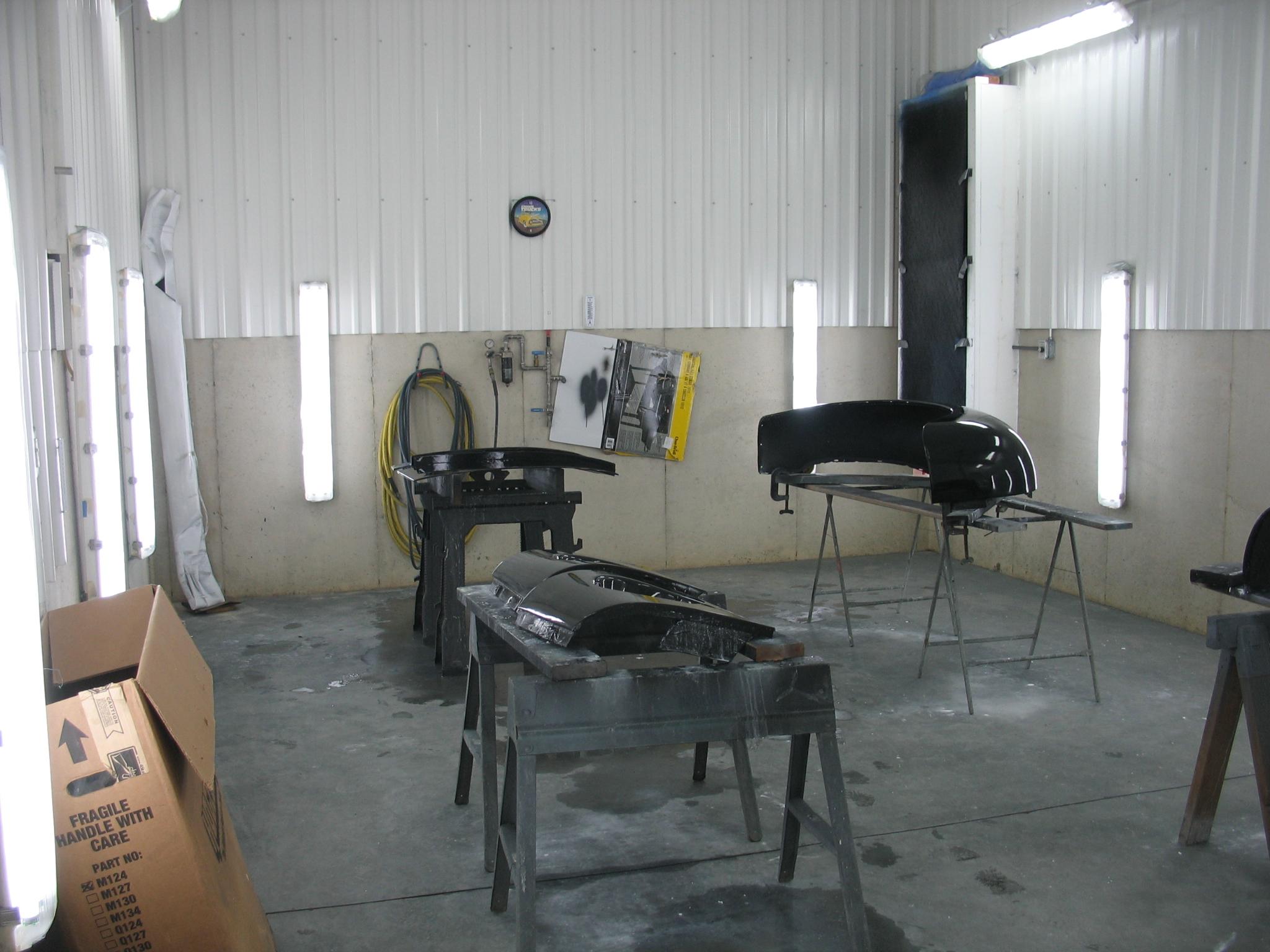

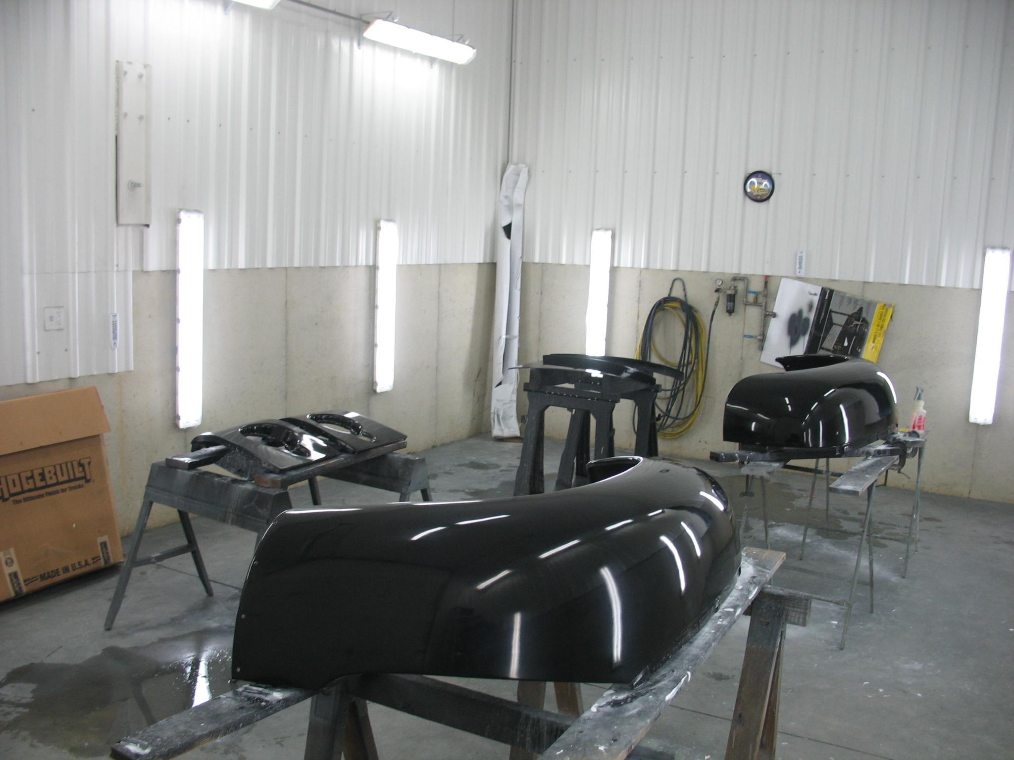

    Great looking building . Did you insulate if so what did you use ? Thinking about building something similar .

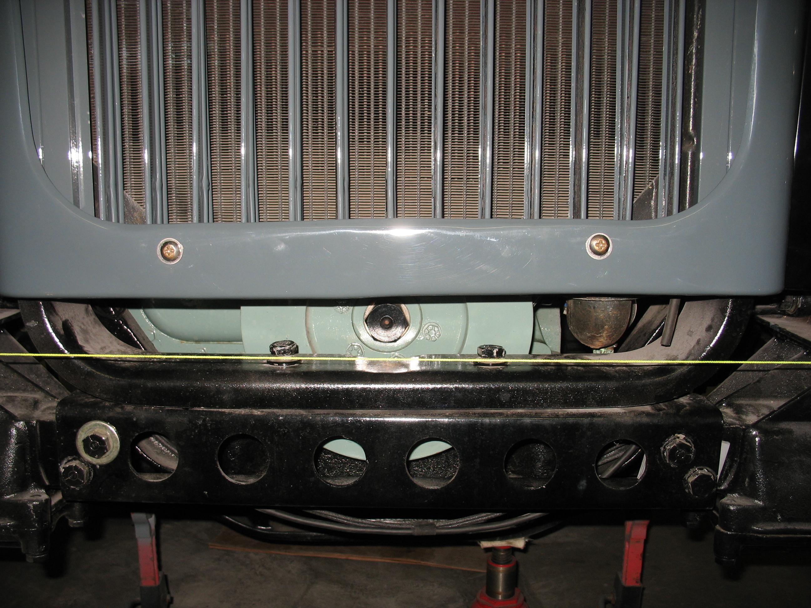

  12. Thanks everyone . I used some stainless shims 1/4" Pried the core support up and slid them in .Still can not figure why the support would not go down level . Looks ok now .

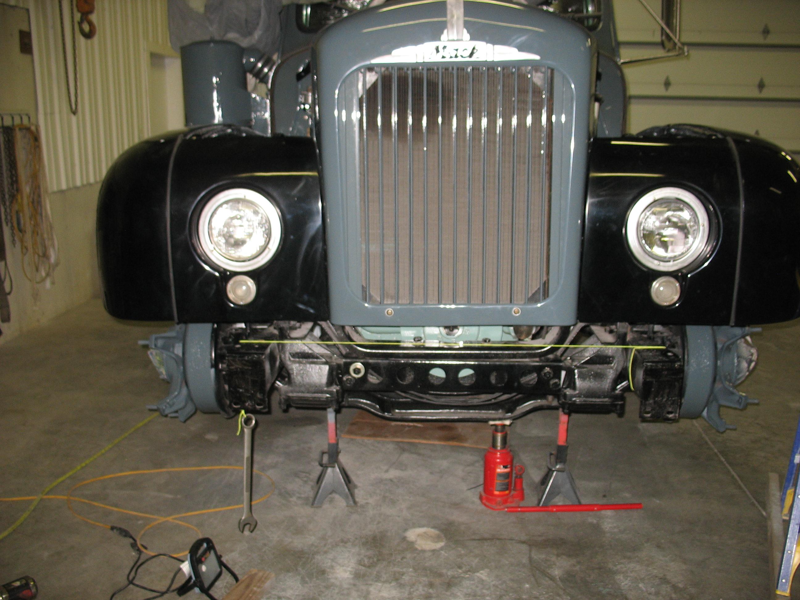

  13. One step forward two back . Got the fenders mounted without a scratch . Put the new bumper on noticed the right fender was 1/2 "lower than left. Closer examination the core support was about 3/16 lower where the new rubber bushings were installed . Do not know what to do, shim the bushings ? Would like to pull the core support but do not know how to support the fenders when I do .
  14. Thanks for all the tips . Think I will put the inner and outer head light panel on first . Took the tires off for more room .
  15. Had the fenders and head light panels ready to paint the first of June but had my knee replaced the the fifth of June . Standing for a length of time was a problem . Finished them last week . Any tips on installation ? What is best , put the headlight panels on first or install panel and fender as a unit ?

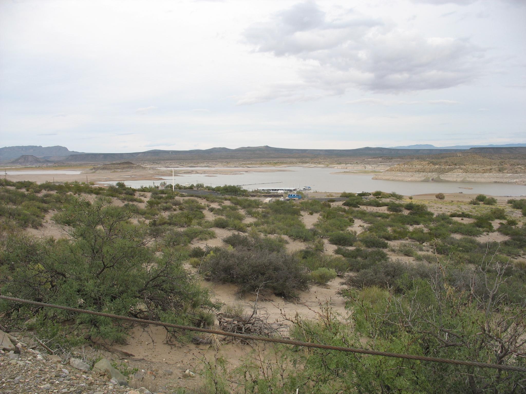

  19. The lake is lower than normal for this time of year. They irrigate about 160,000 acres from it . The snow melt and water up north fill it.

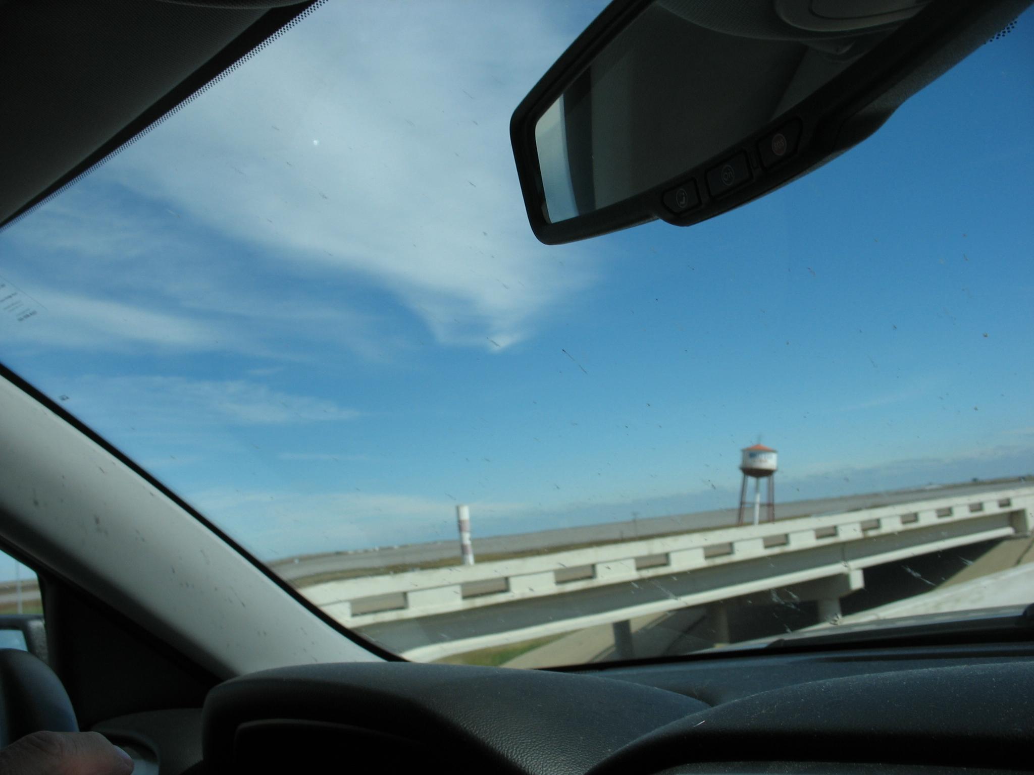

  20. Thanks for the info on the tower . It had me confused . Nothing new for me .
  21. I do not know the story on the tower , but it has been that way for some time . If that was my tractor I would move it before the tower got it .

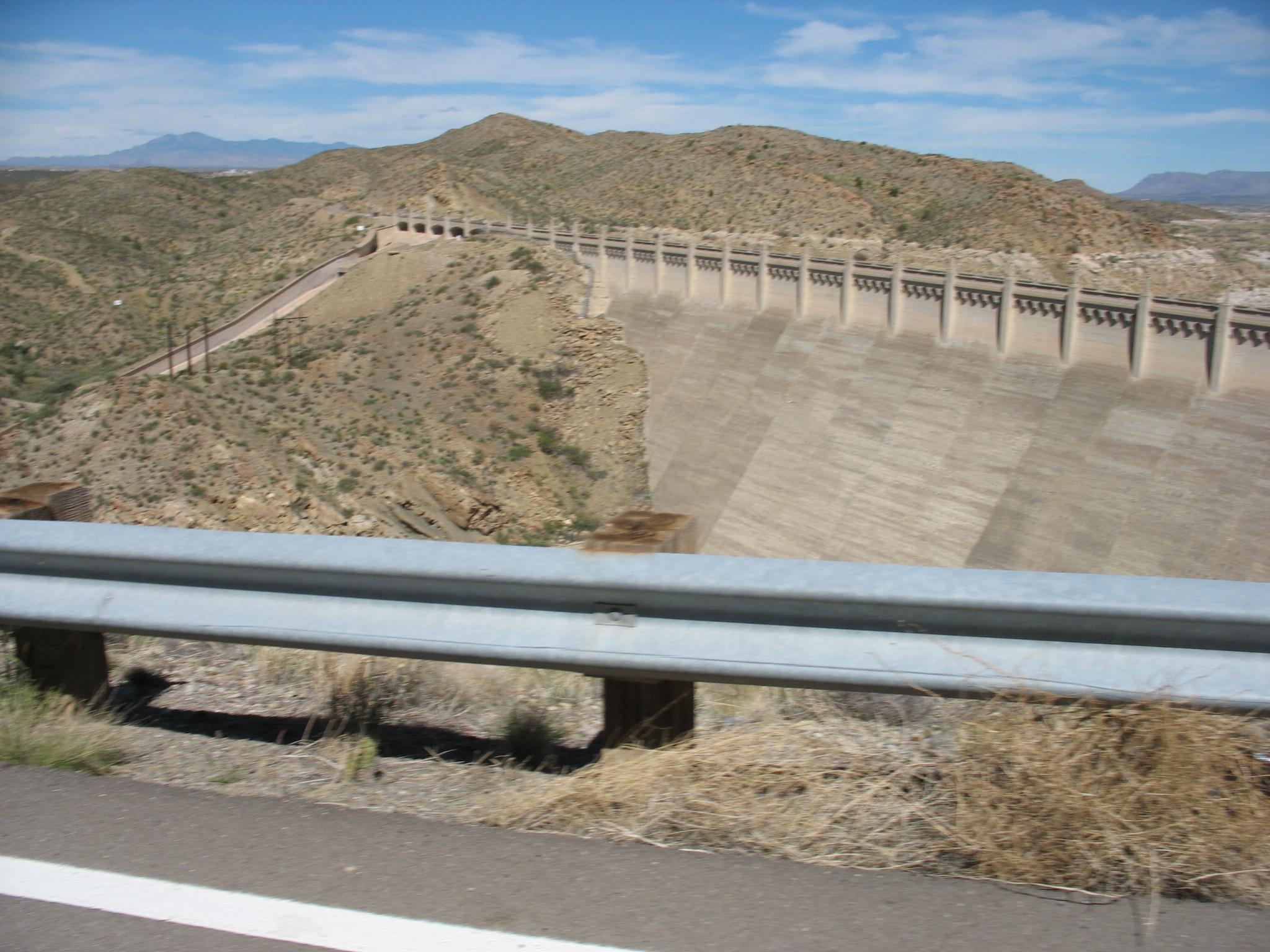

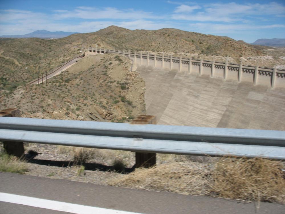

  22. Pictures of the low water level in the lake at Elephant Butte and a leaning water tower in Texas .
