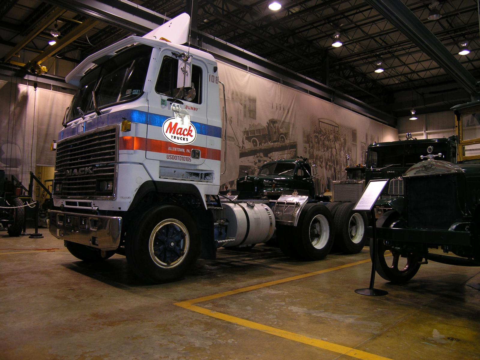

  15. the bolt is seized in the bushing. you now know that cheaping on never-seized when puting it back in place is not a good idea. last time I was able to cut it with a grinder and a few new cuting disk. you cut it on each side of the arm (inside the bracket) and it will lower. you'll be able to burn the rubber and get it off. get ready to weld the shaft under the airbag. it's always wornout/rusted. pay attention there is a cutter pin that lock the threaded stud. if you weld over it, you'll never be able to change it! I've always been scared to work on a neway and sent them to a suspension shop. once you've done it once, it's no big deal. I've learn that it sometimes easier to get the whole axle out of the truck with suspension arm and do it in the shop. I'm just done doing my super-liner ard244 and this is what I did. I take about 3 hours to take the whole thing out.

  19. thanks for sharing it with us. It's just so nice to see it back in the days. can you provide the link on the website please? I just want to make sure everyone got it right. The truck is not donated to the museum. I'm keeping it but it's on display there. I was not able to bring the truck back in Canada at that time I was too busy, so Mr Don Schumaker and some volonters went and drove the truck back to the museum with minor problems that they have to fix. They took care of everything helping me to reach my goal of saving that Mack. It will be at the Customer Service Center for a while to let everyone enjoy it. Without the museum help, it would have been 100 times harder for me to save it.
