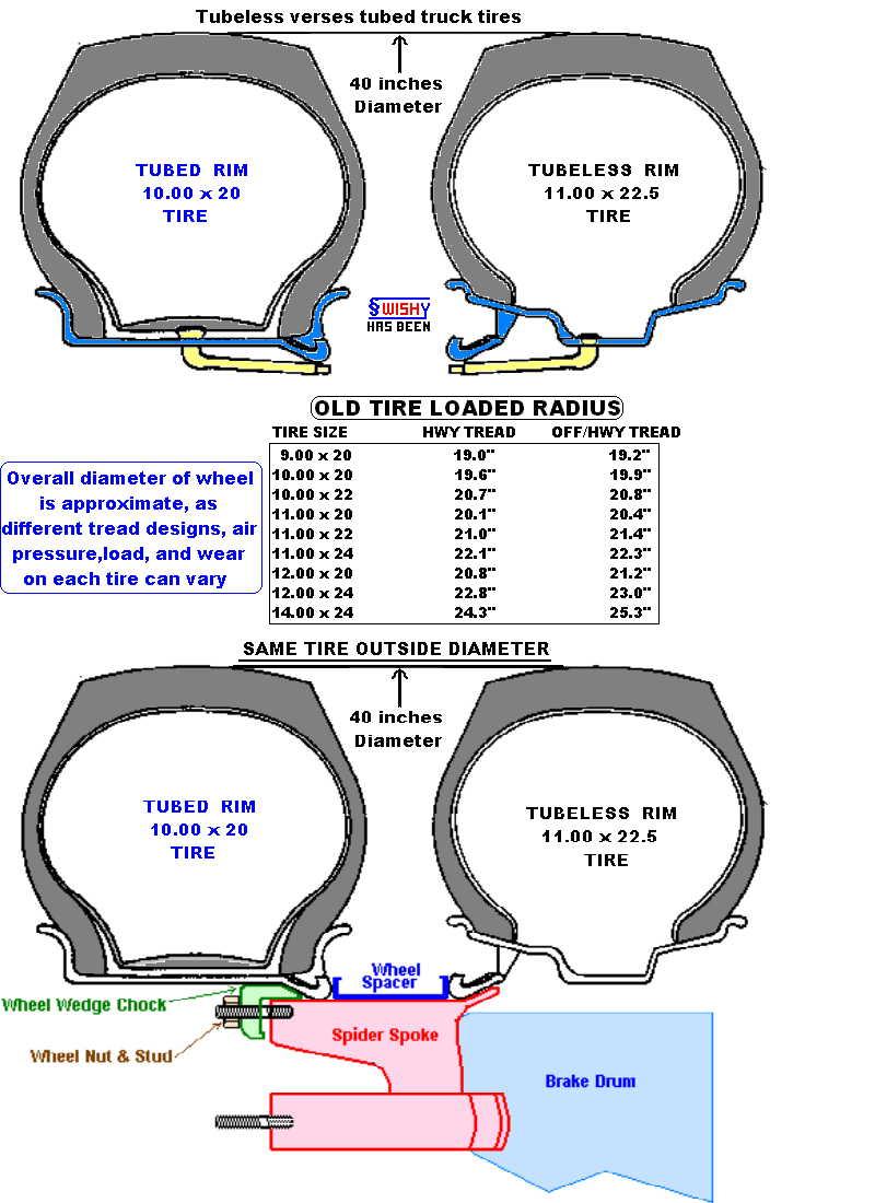

  8. Hi Crop gudday m8 aint a gr8 fan of chrome wheels on SPider/Spoke Wobbly wheels we have a CH Mack th@ came with chromies n they all cracked around the rim weld not sure if the process takes a bit of goodness away from the steel or not have heard of stainless steel inserts long time ago if U chrome the fronts U dun see too much ... only the outer part n rim unless U B runn n super singles cya §wishy
