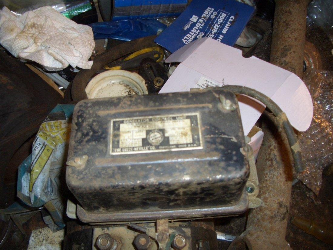

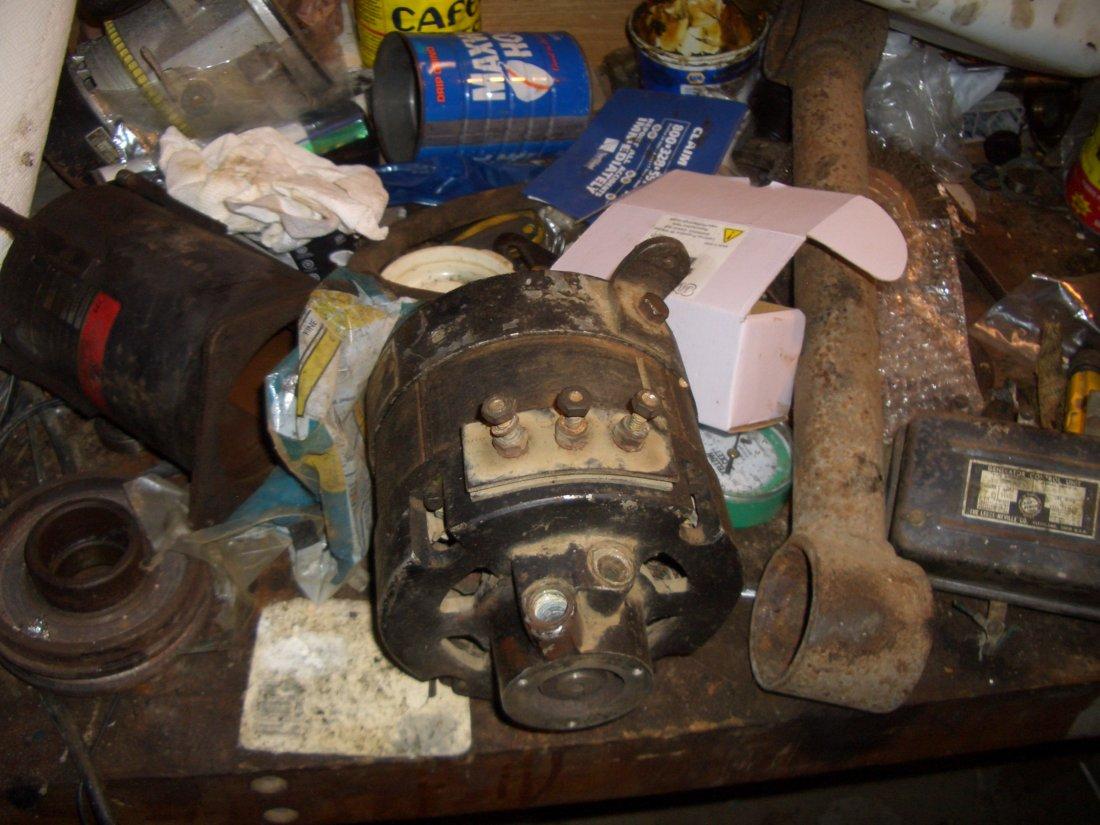

I would be surprised if the regulator doesn't work just fine from the get go. I had a few from the early 40's still working fine. They really did a good job when they made those. As long as the commutator isn't bad or someone didn't cranked down on the current regulator and burn the windings, the genny should be good also. Just lube the oil cups and make sure it spins easy. I have purchased I don't remember how many off E bay and once cleaned up they work just fine. I don't buy ones that look like they have been under water or all broke up, but just good generally used condition You can test a generator by "motoring" it. Connect the battery across the output (A or Armature) and the case and it should start to spin. -
