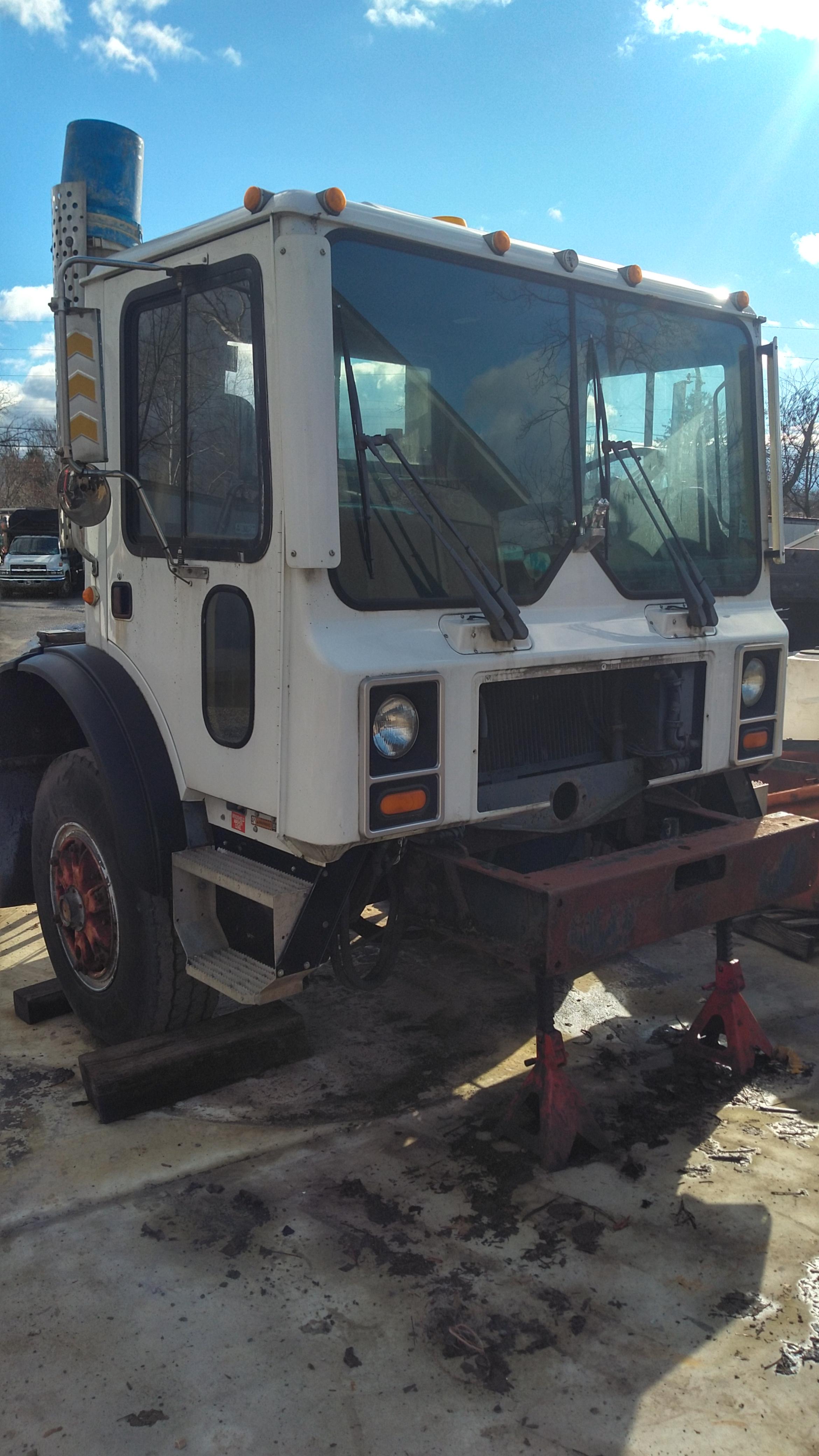

  15. Hydraulic oil doesn't compress, so the response time could be better than you're thinking. Don't think you'd build all that much heat if you just used it as a shift assist, you're talking about 1-2 seconds of braking time per shift. It will mean more wear and perhaps shock load on your hydraulic system, mostly I'm thinking about the pump drive shaft.
  16. You don't need 150hp of braking power to slow the engine down. You may be stalling that thing out doing that. Typical Jake's have an electric switch on the clutch pedal, another on the throttle lever on the pump. Then there's a manual system hi/lo/off switch on the dash. Hi/lo is two heads/one head. If you were going to run your pump as a brake I'd build it into your pedals so it's instantly on or off.

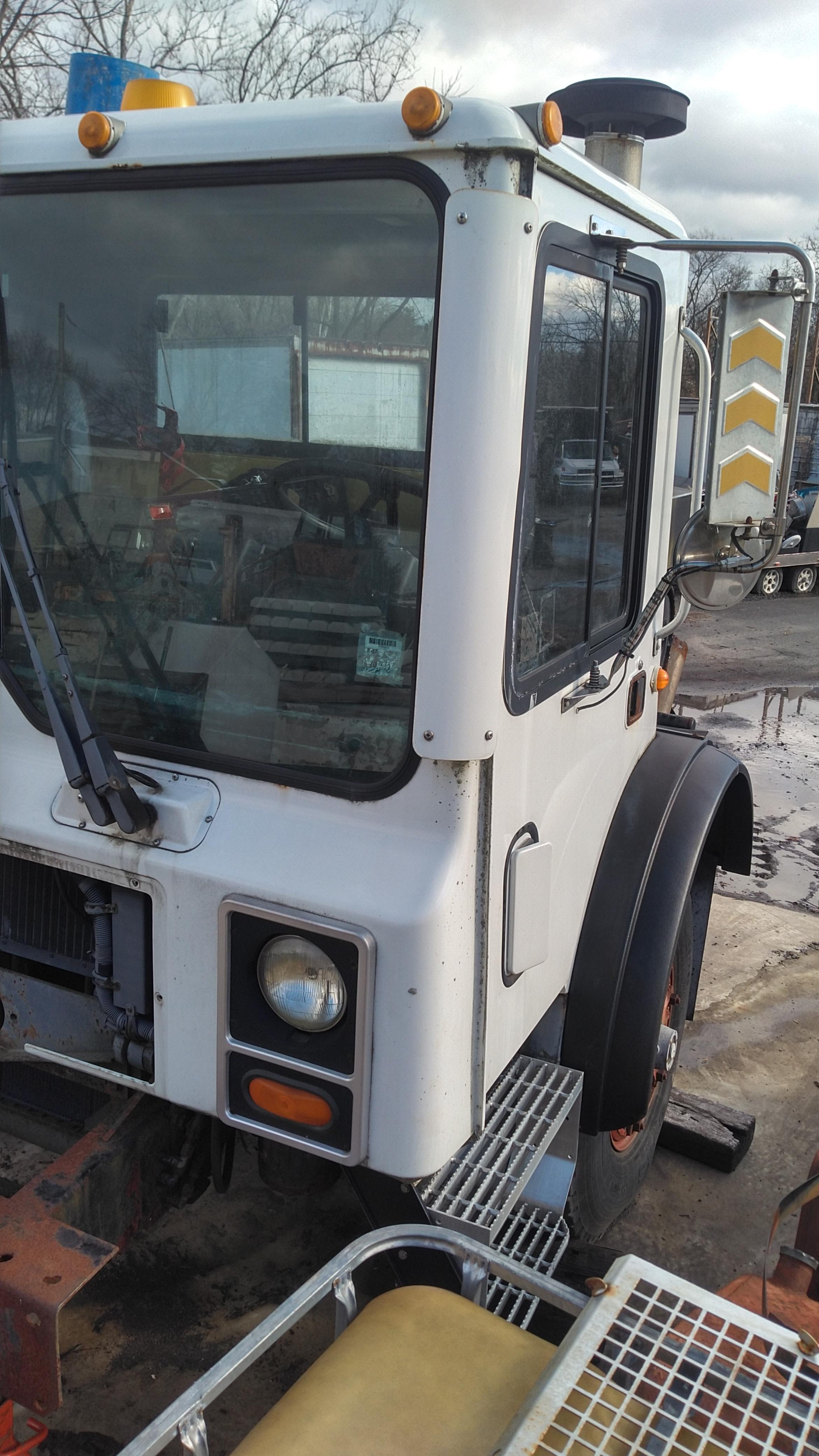

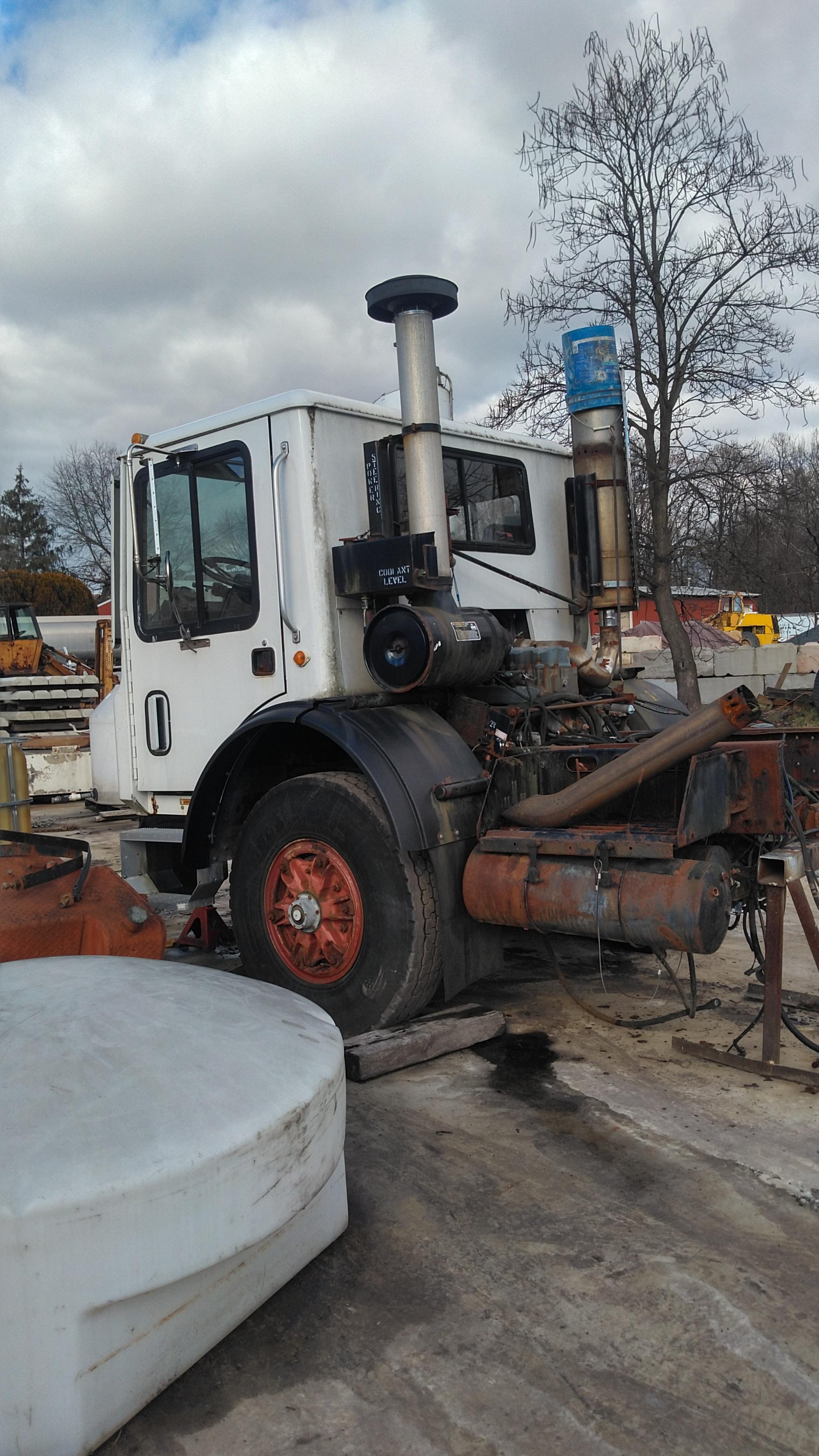

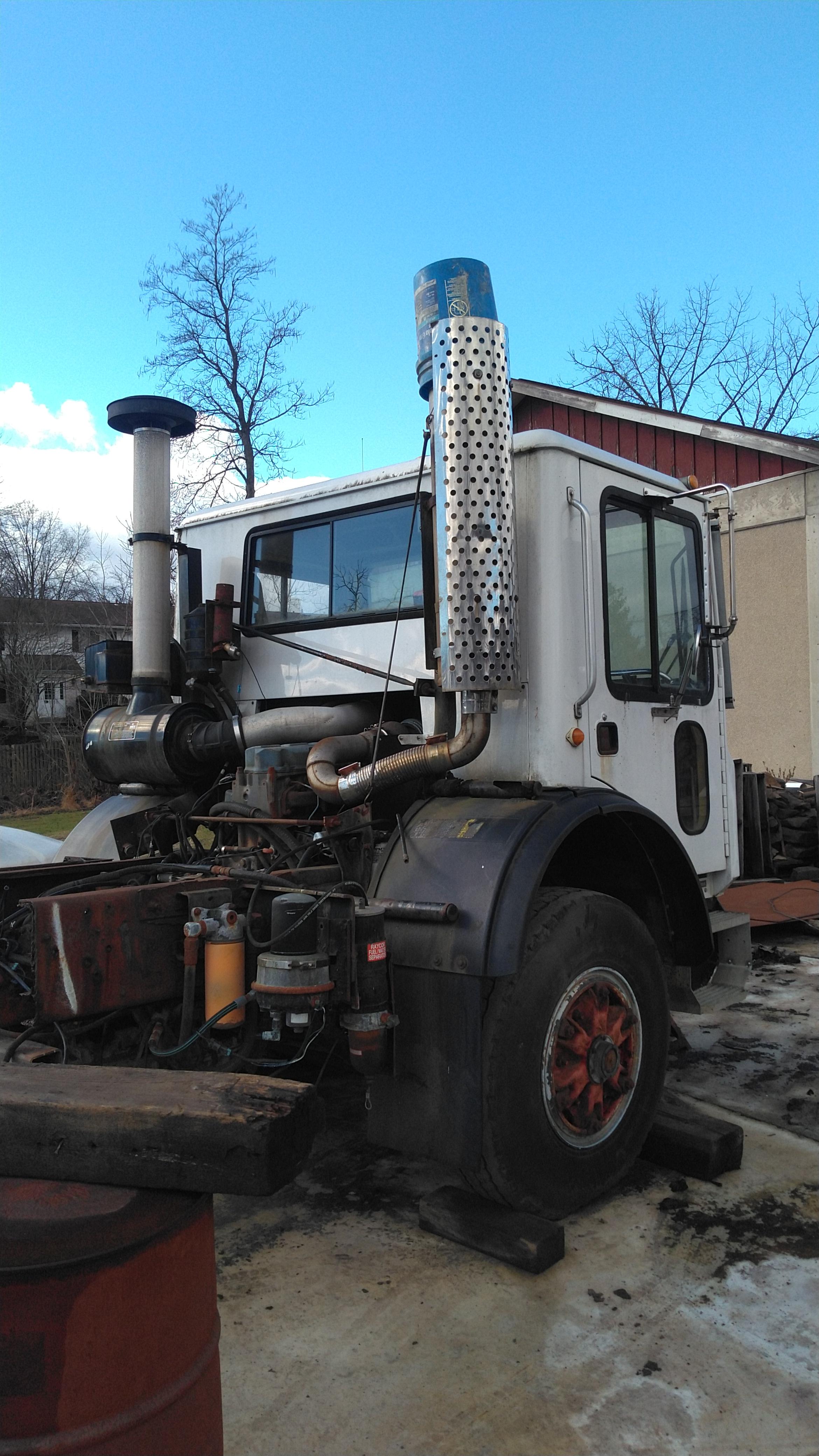

  21. Got the engine running today on a bucket of diesel and a couple spare batteries. Neutral safety switch on the trans had gotten unplugged some time in the past 10 years, other than that it fire right up! And it's official, it has 14,090.741 miles on it. 3,887.550 engine hours, 3,105.5 of which are idle hours. A lot less than my 2003 that has 28,000 hours on the tachometer.
  22. Took me a minute to figure out what that things in! That's a cabover, not sure what model truck. Your exhaust is a different layout than mine. There should be a tag between the two halves of the turbo. May need to crawl deep in there and clean it off.
  23. I'm not sure there is an em6-350, I think the Maxidynes tapped out at 300. If it's a 350 then I'd expect it to be an e6-350. I drive an E7-350 triaxle with an 8LL most days, 8 gears will get it to 70+ mph. If the 350 runs, you might be happier dropping that and the 9 speed transmission into the truck. That will give you much better gearing for what you're trying to do.
