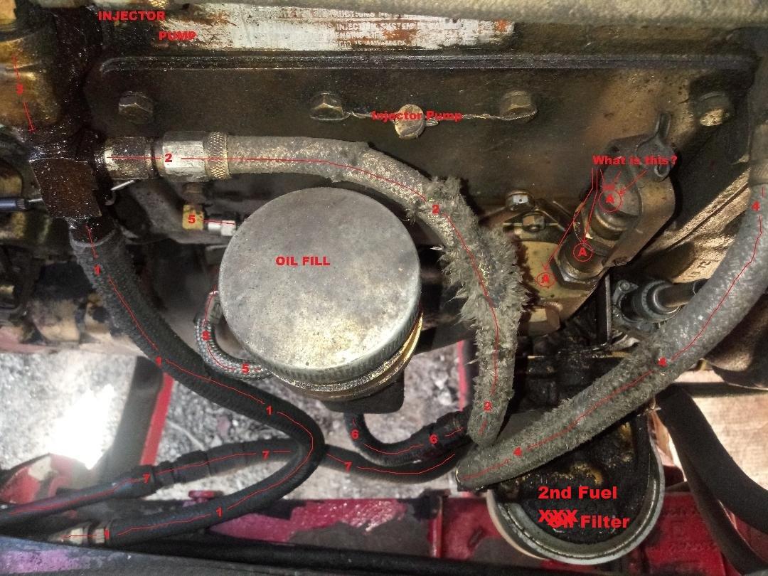

  1. The truck is or was currently running before I had to take the radiator OUT for repairs. I haven't as of yet taken any of the fuel lines off. One disaster at a time. I'm going to wait until I get the radiator back in the truck with all its parts and then start the engine to test for coolant leaks. I plan to drive the truck around slightly for a while to assure the radiator fix is holding. Then I'll address the fuel lines. I gave the primer a few pumps this morning. It leaked or seeped a little fuel down where the plunger meets the body. After a few pumps the leaking appeared to lessened or stop. I didn't want to mess with it to much so not to screw anything up. It felt like the primer was giving some slight resistance but I don't know what is normal or what to expect. I guess its okay?

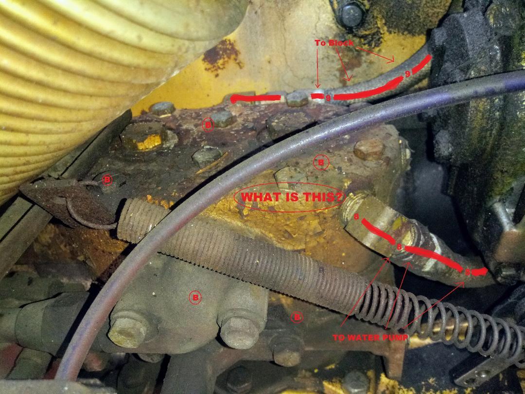

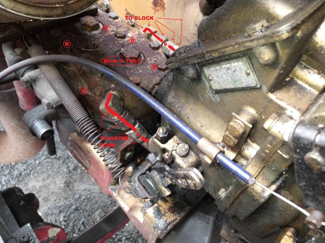

  4. I should have known that. I guess I was blinded by science. The coolant lines to the compressor threw me off a bit but it make sense now that I think about it and know for sure what I'm looking at.

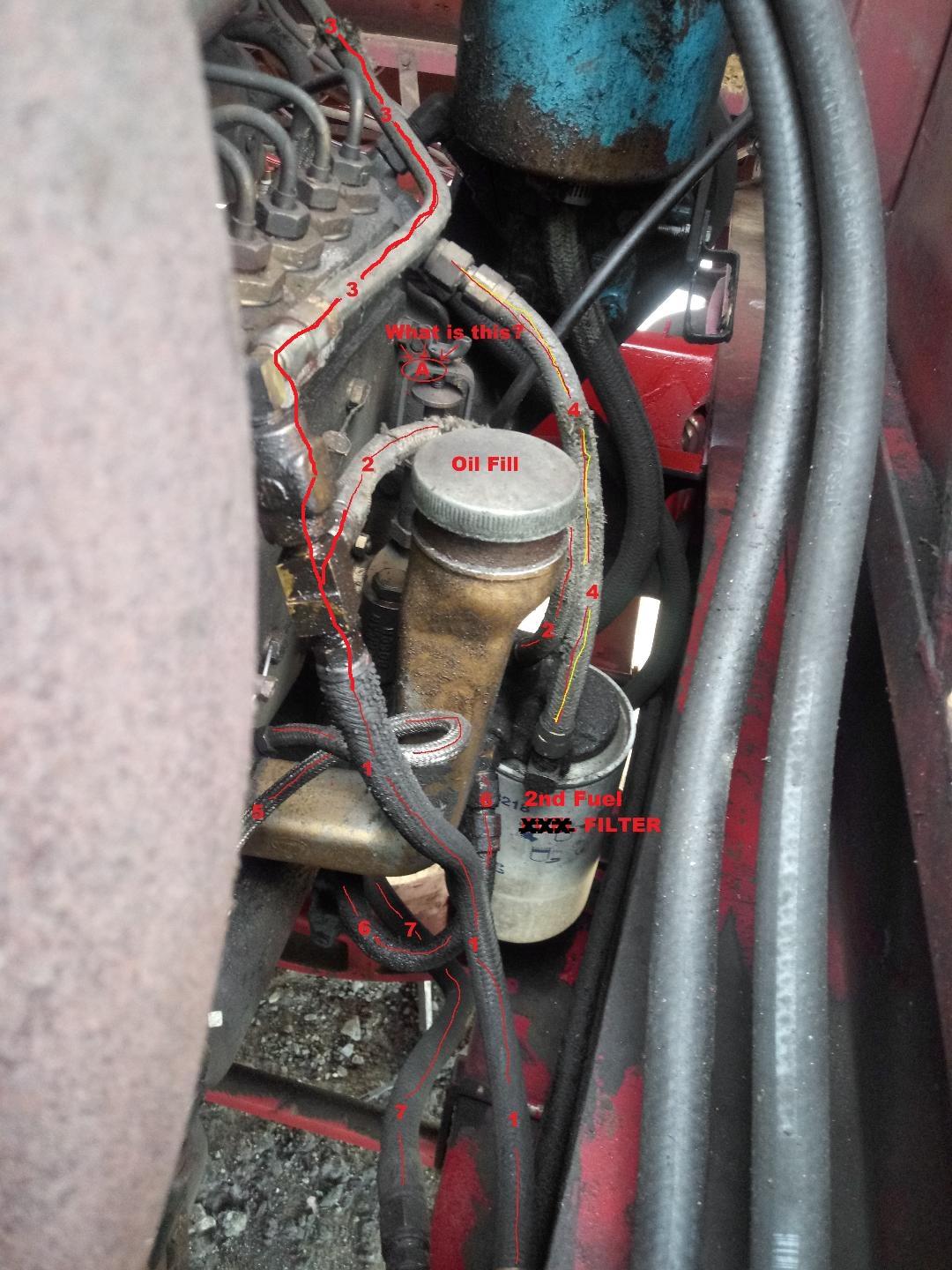

  6. Adding to my confusion. HELP - What is this mark (B) in the attached pictures.

  9. I have a small Skid Steer that had a bad fuel cap that was not venting correctly. As a result the fuel system drew a vacuum and the plastic fuel tank collapsed (puckered) inward on itself. When to tank collapsed the fuel sending until float got stuck in the pucker/squeeze and stopped working. Took a while to figure out WTF. I ran the Skid Steer empty a few times. The fuel gauge always reading 1/2 full. Put fuel in the tank and it only took (5 Gallons) half the amount to fill the 10 gallon tank. WTF?? Finally (dumb ass) took a flash light and looking in the tank. WTF? The Skid Steer tank fix was - I took the old cap and put a tire valve stem in it. I put the cap with the valve on the tank, pressurized the tank and blew it up back in to shape. Got a new cap that was venting correctly and it has been good for the past year or so, knock on wood. When the Skid Steer ran empty I'd squeeze a fuel line primer bulb until I felt resistance. If the engine wouldn't start I'd squeeze some more. When the engine would finally start and it sounded like it was going to stall I'd squeeze some more until the engine ran smooooooth. I'm guessing the "WHAT IS THIS" in my original posted pictures is the same theory. Pump until I feel resistance try to start the engine and then pump some more. I won't ask - How many licks does it take to get to the center of a Tootsie Pop. Because sure as shi_ if anything can go wrong it will be more difficult then expected. NOTHING THE EASY WAY. Will I need to leave a few of the new lines bottom to top loose and have at it and pump away and then tighten loose fitting bottom to top as I see fuel? Or, do I tightened everything up and pump my nuts off until I feel resistance? I might try the fuel cap trick and gently pressurized the tank with a few pounds of air with some new line fittings loose until I see fuel. Then tighten the fittings and pump. Can I pump while the engine is trying to start or while it running? I don't want to damage anything because the budget is getting thin. I assume there is no lift pump on my truck? The first fuel filter on my truck is located next to the fuel tank behind the rear axle. I have never found the easy button. What a nightmare. I have a remote oil filter canister with oil lines running to the engine. Last year on of those lines took a dump. I like my Mack but what were they thinking with the miles of ALL the oil, fuel, power steering and coolant lines?

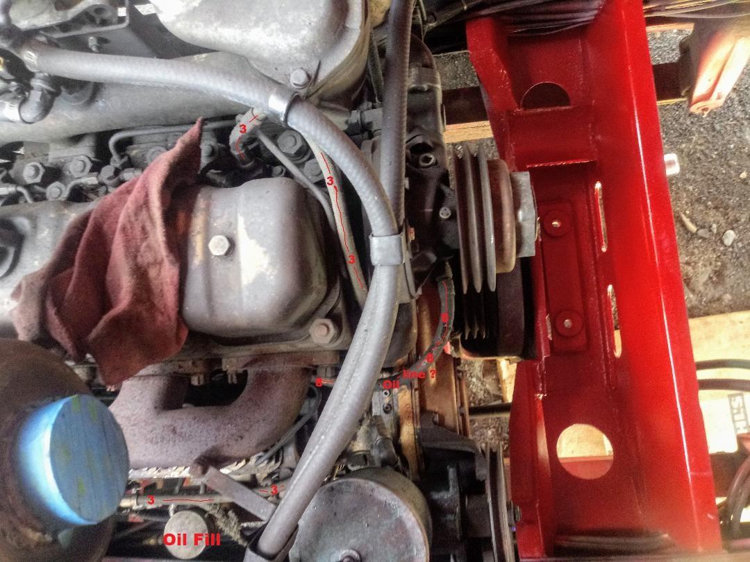

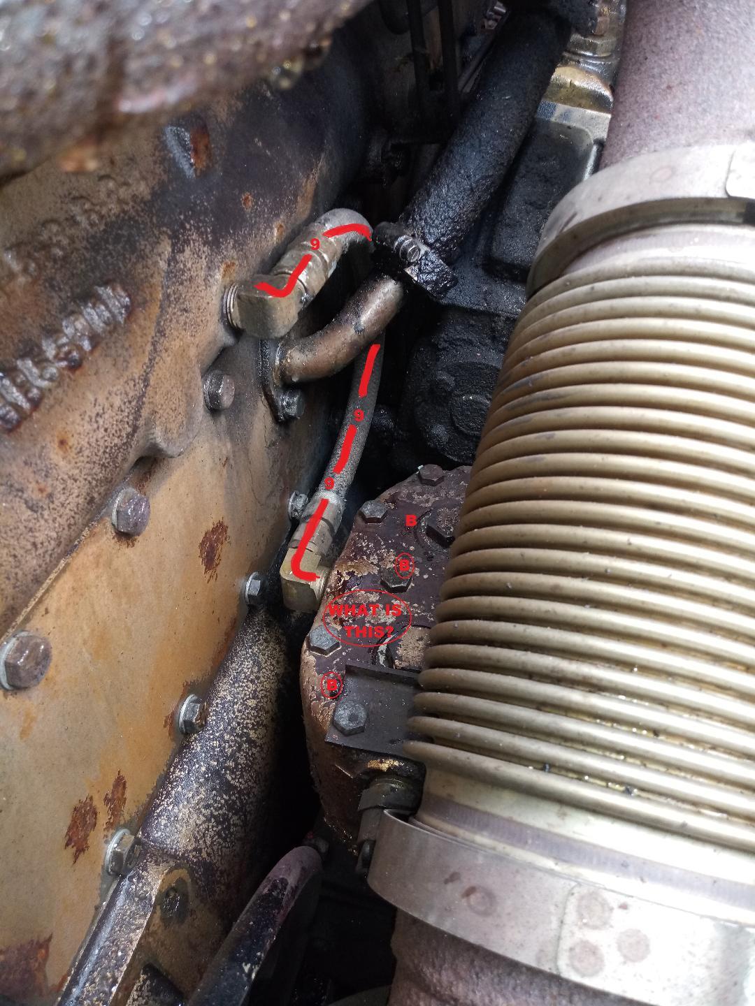

  10. I had to take the radiator out of my CF-600 for repairs. While the truck is apart, I am cleaning up the best I can 48 years’ worth of neglect, dirt and grim. I used degreaser and a pressure washer. There was no avoiding using a pressure washer. In some areas under the truck and in the engine compartment the built-up grease and filth was caked on nearly 3/8" thick. I tried my best to avoid nicking any fuel or oil lines, BUT. The radiator popped the core as the result of a blown heater hose. I suspect the heater hose was original factory installed. The core was living on borrowed time and was weeping slightly (not leaking) before the heater hose blew. Last year the truck blew an oil line that I caught right away before the truck went up in flames or caused any engine damage. These two experiences and a few other minor incidences have convinced me I need to replace all the hoses, belts, fuel and oil lines to avert further disaster. I’ve owned the truck for 2-1/2 years, and it’s been a work in progress. I’ve attached pictures. I need to replace these fuel lines shown. I'm guessing these are low pressure lines. When I remove and replace them will I have to do any type of a procedure (crack open an injector or two or three) to bleed the fuel system of air to start the engine.

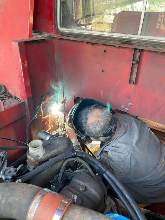

  18. Blew a radiator core in my CF-600. It was enough of a PITA getting the radiator out. While its out doing some rust repair that was hiding behind the radiator. Last weekend was a wrestling match crawling in the dirt pulling myself up from under the truck in front the axle behind the cab. Had to take it easy at work for a few days after to recoup.
