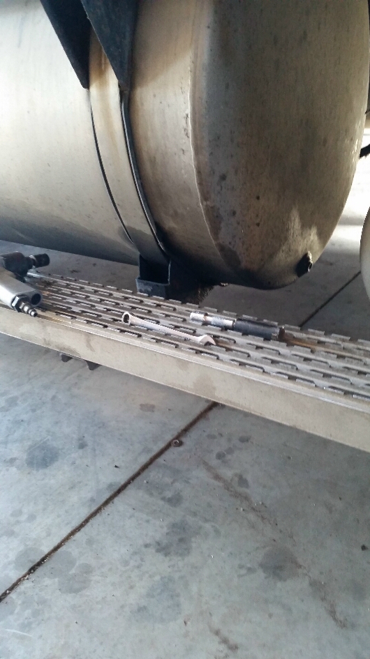

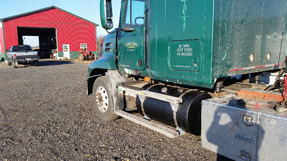

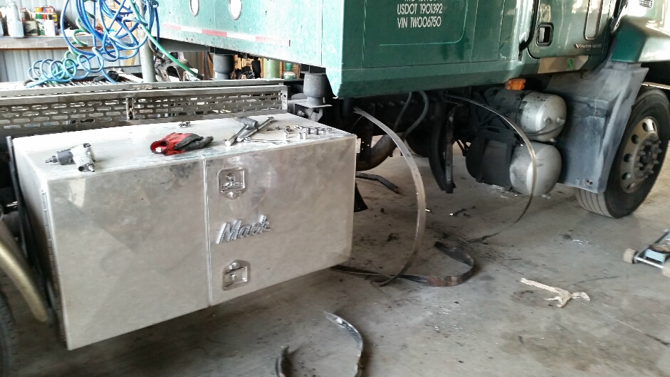

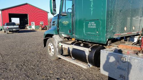

  4. Thought it was going to be an easy week till the pass side fuel tank started to leak from under the strap. didn't see any corrosion. Well the last guy cleaned it up and put some kind of epoxy under the straps. Pulled it all apart had strip welded in then had them rhino lined. All the step brackets were rusted out under the straps. Cut the top ones apart and welded in stainless strip. not so east on the bottom so I sand blasted them an dunked them in por15. Made the front step bracket out of 3/16 aluminum. New rubber blocks up front and coated all the metal. A lot of BS so it doesn't rust apart in a year.

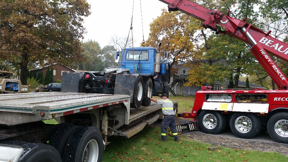

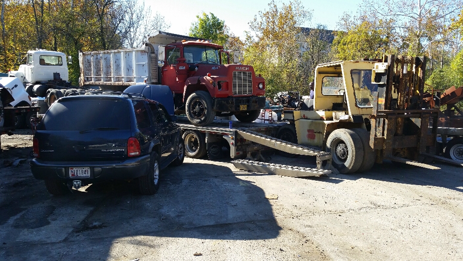

  8. Simple week. How do you load a R model thats out of fuel. Do you go buy fuel NO you go get a wrecker. What ever he wants. loaded these 2 out of AR. They told the buyer that they ran. Well 3 years ago. The white one they tried with old batteries no luck, they came to the conclusion that the flywheel was bent? Yes I'm sure that's the problem. The red one at least started. Used it to pull the white one on then load it. Get to the recever he too puts in to junk batteris and guess what it won't start, so they hook up the Darango, guess what it won't start, so then they hook up the fork lift, that was the ticket. I stoped putting in my 2 cents a while ago. this guy was getting fuel, I wish I got a pick of the other side, he had lawnmowers and junk tied down . , then this guy didn't even have a flag. But I give him a thumbs up for not giving a damn about DOT.
