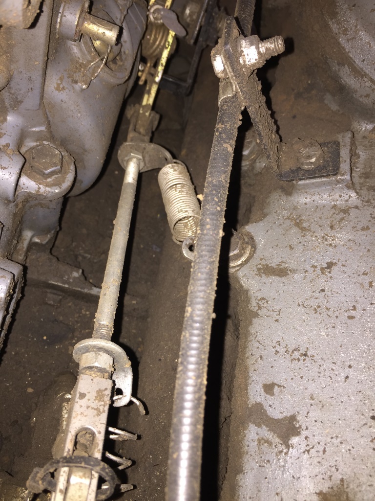

Well for reliability?? Do you trust stopping every time you hit the air brakes? Same air and cylinder concept as brakes. It just seems a little mushy to me and lags compared to a cable. No real snap... Think there is a air restrictor to slow pressure build-up. If you have a diesel pick-up truck built in the last 10 years your pedal is not directly connected to the pump ether. I went to work on my kids car and the throttle is actuated with a motor and not connected to the pedal at all. There's a switch on the dash for "sport" mode that doubles the movement in the throttle motor.
I believe the air throttle came out with the inline pump around 1990 or so. I don't think many guys liked it but it was suppose to saved a lot of broken drivetrain parts. Even with it the 94 CL I got for parts had clutch, trans (twice), drive shaft and front diff replaced by 400K miles. The E9 is still in great condition though. An E9 is a one driver engine not just give it to the new kid to learn on.... unless you want big broken parts.
