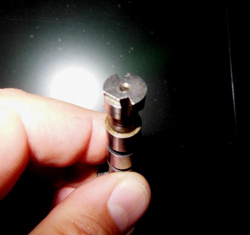

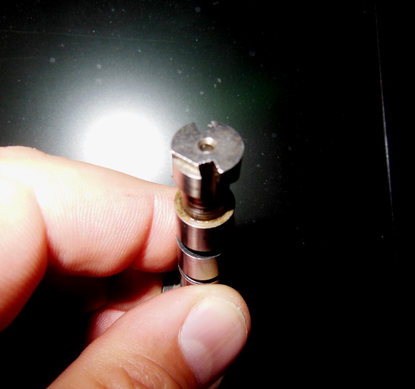

I have a V pump on the 866 and have old plungers. On that pump there is a retard notch on the plungers for easer starting. If the rack is in full fuel it goes to this notch and retards the timing. Is it the same on your V pump or different plungers for pulling? Don't know if the notch was used on the E9. I will see if there is a notch on my inline but have not heard anyone talk about it. I have a few old plungers to take a photo if needed. I have never needed to touch the throttle to start any of my V8's. They just fire up almost instantly.

What I have to do is take out the delivery valve and do the static timing to get a baseline. I know how to do that and until now was the only way I set timing. Just bought a Kent-Moore J-33300 timing tool (clamp on) on Ebay for $200, about as cheap as I have found. I will then see how far off it reads and just adjust the timing difference in going forward. That way I can adjust timing without the mess of pulling pump valve apart every time. Thanks Guys for the help.
Isn't that the old air and tube in a jar way of doing it? Can do it with air or fuel pumping in to supply port. It's about 5 bucks in parts or an I not understanding? Is that the accurate way of doing it? From Glenn, how far off are the clamp on lights? I am looking for accuracy here. Sorry just have questions on what to get.
