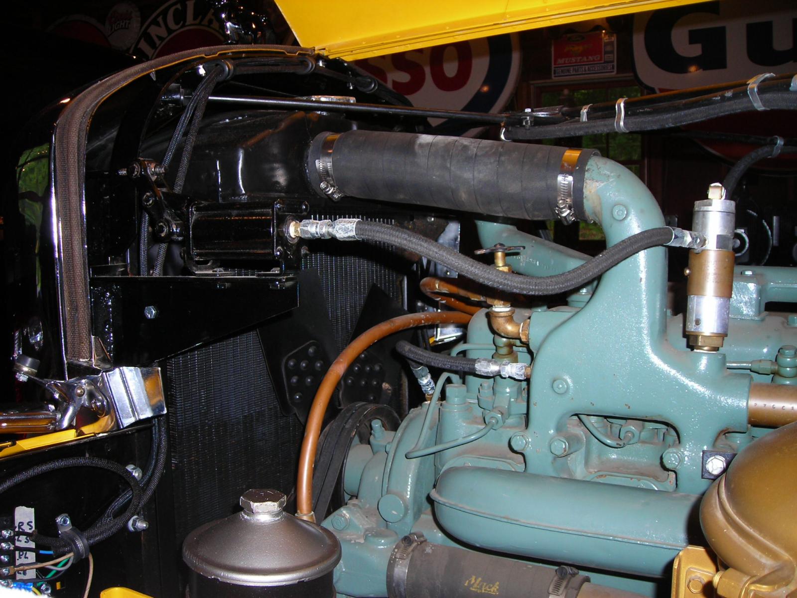

  2. Had the shutters working fine until last week when they stopped closing. The air pressure seems strong to the shutterstat but from there to the shutter piston it seems weak. When I use shop air (120#) direct to the piston the shutters close and open. I removed the cap from the shutterstat and there is a screen and felt washer/filter. They both appear to be OK with no clogging. Is the shutterstat repairable? If not are replacements available. Thanks, Harry
